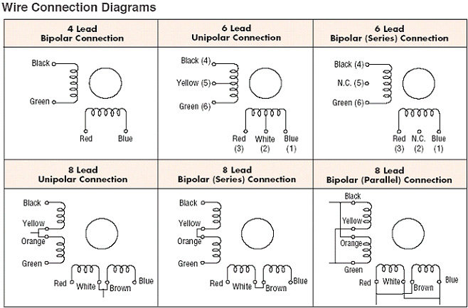

I am using this picture, as it shows the diagram of a stepper motor with 2 pairs of coils, but is intended for another message! At the poles of the coils you see colors named, which allow to identify the right cables. Lets take the diagram in the second row lo the left. here you see the coils connected in series, so the the stepper motor controller we just connect "black" and "green" ones and the "red" and "blue" ones to the motor and connect the left cables as shown in the graph.
To connect the coils in parallel we would connect the "black" and the "Orange" ones to one jack of the controller, the "yellow" and "green" one to the next, "red" and "brown" and "white" and brown" finally to the 4th connector.
What is the difference? Well. connecting the in series gives you a bit more torque, connecting in parallel makes the signals more stable and in consequence the stepper motor will operate a bit smoother and in consequence be able to be operated a bit faster. You find this graph or the relation of the colored cables to the coils in the datasheet of your stepper motor. If you do not find a datasheet you might guess the right pairing by test and failure. Should you fail to connect them in a way that the pairing of the coils is as shown in the picture you will notice a problem when trying to operate the stepper motor. One additional piece of information that might help you to solve problems you might face when trying to operate your stepper motor. That is definitely one of the purposes of this tutorial!

      This picture nicely explains what kind of cabling you find in stepper motors, focusing exclusively on bipolar motors. let me advice you, that you always will find also unipolar stepper motors in applications like printers. Those cannot be used and are not the topic neither of this "cookbook" within the tutorial, nor will I deal with them in my tutorial! You can identify the cables, if you do not have a datasheet of the motor by measuring the resistance between the cables. If it is infinite, than those 2 cables are not connected, if you can read a resistance value, than there are 2 choices depending if you have 4 or 8 cables coming out of the motor.
      In a bipolar stepper motor with 4 cables coming out of it it is simple, you can identify "phase A" and "phase B" circuits and so connect it properly, if you have 8 cables coming out of it, it is still simple, but it offers you one additional choice, this is good! :)
      The 3rd picture horizontally  shows this option and the 2 last configuration pictures in the graph explain what I am addressing. Connecting the the "middle cables" puts 2 coils in series like in the 6th picture and in parallel in the last picture. In series you can gain more speed, in the parallel option you get more stability. I choose the parallel option to connect the stepper motor in the video will let you watch next.
