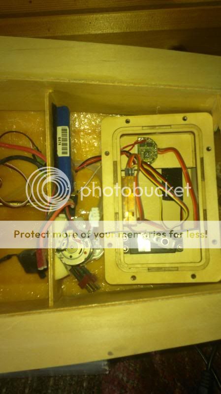

Waterproof radio box containg the esc for the cooling pump, receiver and rudder servo

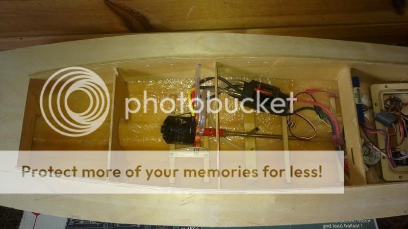

Inside of the hull.... the esc needs a mounting plate made up and the wiring tidying up

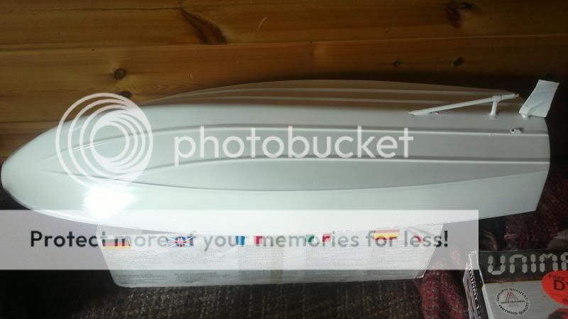

Outside of the hull rubbed down and painted.  Needs final wet sanding with 1000 grit and a coat of laquer.  I was going to go with the blue up to the waterline but couldn't get the waterline to look right so decided to go for an all white hull.  Better to have a decent looking single colour hull than a wonky waterline

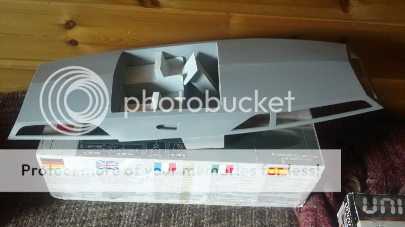

cabins built lightly sanded and primed ready for final filling sanding then a top coat

What submarine is/was in the box underneath?
Regards, Jan.
Boaters are nice people
Re: Build Log - Precedent Huntsman.. What Have I done?
« Reply #29 on: June 10, 2013, 04:23:21 pm »
Robbe seawolf, the build log is here
