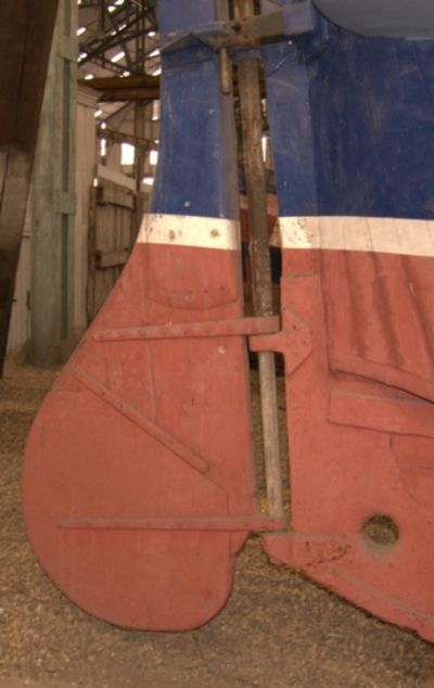

What I find interesting about the rudders on these old boats are that unlike newer displacement lifeboats, where the rudder slides up and down while the shaft remains fixed, on these boats the shaft is fixed to the rudder and comes up with it.
Andrew
  • Posts: 1,928
Re: MY NEW PROJECT....Another lifeboat or two!
« Reply #460 on: April 25, 2013, 09:07:55 pm »
yes, on the two I am building, the rudder and shaft are totally as one unit.......they don't move at all virtically.............no uphauling ropes, and it makes it so much easier to have the brackets holding the rudder fixed to the rudder shaft and any steering comes from the rudder head stock.
« Reply #461 on: April 25, 2013, 10:46:52 pm »
If you look at the photos you put up of the Maude Pickup, the photo of the boat on the beach with the crew posing alongside (second from bottom), in that photo the rudder has been raised, so it was possible.
The plans don't appear to show any means of hauling up the rudder though. Curious.

oh yes, she had slight movement in the rudder, and that can be seen of her sitting on the old slip before fleetwood got the new slipway.......the movement was about  12 - 18 " but wasn't full uphaul like on her later replacement. i have a photo of her starboard quarter at sea, just afterlaunch, but can't find it at the moment, which shows a simple pulley type roller with a rope to the rudder and looks like tied off to a cleat.
the rudder, made from solid timber probably weighed several hundredweight and so sat where she fell, unless hauled up that 12"or so by brute force.
http://www.flickr.com/photos/robertbainesphotographic/3159805276/sizes/l/in/photostream/
having said that, having looked closer ar the shot above, there does seem to be a roller set onto the stern post just below where the belting ends at the stern, port side ( why it's not shown on starboard side profile plans,)..........with a rope feeding through it, which would pose a problem to the frames i silver soldered, should i want to uphaul my rudders............but ................can't be a****** changing it now, so will claim modellers  licence on that one, lol will put the roller and ropes on though for detailing effect

That's a nice photo... BASP has pretty much the same movement, with an up haul but no downhaul. It would have taken a good few men to lift it, but it was on a block which made it a little easier.
If you like I could put up a couple of photos of BASP's arrangement, it was probably a similar system. The model doesn't have to work.

Here it is, it's a bit dusty in the photo but it's just a wheel, in a frame, bolted to the sternpost, leading to a single eye on the portside of the rudder. Unfortunately all the haul up gear on the endbox has been long since removed.
Andrew
  • Posts: 1,928
« Reply #466 on: April 26, 2013, 11:15:36 am »
cheers andrew........that's good..........got as fitting for that that will do.
I think the uphall would have been a similar one, but can't find the glass plate photo of her starboard side yet..........in the depths of my workshop and at the moment........it's more untidy than usual,  {:-{ {:-{ {:-{
Looking at that set up though, she looks as though the rudder stock was the usual square bar type as on later boats, where as the two I'm building, are ( I am alsmost sure, ) round bar stock where the brackets fitted to the rudder are welded to the stock..............but having said that, I can't work out, by using the latter method of round bar where the uphaul motion comes from.................unless the brackets weren't welded, but have a tubular insert at the end of the bracker which slips over the round stock bar?????

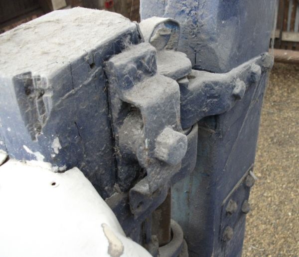

On BASP, the top half of the rudder post from the upper hull bracket to the middle bracket is square, and below it's round. There's a round bearing with a square hole in the top hull bracket, and the other hull brackets have a round hole.
Andrew
« Reply #468 on: April 26, 2013, 12:07:50 pm »
Here's BASP:
the round section of the rudder post is less corroded than the square, so you can see where the two bits meet. The bracket on the rudder marks the end of the square section, while the bracket meeting it on the hull is on the round section. The fairing on the bottom is just a socket that the round section drops into.
All the brackets on the rudder are square, so that the post turns with the rudder and is held in place by the bearing at the top and the socket at the bottom.
Andrew

you see..........on the BASP, the steering was done through that linkage at the top of the rudder.....you can see it high up starboard side......where a rod comes through the cast iron square tunnel and links to the bar facing vertical fixed to the rudder itself........
Neither the motor sailor or the sailing boat have that arrangement, they are steered by (for want of a better word) the yolk that fits on top of the wooden rudder, and pulled via a series of pullies to the steering rod via rollers to the wheel.
very different arrangememnt to Basp.
neil.
