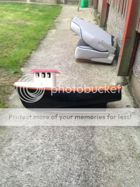

Hi there thanks for the link I should of stated its the mk2 I'm after here's a photo the hull I have
And this is a photo of a smaller hullmatic mk2 24/26ft
Hopefully this links work
