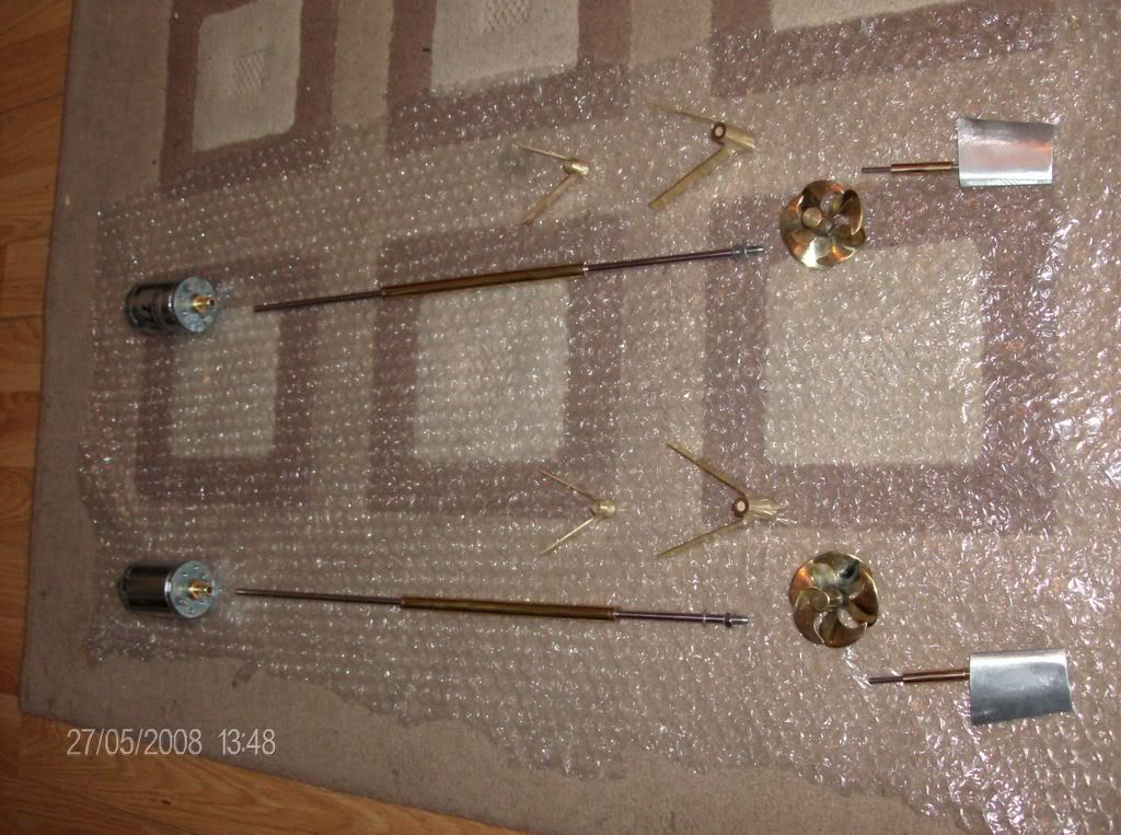

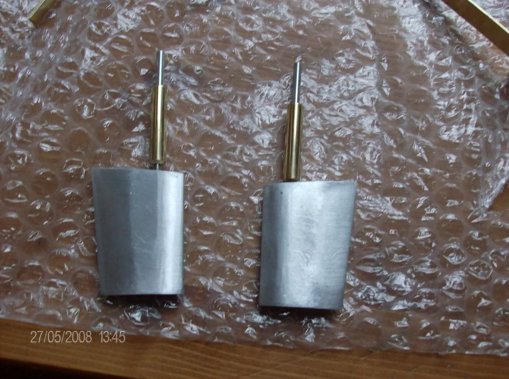

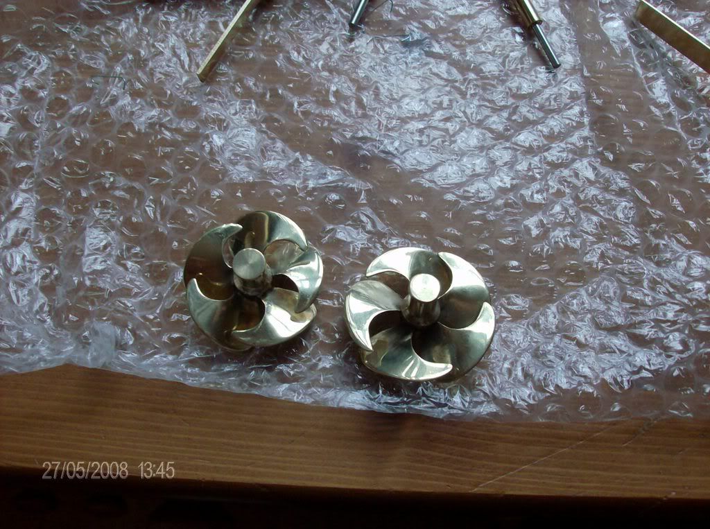

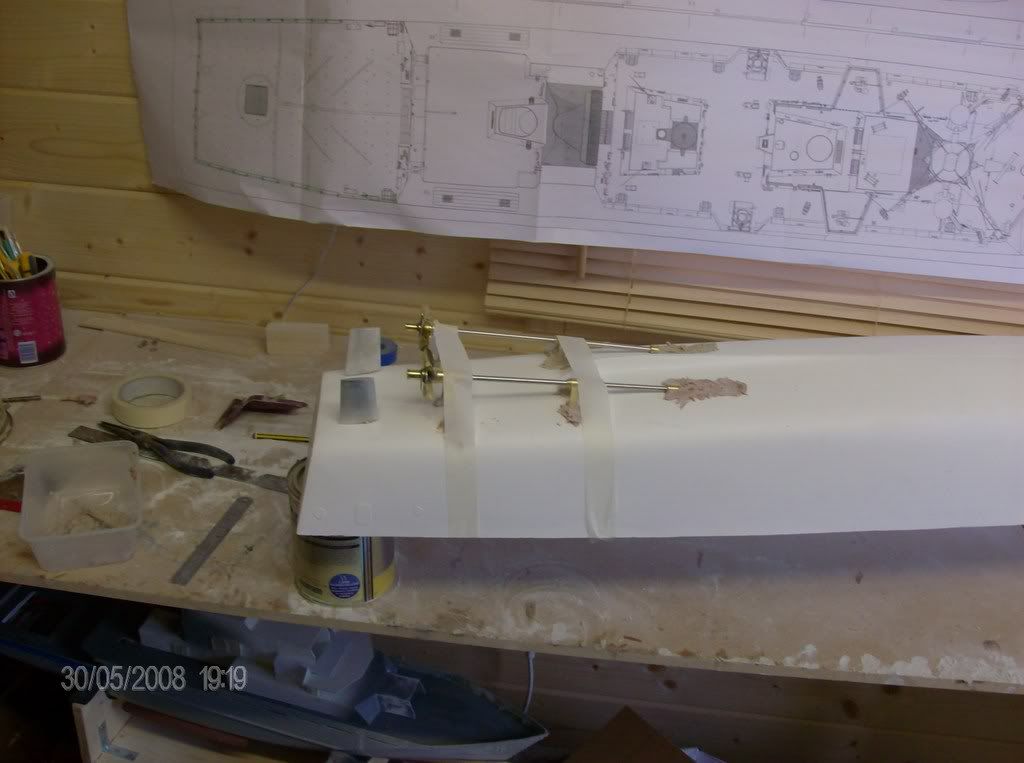

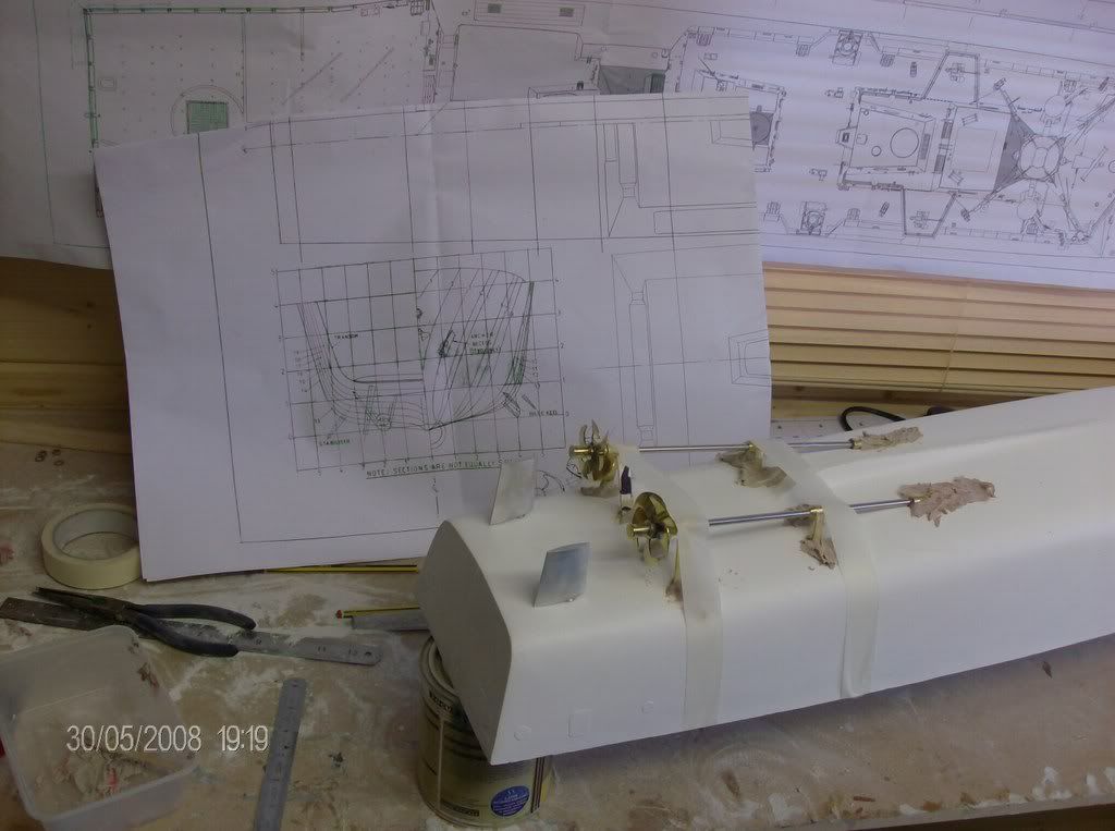

Here is the setup I used

Thanks for the info Stu did you use a flexible coupling or does the prop shaft fit directly on the end of the motor ?.
I presume they are from G Sitek.

Yes they are sitek shafts I used a universal coupling but removed the plastic section and fitted a piece of gas hose.

Sadly I can't remember what size the props are so I can not answer that one for you I'm afraid. I normally go off the diameter of the motor should be equal to or greater than the prop size.
Just Checked mine, 45 mm
