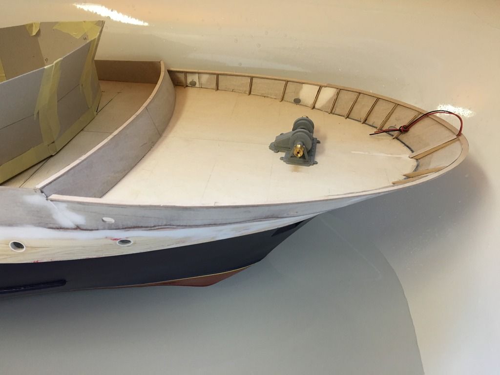

I wasn't happy with the whole assembly. So I cut it in half and reglued it together 4mm to the left and 8mm lower. Now I think it looks much better.
First layer of dark iron color.
2 parts made of wood ...
Finished parts
Final layer of silver color.
Some details added ... wont do more because they are not really visible ...
Finished net winch on deck ...
Danielle

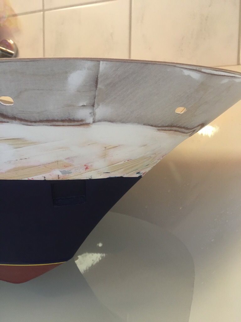

Today the second launch of the Nuova Loredana in the bathtub. I had to check the weight and the stability in the water. The ship is a little bit heavy at the bow ... I will have to add 2kg of iron shots in the back part. together with 2pcs of 12V batteries (@990g each) the ship should lay exactly level in the water. Only a little bit (4mm)  over the waterline. I can live with that. Its a beauty in water and it will be hard to give her away (selling it).
Building the boat as heavy as possible was never a problem. She stays in water as stable as the Cornelia Marie! Even with the gantry and other weights at the top she is not top heavy. Now I can go forward and go on with the built!!!
Danielle
