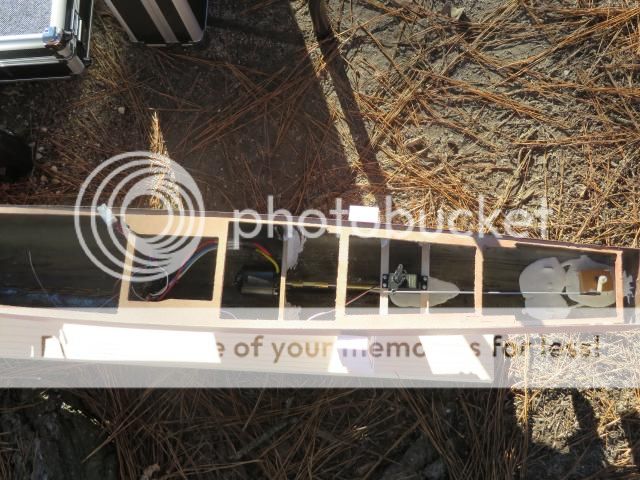

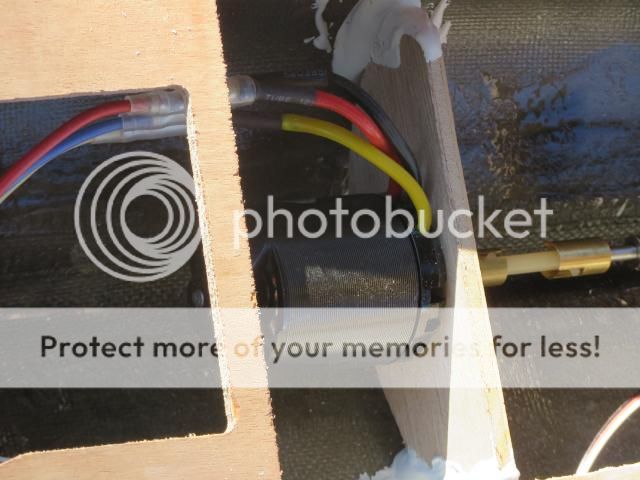

I took the plunge.  I put a brushless motor in my Knox and it works great.  Here is what I used:
motor:  42mm diameter 50 mm long 500 KV (under $30 from Hobby King)
Speed Control:  Mtroniks Hydramax 30 brushless (around $85)
Propeller:  Rivabo 5 blade 50 mm diameter  ($25)
Battery:  6 V 4 Ah gell cell
Note:  I originally used a 12V 2.5 Ah battery and the hull planed at full speed, the 6 V battery gave good top speed and more capacity.
Trial run
setup
motor
Charles
