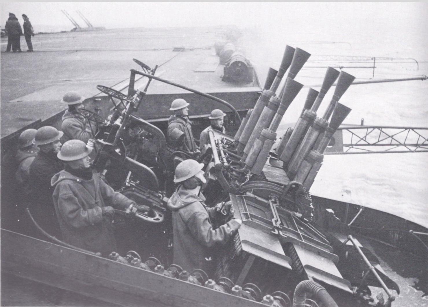

« Reply #119 on: April 29, 2015, 07:48:02 pm »
Photo I've just seen of Lusty in 1941 of her pom-poms
Davie Tait,
Scotland
  • Posts: 6,471
Re: HMS Illustrious 87
« Reply #120 on: April 29, 2015, 11:47:26 pm »
Those mounts never fail to impress me!

« Reply #121 on: April 30, 2015, 11:58:50 pm »
Thanks Davie,
Here are mine, one I made last year when I built the island, which I am still working on.  The No 2 pom pom has to be set down into the front of the island and had a walkway and magazine lockers stored all around this unit.
The link to view the first part of my build is here as these photos have not been published on here.
https://www.flickr.com/photos/92998762@N02/sets/72157640833731444/
Enjoy Davie.  :-))
