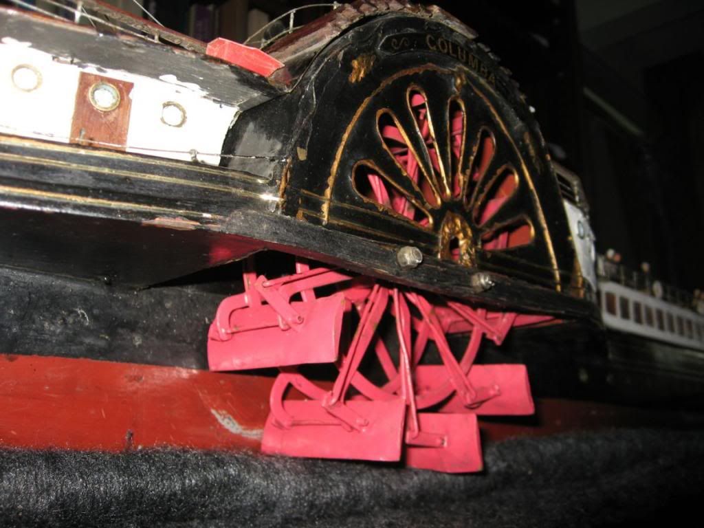

Big debate about whether you actually need the feathering mechanism on a model. I think it very much depends on how likely your paddle boxes are to choke. If there are plenty of vents to get the water out then you don't need them to feather.
Here are a set of homemade, handmade non-feathering paddle wheels.
