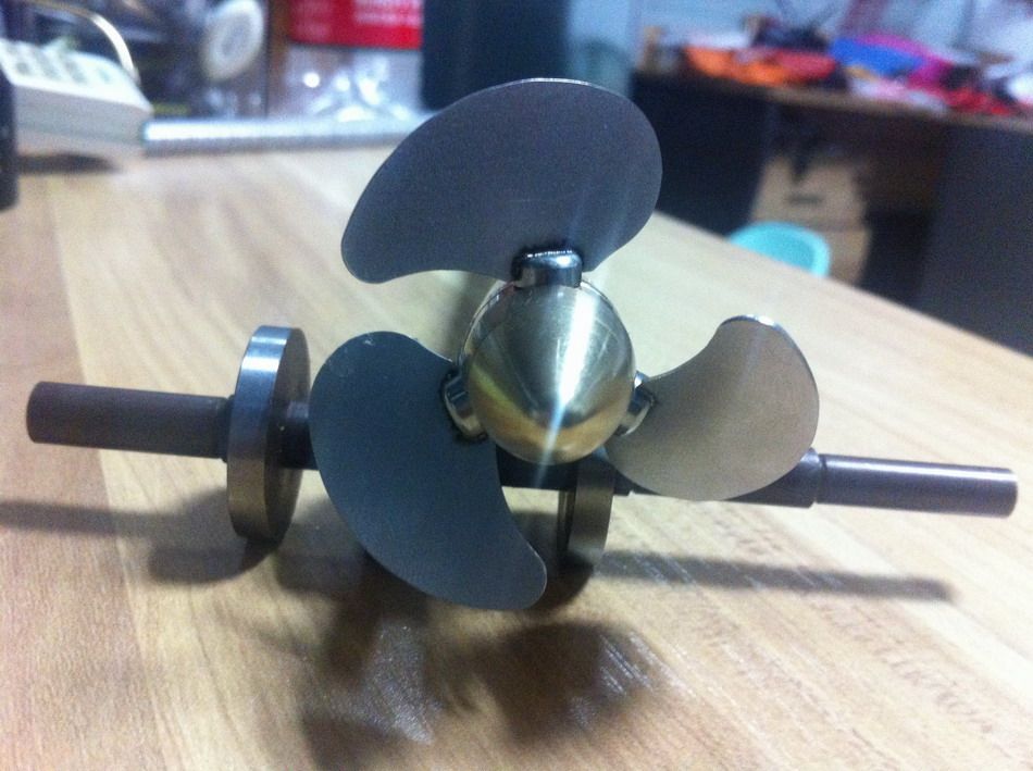

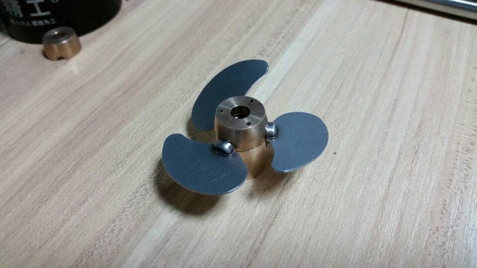

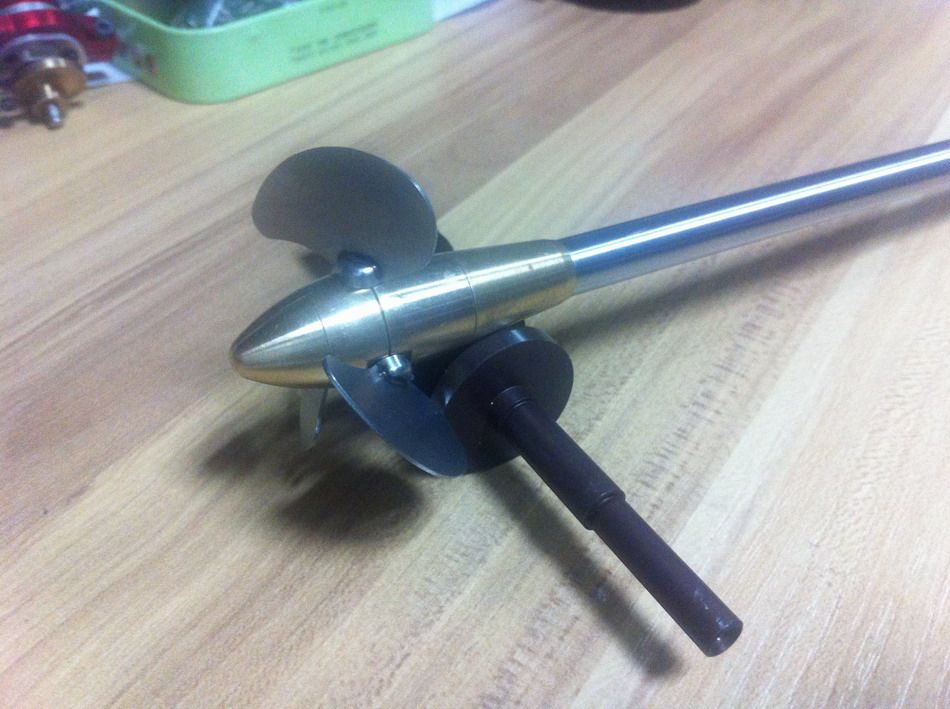

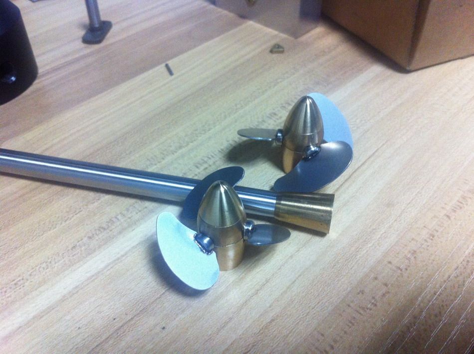

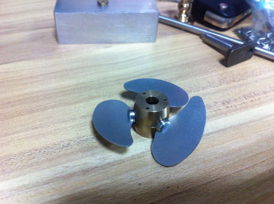

From the beginning of this year, four out of the design, after six months of production, is expected to start selling in October, the price between 100-150 dollars.
It is machined from copper and stainless steel materials made ​​with four sealed bearings. Blades by laser welding. Blade structure is quite complex. Input shaft of the steering lever controls have modified pitch.
Jin

Lovely job! What sizes will be produced?

Looks good ,what stops the blades from turning on there axis ,when going fron forward to astern what will happen to the blades will thy turn and make astern abit more effective . Thy look really good .

The motor will run one direction
Ahead and astern will be controlled by propellor pitch
At least it did on two RN Hydrographic Vessels with Stone KaMeWa
controllable pitch props.

mmmm ..........I have previously worked on VPP hydraulic control systems by "Lipps" from the Netherlands as installed on the Australian built Iron Duke & Iron Monarch .....
I understand "Lipps" have since been acquired by Wartsilla
The hydraulic control system was extremely reliable & only required mechanical intervention each 2 yearly period for survey by Lloyds ....however blade geometry from memory was semi symmetric and totally different to the unit displayed here by Jin.................. Derek

The Max Prop fitted to the yacht I sail on has a vernier  scale to manually adjust the pitch has gears inside !forward pitch one way !astern pitch other way ,sailing blades feathered to reduce drag . All done by the shaft rotation .
I do not know how to post a link on the iPad  . The prop is a Max Prop VP 3 blade .
The gearing and the vernier set the pitch. The reason for my observation was I could not see how the blades would set at the required place .
Having said all that it looks a bit good .
