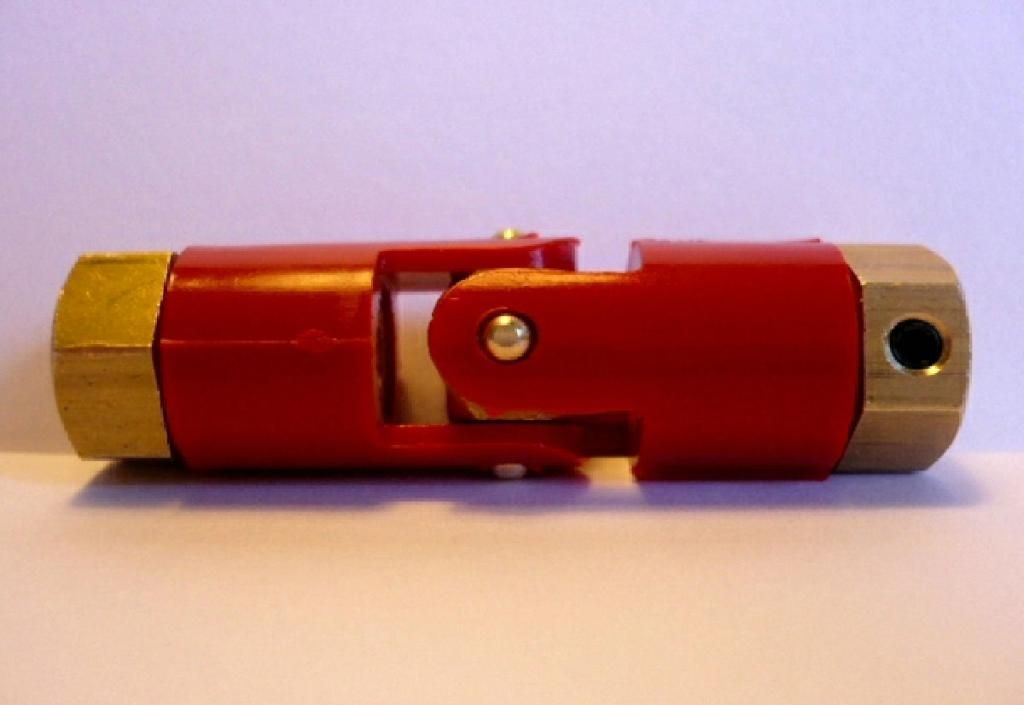

 nycexl coupling = deans own product to join motor to prop shaft although the most  common product is the Huco coupler.

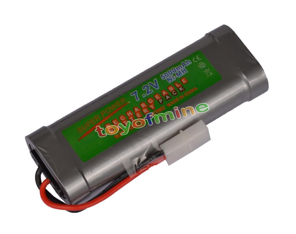

 2000 ah battery nimh = 2 amp / hour Nickel-Metal Hydride commonly called a race pack
huco coupler

Note that the coupling ends need to match the prop shaft and motor spindle diameters. Also they come with single and double joints. The double joints are more forgiving of slight motor/prop shaft misalignment.
