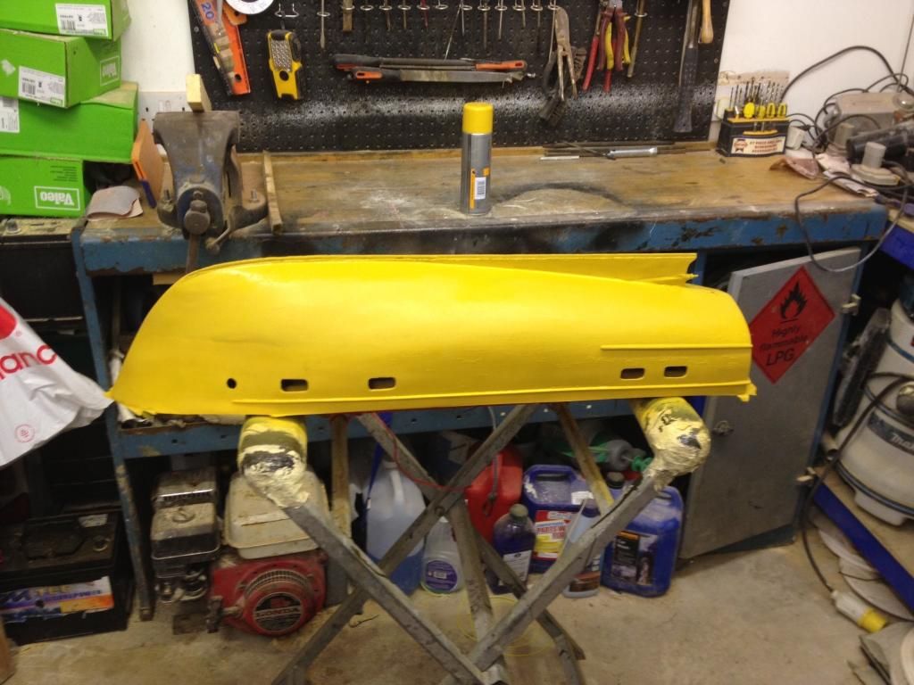

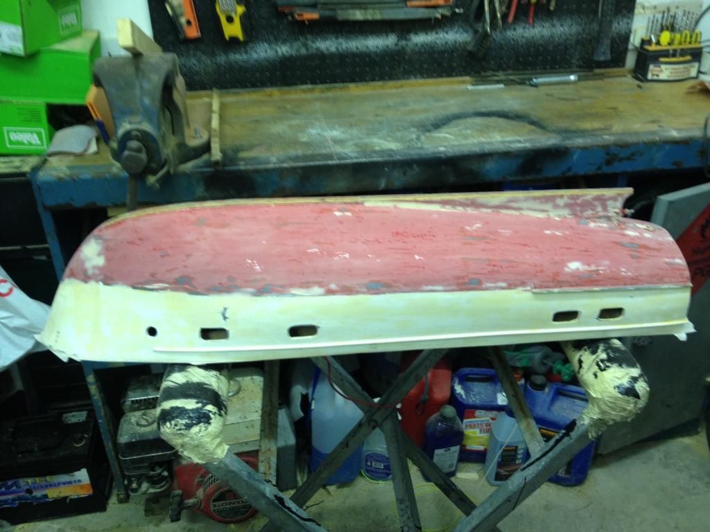

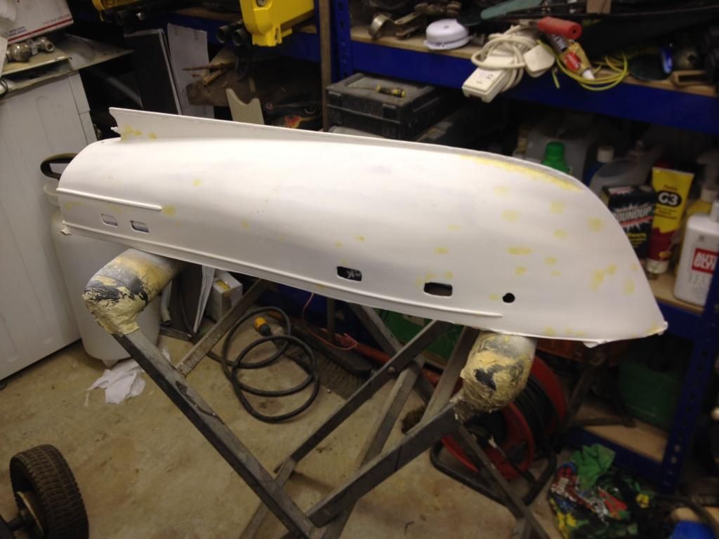

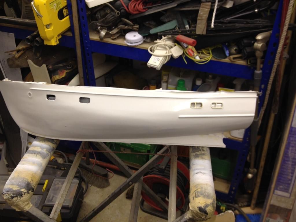

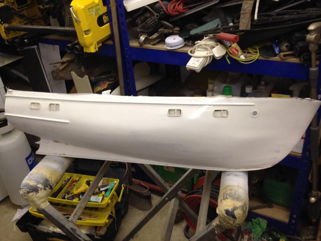

Finally got photos to upload using photobucket thanks again to everyone who helped me ,I will keep posting as renovation proceeds

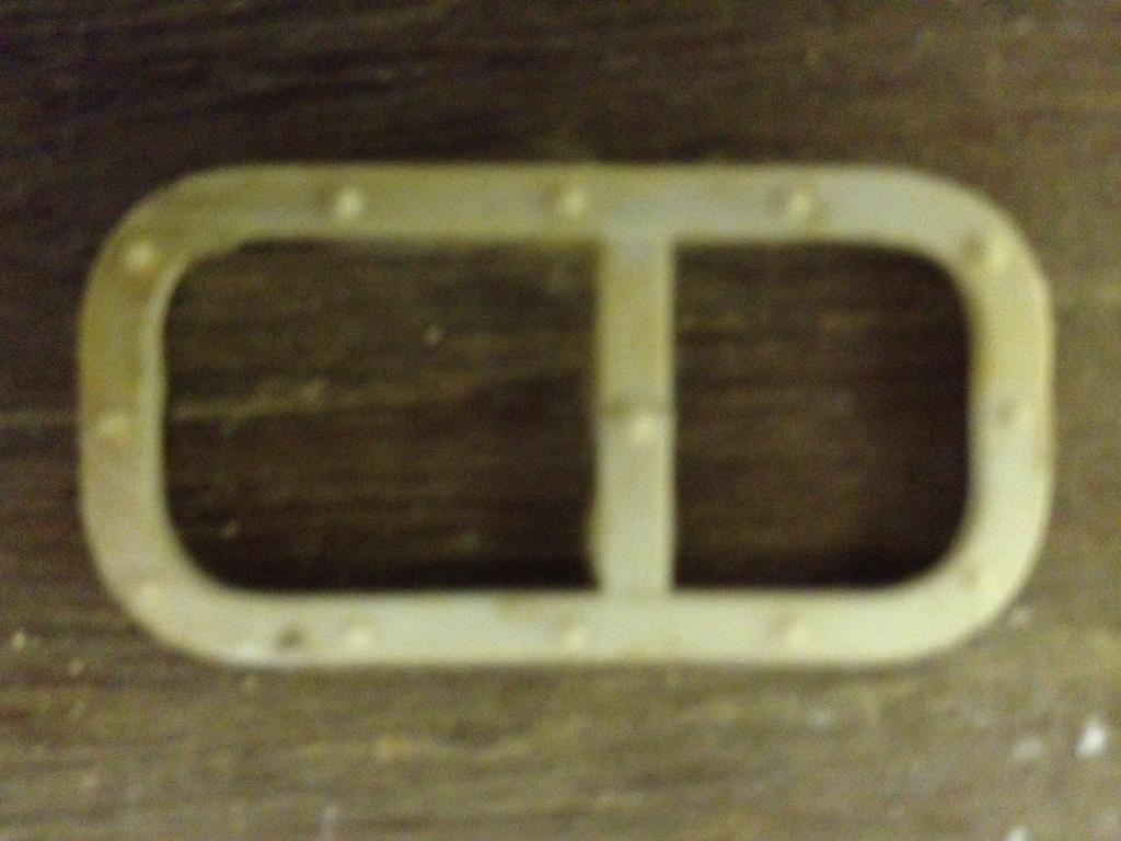

Hi I had a few problems regarding paint . I tried painting over the old enamel and varnish with cellulose primer which reacted . The local paint shop advised sanding and leaving it overnight and painting with enamel. This seams to have worked! The windows have been made by shapeways and should be shipped this week. As soon as they are made I can carry on painting then fit a brass keel protector I have made.
