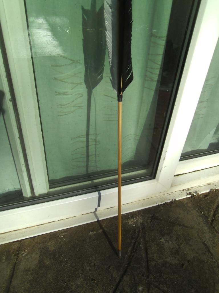

medieval try
feathers glued on

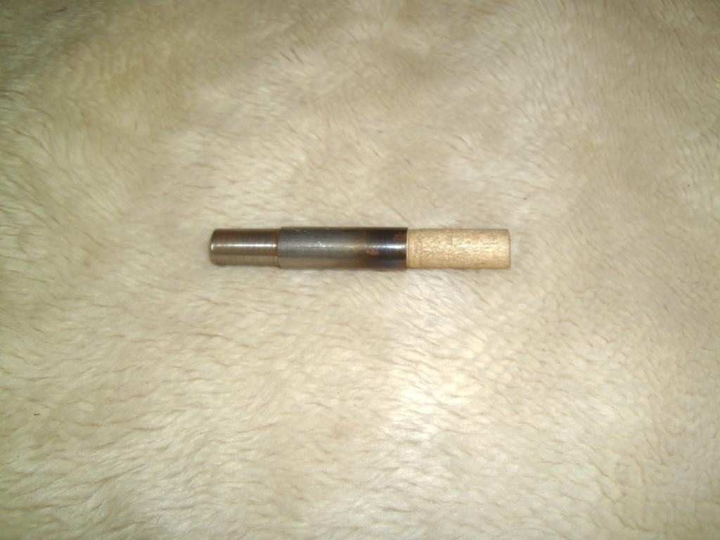

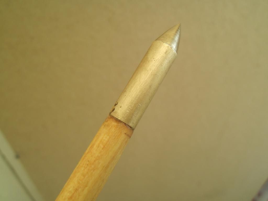

tips drilled ( see tools ) and glued on

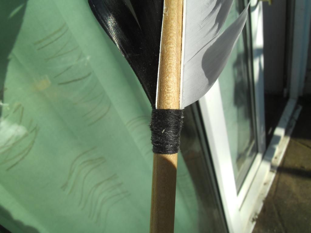

edges bound

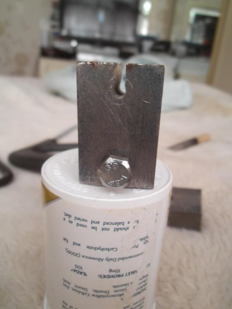

tool used to put on arrow tip basically shaves off enough wood with friction to make tip fit

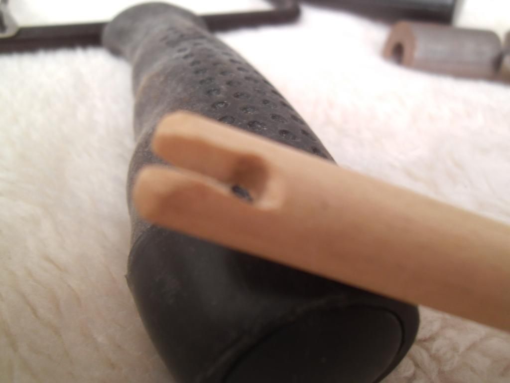

tool for making knock for pull string
what you should end up with
