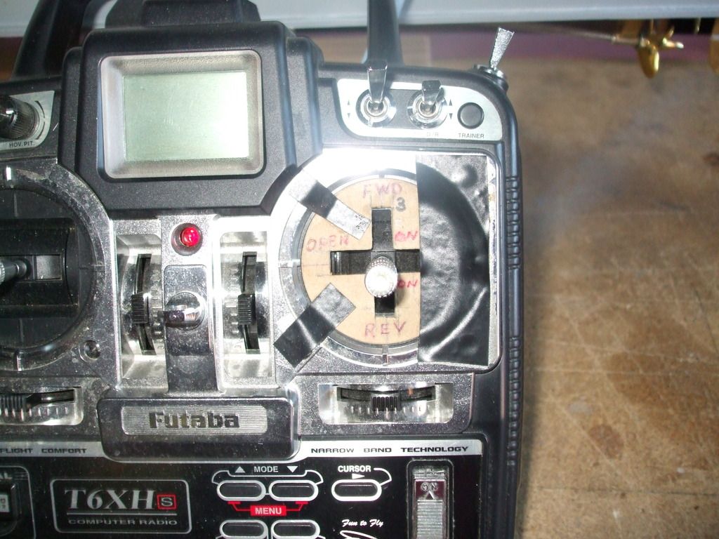

« Reply #5 on: May 03, 2015, 07:08:26 am »
G/day Alex,
Make a cardboard or plastic disc as per photo and make slot to reduce forward throttle and reverse if required.
Graham

« Reply #6 on: May 03, 2015, 07:14:05 am »
G/day Alex,
Graham
Good idea, works for everyone, on all boats :-)) :-))

« Reply #7 on: May 03, 2015, 07:40:21 am »
it has a pistol grip controller guys!!!
And cardboard discs with a 5 year old!!!! LOL is there an ultra strong cardboard i am not aware of that a 5 year old wont destroy!!! Good idea for me though. Plastic disc is a better option for a standard radio.
