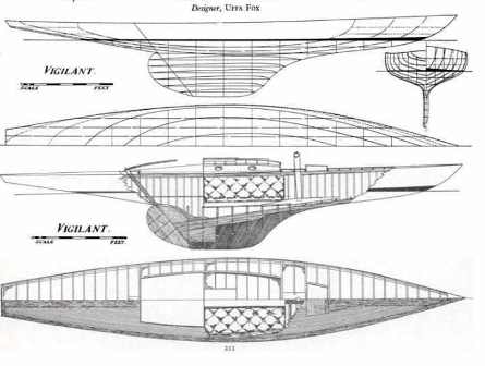

http://www.jch-online.org/photos/Vigilant.jpg
Might be the sort of thing?  If the fin was stretched down an extra 50%, at 1M LOA (give or take a bit) should perform OK carrying something about the size of an IOM C rig.  I found it doing a search for Uffa Fox yacht drawings on the grounds that he knew about such things.

« Reply #13 on: June 08, 2015, 10:15:08 am »
Thanks to all. I have now bought the 8 mtr yacht in the link from knoby, so, extra thanks to him. And it was only a 25min drive away. At 1mtr in length it's a tad bigger than I thought I wanted but actually it's just about right and fits in better with advice from malcolmf. Well done all, thanks, J40
