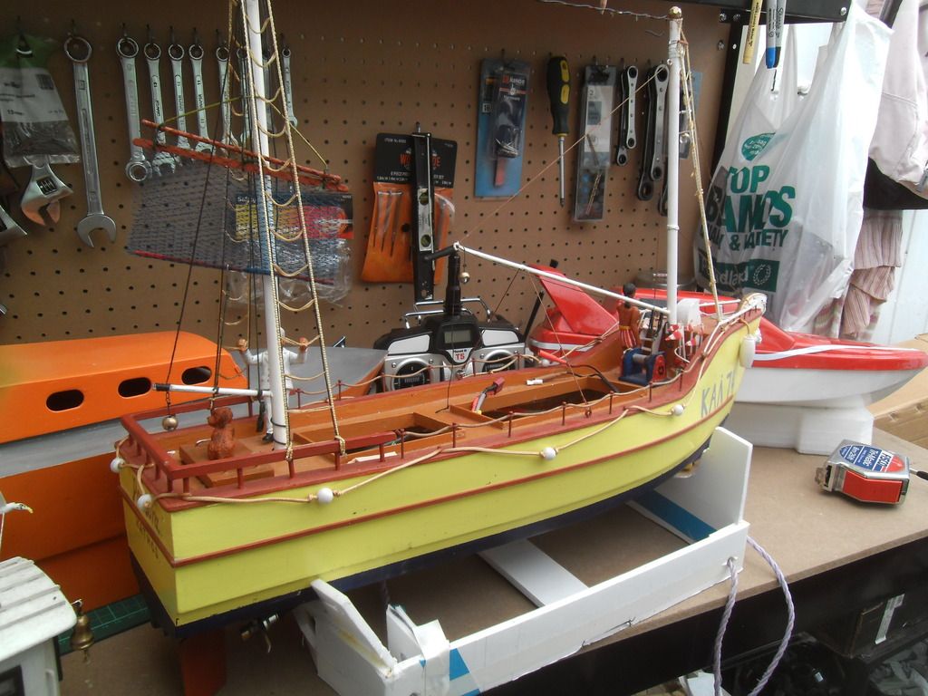

Hi
So bought off ebay on a bit of a whim for my first ever boat
sailed it a few times down local club, new job and unable to sail it for a month
so a month gone by its sat doing not a lot
charged up battery and took it out and its stuck on full throttle.
as it is now esc is out and a new one on order
RC Boats is all new to me remember but this is what I can gather
firstly length 26 inches
height to top of mast 19 inches

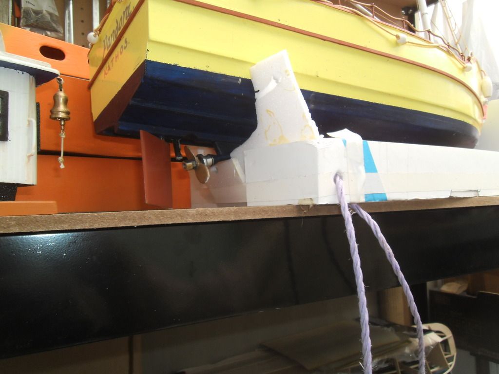

brushed motor   with some sort of cooling tubes on it and pumps out water at side and scoops in from underside
no markings on motor so I cant tell what it is
esc 30 amp but no markings
batteries are 6v gel cell and are linked to give 12v
prop is around 10 inches and prop itself is around 4cm
radio gear is 40mhz
charging with imax b6 balance charger and batteries reading fine
when I go to sail boat instantly rudder starts to twitch and then goes to full power/throttle, I have a new esc on order
boat I bought because I liked the look, naïve maybe but I still like its look and would love to get it back on the water and see how it sails
ps batteries are masticed or sealed in and unable to remove, deck also from what I can gather is sealed down

The motor is an unknown quantity but certainly should not require water-cooling, so remove it and replace it with one which will turn a decent-sized prop at the correct speed for the voltage and the model, and run cool e.g. a Mabuchi 555. Fit a proper flexible coupling between the motor and the shaft. Throw away the horrible DIY prop and use a 3-blade 50mm plastic scale prop. Buy yourself an MTroniks 10A speed controller; this has a switch, will operate equally forward and reverse, and has battery eliminator so you don't need a separate receiver battery. At the same time replace the wiring and connectors to the batteries using 16AWG silicon-covered cable and proper spade connectors. I estimate that this will cost around £40, of which the ESC would be far the most expensive part (currently £20 from Howes). Here is a wiring diagram which shows the full installation apart from the rudder servo; this simply plugs into the receiver with no other electrical connections.

BTW Don't forget to cap off the water inlet behind the prop or your beautiful new installation will disappear below the waves very quickly!
