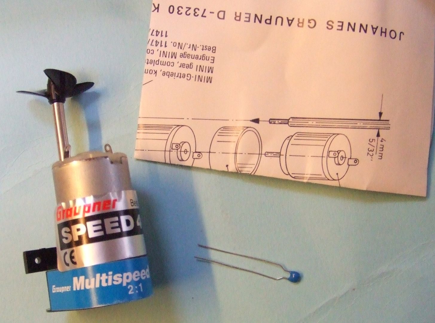

I have a George Turner small fishing boat with the little multispeed 140 unit
installed and the motor has died after a fall from a high shelf in the workshop helped by the cat from
next door >>:-( >>:-( >>:-( >>:-( <*< <*< <*< .
I have rebuilt the boat and repainted it but
what I can't work out is how to remove the motor from the unit to fit a new one
has any one done this please? I can't see any screws holding the motor in the housing.
Thanks

If there are no screws on the front end, the motor may be a push fit.
Try twisting them out .... quite enthusiastically!
( If your unlucky, they may be glued in! )

Is that the destruction sheet I spy in the photo %% .
Thanks
  • Posts: 23,865
Re: Graupner multispeed 140 unit motor removal question.
« Reply #3 on: July 30, 2015, 02:49:52 pm »
Yep, found a photo on Fleabay...

Thanks I was hoping someone had a copy of the instructions they could scan for me.
Tried to pull the motor and twist it but it is stuck fast..
Its a very tight fit in the GT fishing boat not sure what to do next.

On the version with a 360 motor, the gearbox cover pops off the base plate away from the motor revealing a couple of screws mounting the motor to the base plate.  Otherwise, if things were done differently on smaller units, like Martin says, its either a push fit or a push fit helped by adhesive.

Thanks for the input the problem is one of the wire connections has come off the spade has
snapped from in the plastic end of the motor leaving nothing you can see.
I will try to remove the grub screws from the gears on the motor and prop shaft and if I can get the whole thing
out of the boat and then perhaps I can get the motor replaced .

Finaly managed to get the motor and gearbox case out of the boat.
The case is a push fit on the prop shaft and came with a pull and twist
and a lot of rude words...
The motor is still stuck in the gear case plastic but I think I can get a new wire onto
the remainder of the spade connector if I am careful the brushes on the motor are fine
so I think I am back in the game .
