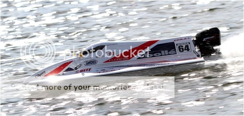

At the moment then the dummy OB is being looked at properly for the first time. As part of that an on-board video of the OB is showing mucho pressure washing of the rudder yokes, predicted, and clear indication of the thrust directing: https://www.youtube.com/watch?v=dN6d8JjtlDE
And some stills, taken in terrible light I'm afraid, shows the boat running a little stern down through not being at full chat, cooling water flow OK, and at least on the water prime for tweaking.

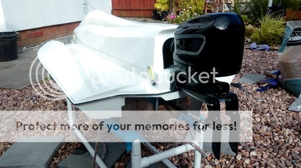

The catch up images.

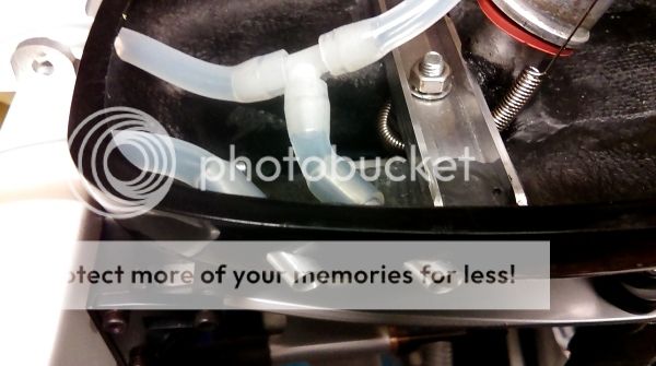

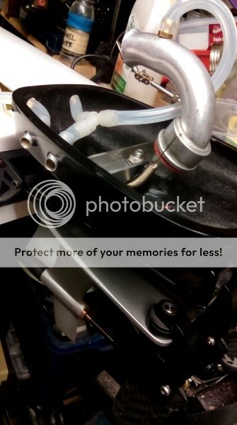

Here's the water outlets mentioned. As a reminder they have been set up so that they are easy to check on the fly. The left one is the engine outlet, the right the exhaust cooling which is Tee'd off to an fitting on the exhaust extension.....:
Which you can see here:
With the tuned pipe fitted is just juts into the extension without a true seal. It does not seem to be a problem for the engine, but maybe too soon to tell:

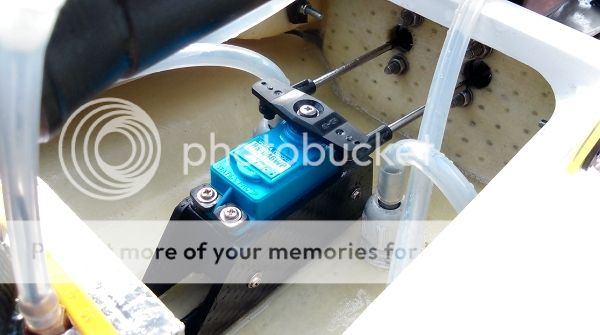

The steering servo is in keeping with a recent trend of mine, to fit waterproof ones and a simple small radio box. So far so good with these HiTec's:

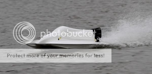

And a better picture from more trials today in quite rough conditions, which were useful. He's getting to know where the limits are after a couple of hectic spin outs and a roll. The boat is clearly rear end locked under way, probably that wide leg, and the steering is hyper RPM sensitive, but he's getting to grips with it and grinning a lot:
We are close to settling this now. As you can see the longer rudders are on (mediums), but we plan to cut them down a tad after today's tests, they were a bit too big a step.

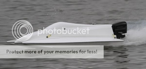

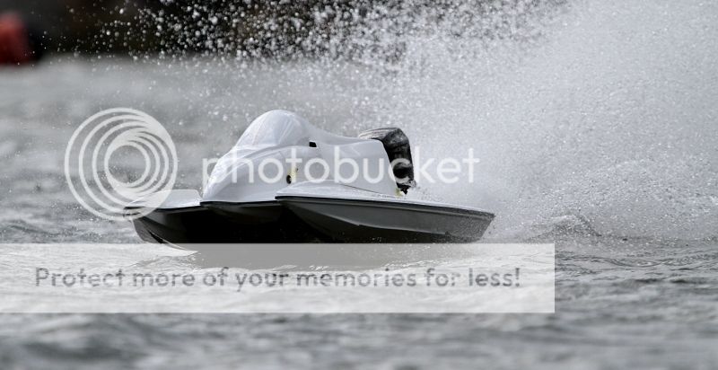

Here's the finished boat pictures as promised.
It's working fine, the lad is enjoying his boat but we are looking forward to the proper engine to become available to really see this thing on full chat. I'll revisit this once that is in place.
