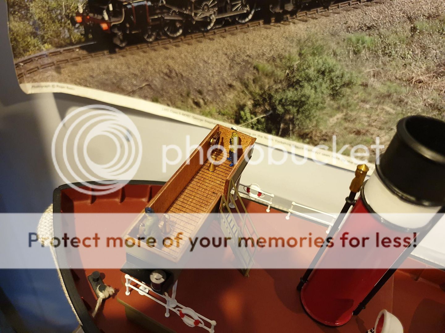

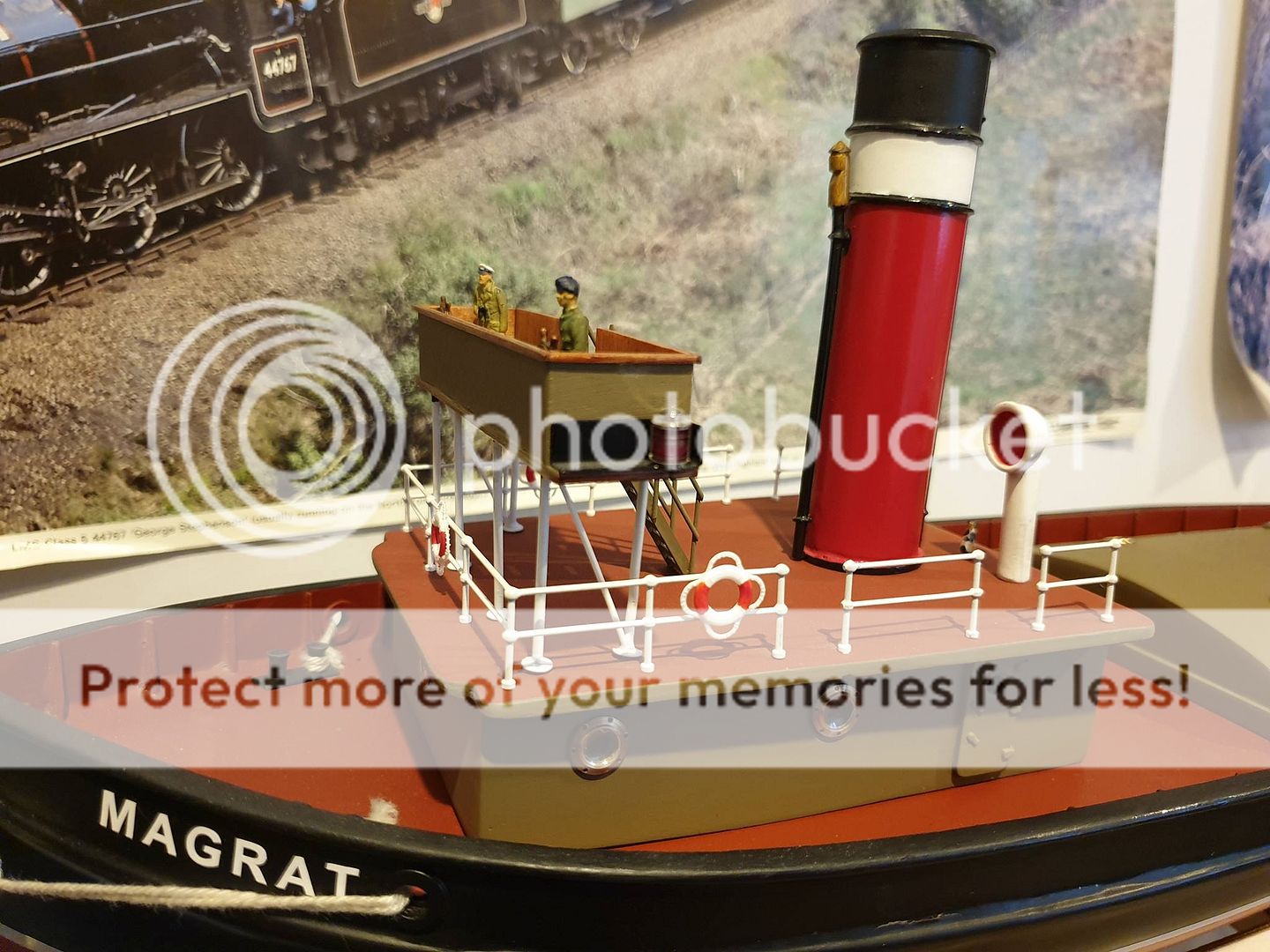

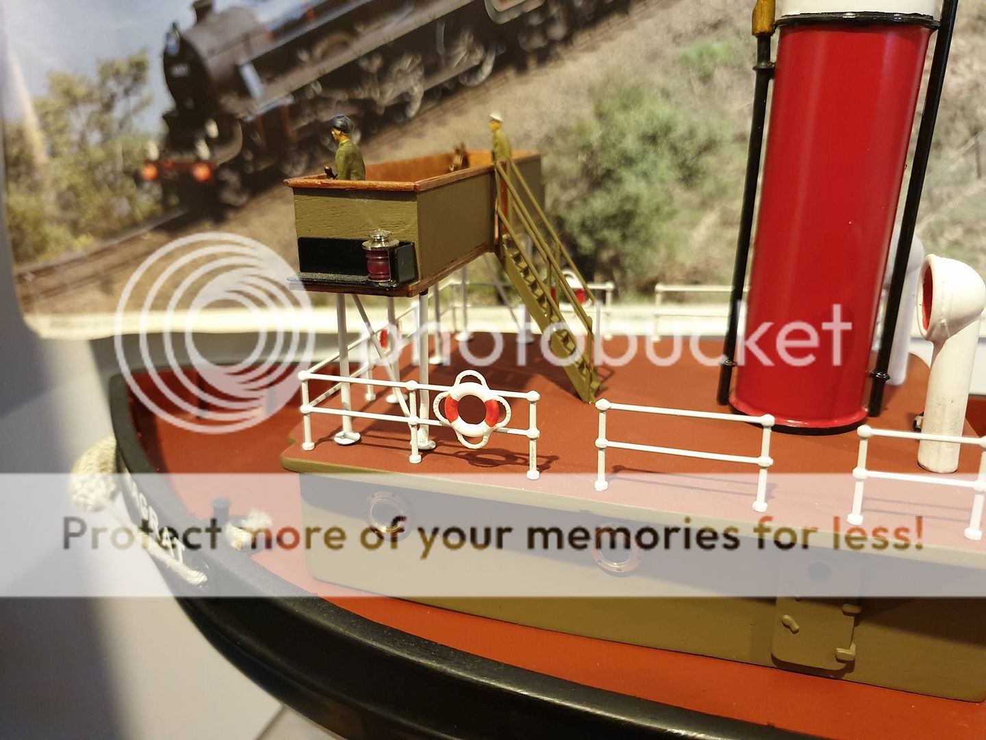

I have been working on the flying bridge. Its more or less as Vic Smeed intended it to be but I've put working navigation lights on, wired to two lengths of copper self adhesive tape which in turn will be wired to the support frame.  A Forge Electronics sound system has been installed with assorted hooter noises uploaded.  I also have found time to fit the bow fender  :-)

The flying bridge is as complete as I think its going to get for the moment.  The hidden wiring for the navigation lights has worked well, one leg either side being a pole, tiny link wires connecting them to self adhesive copper tape under the floor, to which the bulbs are wired.  I have the necessary switcher unit to wire in to control these, I just haven't done it yet.  I'll probably paint the companionway handrails white.  It was made via a Plastruct stairway and some styrene rod, very fiddly.  The crewmembers are courtesy of a Revell 1/72 U Boat kit, I managed to acquire them off ebay.  The telegraphs and wheels were out of Cornwall Model Boats catalogue.  I was very tempted to try and replicate the chain steering but I have left it for the moment.  The ships cat is a Langley Models whitemetal casting, a spigot into his 'bottom' holds him securely.
