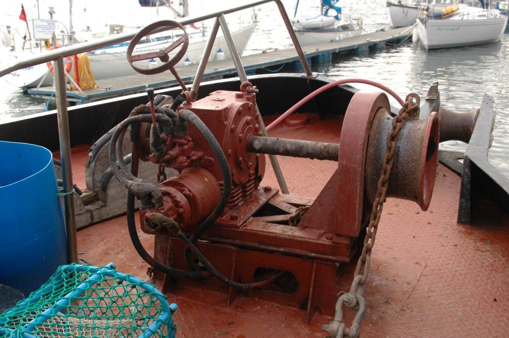

I also added some representation of hydraulic (or probably power actually) line to the winch
Then I drilled through for the anchor deck hawse, and the guide wheel for the chain. I also added the little tie down point on the deck which appears in photos with a chain shackled to it. some little D shackles are currently on order from Cornwall Model Boats
Reference photo from: http://www.modelboats.co.uk/albums/member_albums.asp?c=72689
Finally, I decided to stick these guys together. I managed to snag them off eBay a couple of months ago for a good price, they're actually not that easy to come by.
Turns out they make a perfect little vignette around the anchor winch. Unfortunately none of them are really going to be suitable for a guy in the wheelhouse steering so I'll have to have a look round for something else for that.
Alex

Hi guys, got a decent bit of progress done on the Conserver so thought I'd stick some pics up.
The deck is now painted and weathered, along with the anchor winch and chain. I added some rubber fenders (which incidentally are only half the price of actual, full size, 1:1 scale fenders...) I also painted up the Macs Mouldings deck cleaning set which includes a resin mop, brush, bucket, and wellies.
I then moved on to getting the wheelhouse a bit more complete.
And that's where she is now
Alex
