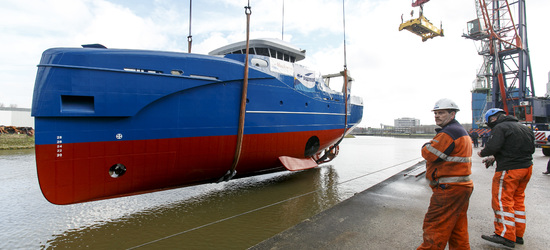

Normally a lot smaller than on the model however there is a new fishing boat design from Holland that uses bilge keels as part of the engine cooling system ( instead of running the cooling pipes along the hull causing drag they are built into the keels )
