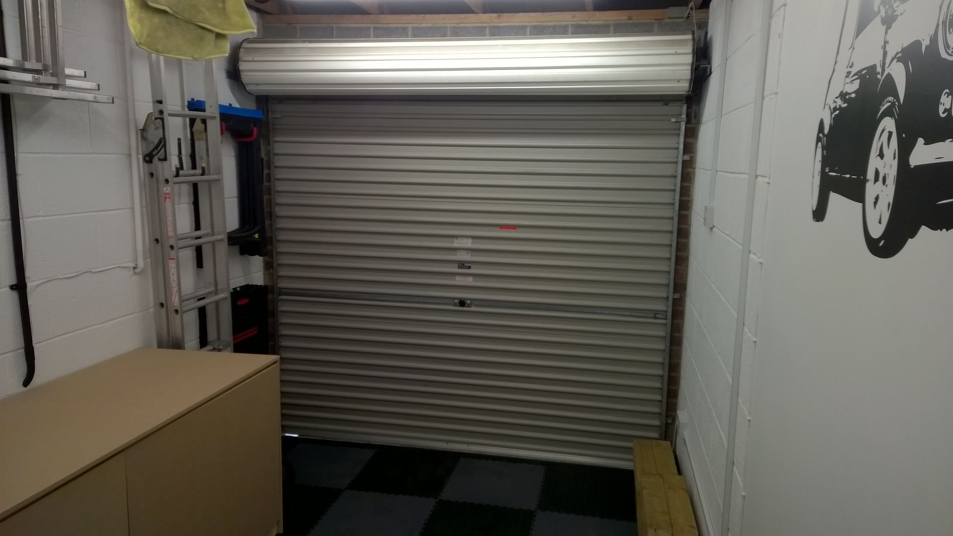

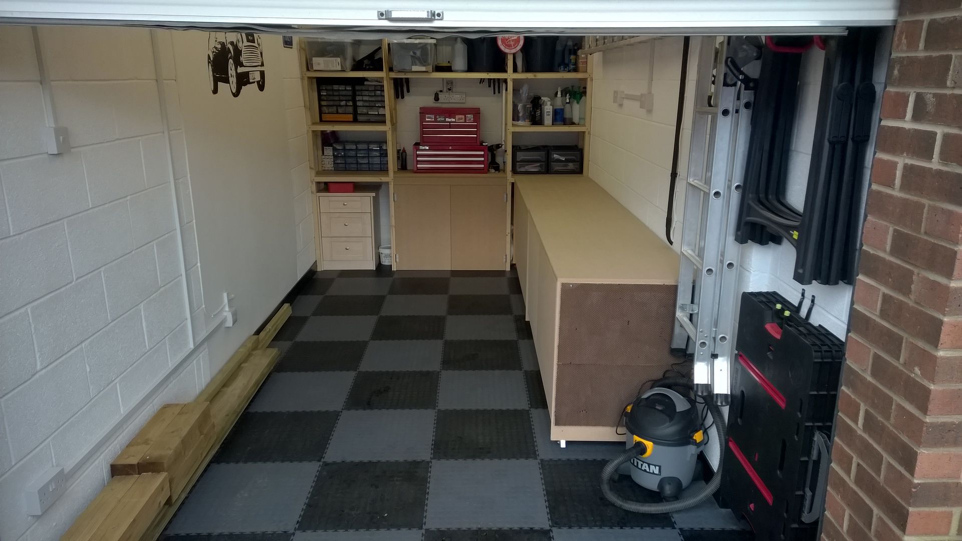

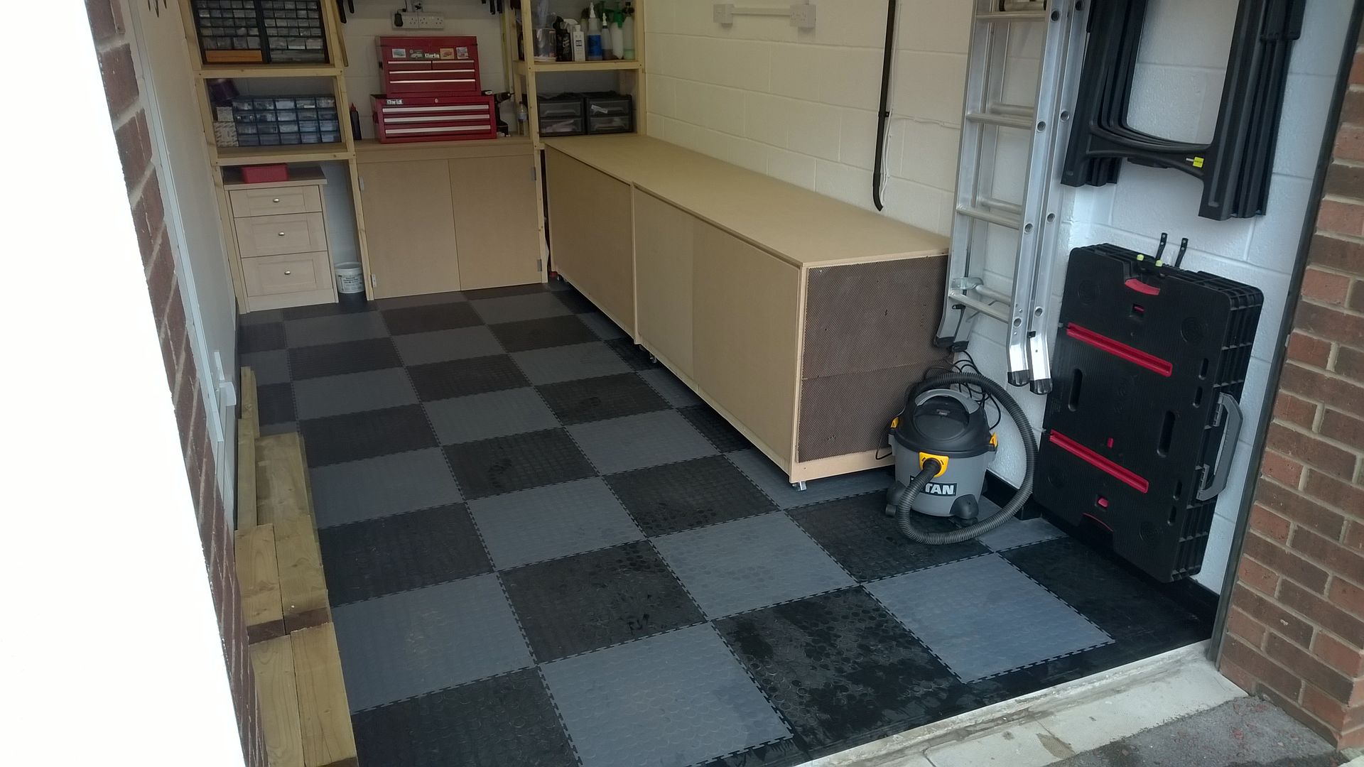

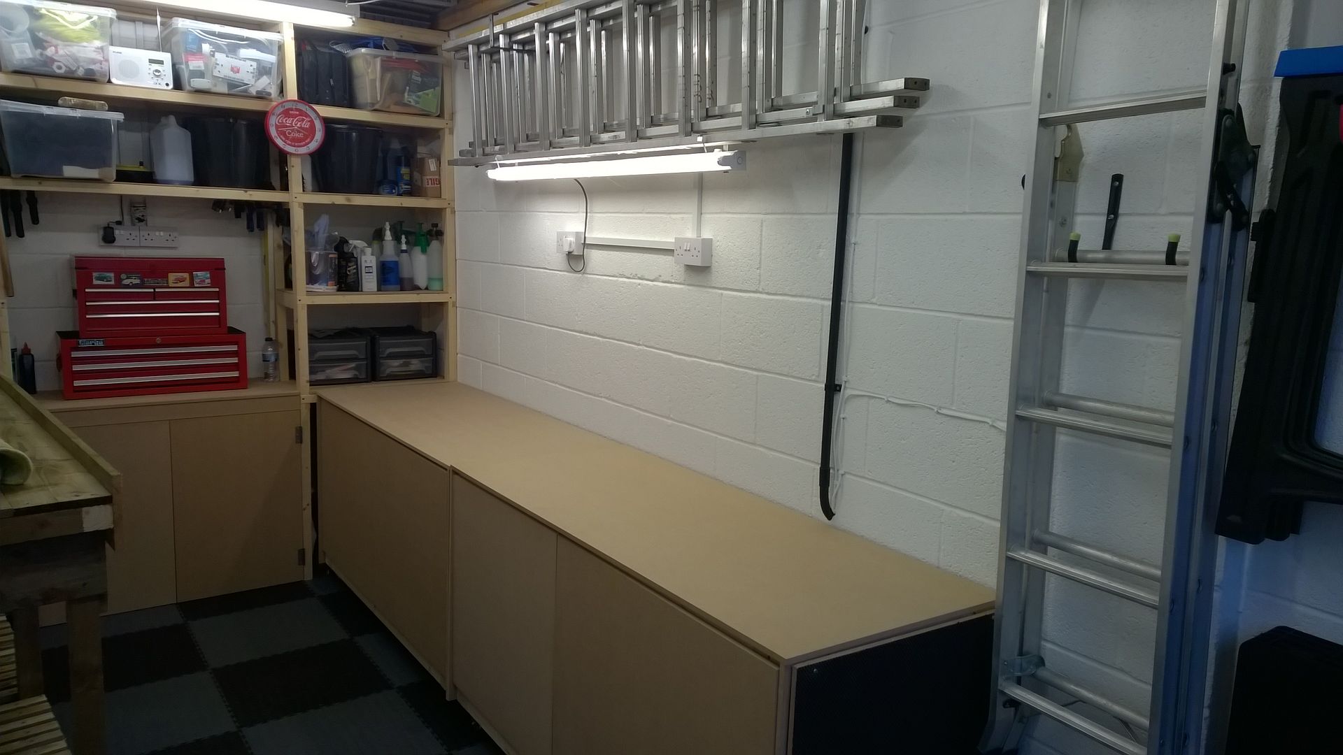

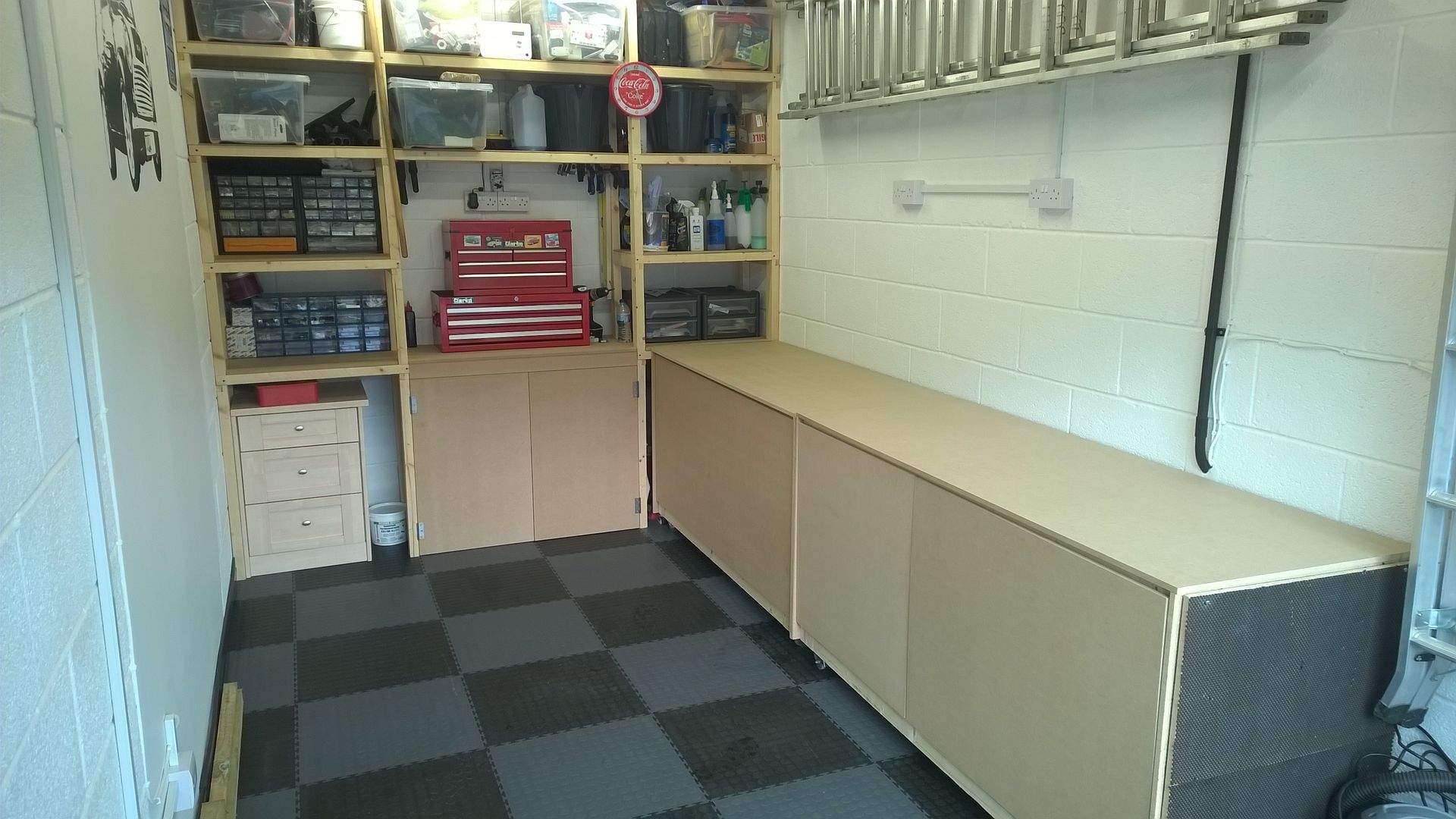

Thanks again for all the replies....
Lots to think about...
Hopefully these pics will work to show you all what I am working with (after a good tidy up today and installed a worklight above the benches)
The lights don't look very bright in the pics for some reason, but they are!!
So, what do you all think...am I going to be ok???

Hi Dave
Very nice ,
I really like the floor tiles  (where did you get them from pls)
Get building

Thanks Spud
Although expensive, they are and have been brilliant since I got them.
Flooring from here...
http://www.ecotileflooring.com/application/workshop-flooring/
Skirting from here...
http://mototile.com/motolock-interlocking-flooring-shop.html?gclid=CICQyvK0k8oCFagewwodVr4P8A
nice alternative to carpet, but not as warm on your feet  ;)

That is an insiring place to work Dave. I can see elements of many ideas from this topic demonstrated in what you have achived. I love this forum :-))
You will build many great models in there and I hope we get to see them being built:O)

Nice space and lots of scope for you. Suggestions -
Some easily removable insulation on the garage door will help.
An LED lit angle-poise magnifying lamp for close work might be a good idea. I have one and love it.
A small brazing hearth made from three small pieces of Vermiculite is handy and safe. I got mine from Ebay for £8 and it stores flat and neatly. I looked but couldn't see one on Ebay today.

Looking at your pics, there is room on the left hand wall (above head height) for a lumber rack for strip wood. You don't need a solid shelf just something like brackets going out from the wall for the wood to rest on.
Or if you want you could have above head height shelves.

A handy tip for you, print those pictures off and put them up on the wall to remind you what it used to look like. I spent a good month getting mine how I wanted it, turned my back for a day and bamb, it became a dumping ground again, not to mention the little bit of mess I made........................ ok2 ok2 ok2 ok2
Nice set up, if you are going to use small power tools like a dremel or the like, rather than having them laying about and getting in the way, use one of those hanging basket retractable hooks, get them for about a fiver off amazon, keeps stuff out of the way.

If you are going to use power tools an incandescent desk type lamp may be a good idea, as you can get a strobe effect from flourescents that make the power tool appear stationary.

So have I made the wrong choice by fitting a fluoro light above workbench???

I wouldn't worry about it too much, that senario mainly applies in industrial premesis where the Heath and Safety loons patrol. They may appear stationary but the noise of the thing will give you a clue if it is running or not................... :-))

Depends on what Hz your lights are and what Hz your tools are, if both 50Hz then you will get strobing, at some point, if they are different then strobing will not happen.

Also depends on things spinning at exactly the right speed to appear stationary. I am using flouro and have never noticed the phenomenon exept with a spinning circular saw blade as it slows to a halt. Looks like it goes one way, slows, stops, goes backwards etc.

I only mentioned it as a warning it could happen, I have always had fluorescents as a main light, but also sited tools in front of the window, only once (when it was dark outside) have I tried grabbing a lathe chuck that looked stationary while it was turning, not something I want to repeat. that was why I suggested a desk lamp or similar, as an additional point of work light.
If it was an industrial workshop they would insist on at least 1 incandescent light as a precaution, but its not strictly necessary as long as you know it can happen.

Using twin fluorescent tubes negates this problem. This was standard practice in machine shops I worked in.
