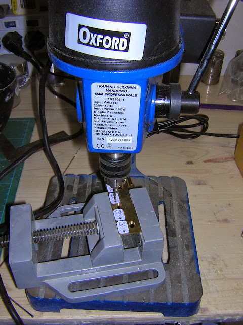

HELLO Hande, I also built from scratch the smit nederland. Here's how I solved the problem of the rudders and backer of kort rings.
I drew with autocad the pieces that make up the helm baker. In practice I did sliced horizontally the helm in 10 layers. I made 5 layers with a profile with the hole for the hinge and 5 layers with a profile without hole for the hinge. Then I glued the layers one on 'more to get the shape of the rudder. The parts were laser cut from a sheet of plexglas 5 mm thick. Always plexigals I made the blanket perforated laser, replacing the wood as it is more 'easy to finish and waterproofed.
Some photos of the details of the rudder baker. I've made using a piece of a brass zipper and brass rods from advanced kit rotterdam
kort rings are used to increase the power of thrust of the propellers. I made them realize plastic by an micro mechanics. I realized the grooves with the milling cutter for the base of the rudder and the lock ring fixing to the hull. The first I realized by a square-aluminum. The second by a length of beech suitably trimmed.
Here are the pictures of what indeed said.
Greetings
Francesco G alias ALIMURIMETA

Che imponente, Francesco!
Nice facilities for drilling and even laser-cutting.
So far, I am using the parts provided in the kit. The rudders are also from the Billing Boats kit.
Let's see, if I get encouraged to start a scratch build. I seem to lack proper facilities to attempt that.
Regards to Salerno!
