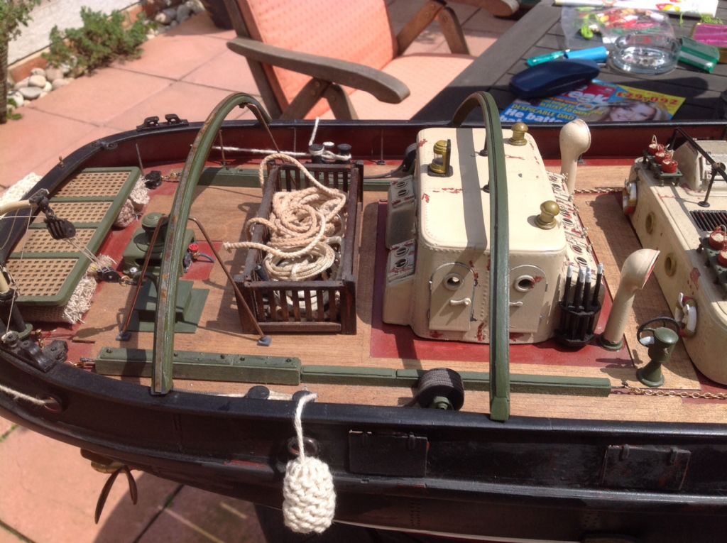

Re: Building the CalderCraft Imara
« Reply #107 on: July 09, 2017, 10:37:48 am »
Here's my Imara.
Any help ?
« Reply #108 on: July 09, 2017, 10:45:48 am »
Thanks, but I'm afraid this isn't detailled enough. If you could take some close-ups from the section in question and / or measure the size of the small bollards plate, I'd appreciate it and I'd also owe you a beer or twenty  ;)
« Reply #109 on: July 09, 2017, 10:49:46 am »
I'm afraid the model is long gone and all I have are the build pictures you see.
There is a build blog on here if you have the time to go through it, but I feel that the accuracy that you require may not be found in this builders repetois.    :}
I have been looking back through the site and cannot find my build, but there are other builds where you might find the information you are looking for.
Hope this helps
ken
