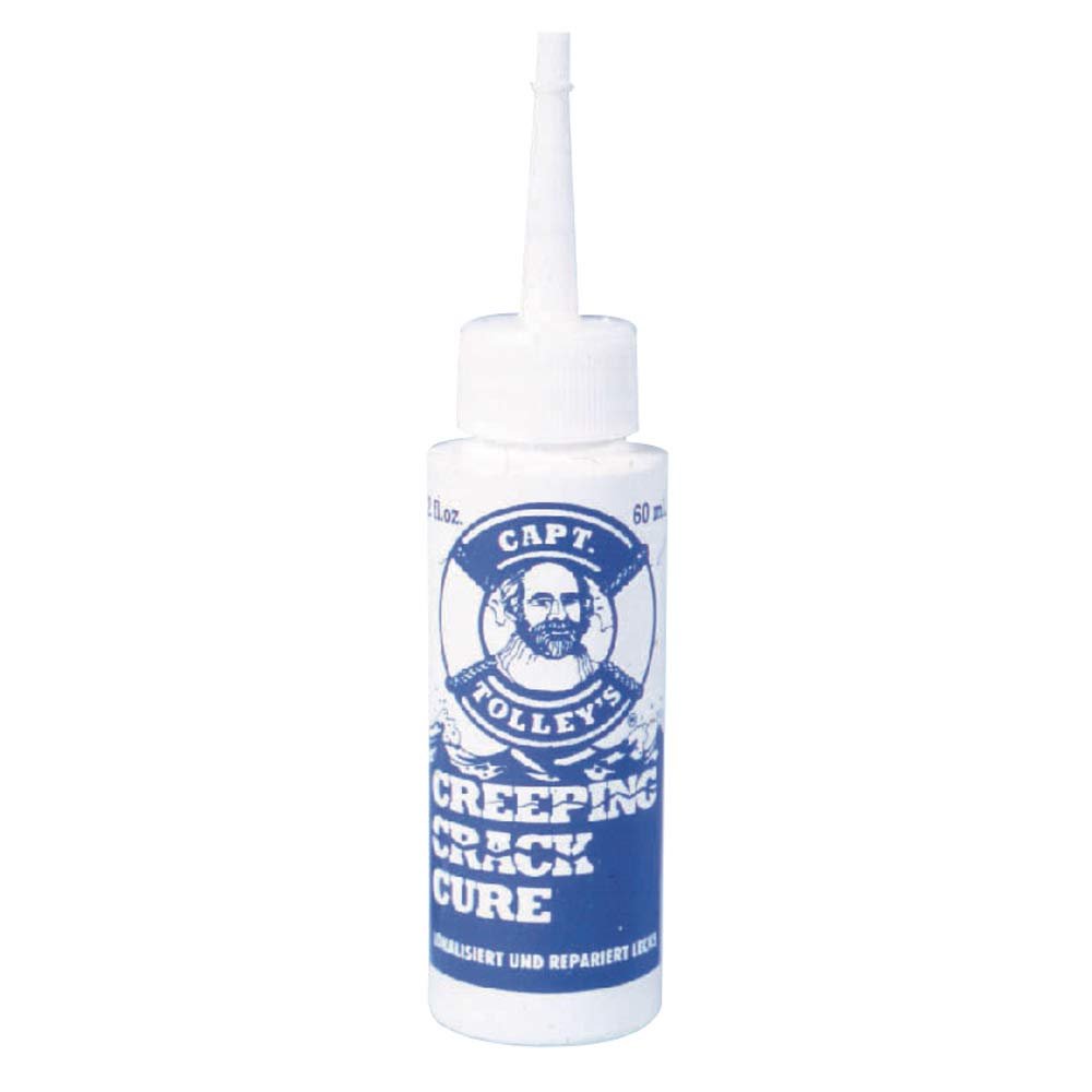

Well I have managed to get to the test tank in what was a bit of a summers day . I have managed to stop the two leaks I had at the stern thruster . I used a product called Captain Tollys Creaping Crack Cure bought  on line I saw it in a chandlery years ago. It is thinner than water and has good capillary action . I used a syringe to place the glue .
 Now I can get on and try for a test sail .

I used a product called Captain Tollys Creaping Crack Cure.
David
Hmmm, can't say I've heard of that one before - I'll add it to my list of products for checking out. O0
Thank you for the info David.

How long does it take to dry suitable for use in the wet stuff? Looks like a useful tube to have handy.
