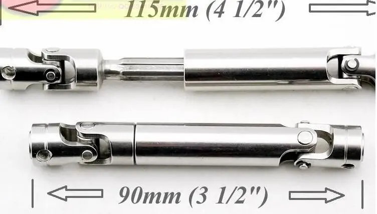

This is my understanding. You should have 2 universal joints connected by a linking tube - like an old car propshaft. The input shaft & the output shaft should still be parallel but can then be slightly out of line.
The one universal favoured by model boat owners is a very poor substitute as we rarely get exact alignment and the reality is that the motor & propshaft never have absolutely no play. This is why I use belts or gears.
Like this:
https://www.aliexpress.com/item/1pc-RC-Toy-Car-Spare-Accessories-Cardan-Telescopic-Universal-Joint-Climbing-Car-Transmission-Shaft/32810670038.html?spm=2114.search0301.3.46.d05QH6&ws_ab_test=searchweb0_0,searchweb201602_0_10190_10192_10073_10130_10152_10151_10557_10537_10539_10055_10154_10056_10155_10059_10312_10179_10314_10534_10313_10533_10060_10084_100031_10083_10184_10547_10107_10307_10548_10341_10065_10142_10340_10068_10343_10541_10342_10562_10301_10345_10103_10102_10344_10303_10325_10324-10102,searchweb201603_0,ppcSwitch_0&algo_pvid=1a070c75-abac-497d-9bf6-fb48b15c59d6&algo_expid=1a070c75-abac-497d-9bf6-fb48b15c59d6-6
Ideally it should also cope with some for & aft movement of the motor or prop shaft which is why your car propshaft/ drive shafts have a sliding joint..

How should they be used?!?
Martin, I you remember, Irish Car guy and I did an extensive thread on the proper use of universal jints a couple of years ago.
oldiron
  • Posts: 3,326
Re: Motor to prop coupling
« Reply #11 on: November 14, 2017, 12:44:16 pm »
  Congratulations, some one else has got it.
Can't understand the way the rest of model boaters don't get it.
Look under your cars guys, The drive shaft there says it all

I hear you Martin but I have seen so many out of line models and heard so many complaints about inexplicable vibrations etc.
Each to his own but when you think of the time & money a model boat costs I cannot see the necessity of the short cut.
One odd thing is that the US modellers had an easy answer with the Dubro Dog Bone coupling but the idea never caught on here.
