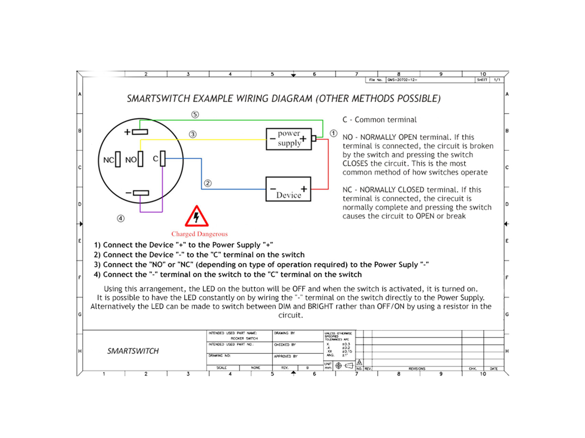

Hi guys, ok at the mo i have a simple on/off power switch which is similar to this:
But i want to use something like this one off ebay: https://www.ebay.co.uk/itm/SmartSwitch-12V-24V-22mm-IP67-Steel-LED-Illuminated-ON-OFF-HALO-Button-Switch/142394830989?hash=item212764b08d:m:mNFmbyjP43NOsbKwNL_UxdA:rk:1:pf:0
but im not sure how i would connect it up, it shows a daigram but im a little confused by it as my current switch is just wired using the positive wire from battery?
heres the diagram:Any ideas?
Cheers :)

« Reply #1 on: January 07, 2019, 09:42:26 am »
Illuminated switches, as well as the normally expected switch, contain the light source that needs power so they need a bit of extra wiring to get the power to the light.
Internally, it connects between the switch terminals marked "+" and "-", as shown, it lights when the switch is operated.
If it needs to be on permanently, move the purple wire from "C" to share with the yellow wire on "NO".

« Reply #6 on: January 15, 2019, 08:35:17 am »
Switch is rated at 5A maximum current - this is more important than the voltage.
DM
Re: Illuminated power switch
« Reply #7 on: January 15, 2019, 10:01:23 am »
DM
The voltage gets a bit crucial when considering the thing lighting it up.  Too little, not bright enough, too much, a brief, bright, life.  While the switch might handle more than 12 volts, the light might not, and the internal light on switches tends to be not replaceable.  Sealed for life.
A 12/24 volt type "might" have a constant current circuit limiting the lamp current (might be an LED. might not) rather than a simple resisitor, or it might just be fainter on 12 volts.  Anybody's guess.

« Reply #10 on: January 18, 2019, 09:20:03 am »
Battery im using is a 12v 22ah, so would i need a switch that states 22amps or more? & obv 12v.
The 22aH refers to the capacity of the battery.  Think of it as being a statement of the size of a fuel tank.  It tells you almost nothing about the current that it can deliver, what it can deliver has sweet nothing to do with what any individual bit of circuit will draw.
Since almost every switch made is good for 12 volts, that is taken care of.  Switches do have two other ratings.
One is for how much current that they can carry when settled "on".
The other is for how much they will reliably live through when changing state.
When the contacts are close together, they can arc, this usually happens when the circuit is being broken as the flowing current hops over the small air gap.  But most switches have a bit of contact bounce, and a single operation is more like a round of applause, being a series of makes and breaks.
The light part will take less than 100mA, whether it is a GoW bulb or a LED with a limiter, and is fairly independant of the load being switched.
Usually, what will handle a lot, will handle a little, so the linked one should work fine provided that the panel it mounts on is strong enough.
