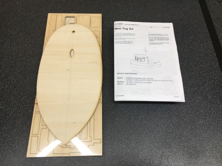

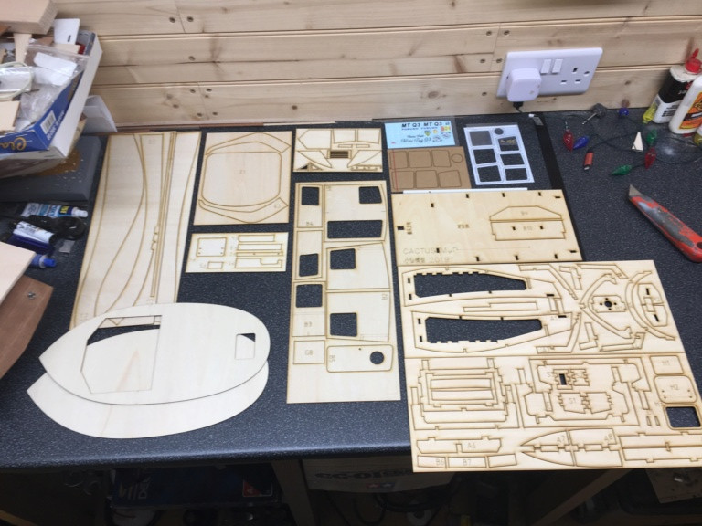

The box arrived very well packed, the box itself with the parts in was contained in a much larger box covered in foam wrapping and the foam penuts, as you can see from the photos the actual kit box was undamaged, and shrink wrapped, really well done for that, the parts are perfect ( as in not damaged) opening the box the wood parts again shrink wrapped, so no warpage so far on a quick look, and there is a chinglish set of instructions but with a lot of colour photos which will help decipher some of the language issues I hope.
As you can see from the parts I have all the wood parts laser cut and a base board, the plastic card windows and Perspex glass, mast material, and a set of what I think are water slide transfers.
I’m not sure if a stand is included in the wood parts until I have a look through, but making a stand isn’t really a big deal...
