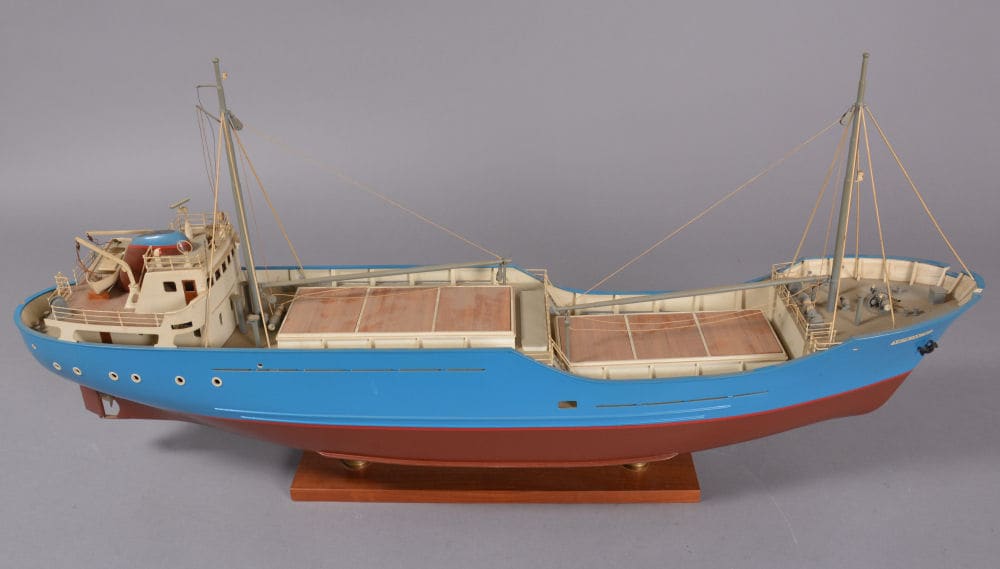

A blast from the past a kit from the 1960's
Coming soon.
Having just secured the purchase of an unbuilt kit I will start this post haste before it perishes  %%
Despite all the other part builds I have I just can't resist this one.
There is a lot of history on the web about this ship.
1:50 scale  37.5" long
