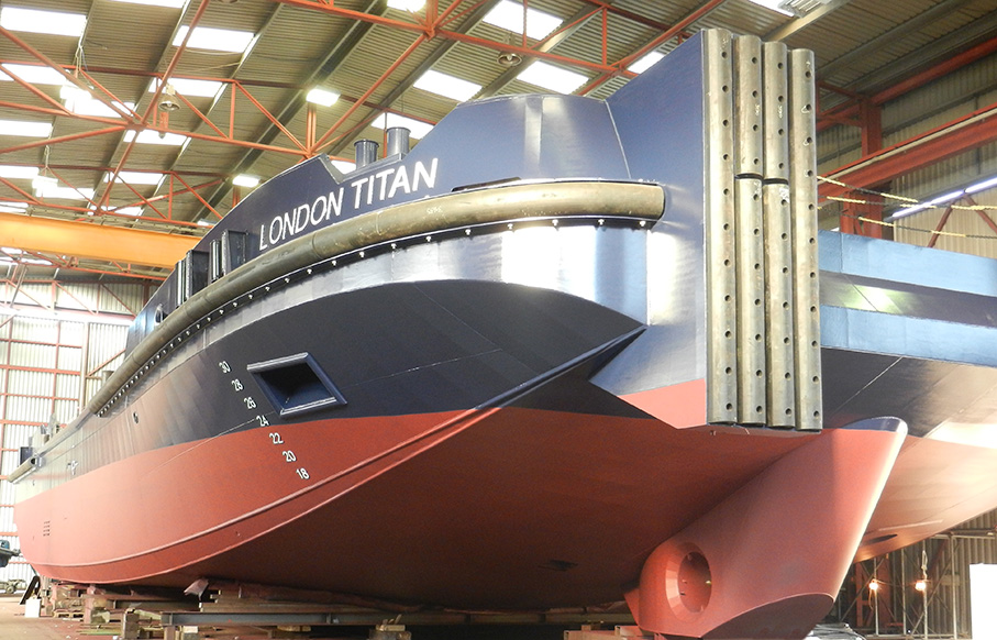

My first full scratch build with the help of Macduff.
I want to build this in 1:32 scale as close a resemblance as possible. The hull will be plywood with a glass overcoat and be a one off.
The deck will be paxolin and the superstructure from styrene sheet, all tried and tested on my Stevn's Arctic. At this scale she will be 1141mm in length by 422mm breadth.
No drawing data/plans supplied to me by Macduff can be shared so please don't ask. I won't be making a plug and this will be a unique one off.
I may even do working lighting this time now that I've mastered windows  {-)
https://www.macduffshipdesign.com/ship-design/36-50m-multi-mac-london-titan/
https://www.macduffshipdesign.com/project/36-50m-pla/
My photo gallery to date of the actual vessel. More can be found on marine traffic dot com and google image search.
https://techno.smugmug.com/London-Titan/
VIDEOS :-
https://youtu.be/BAmquzdd0dg
https://youtu.be/irDePDjDt7U
https://youtu.be/x5vPCV5MRFo
http://arthurpewtysmaggotsandwich.blogspot.com/2015/06/the-launch-of-london-titan.html
Initially my thoughts are to use 3 overlander 2836 brushless motors driving 3 x 45mm 3 blade props through sealed prop shafts (expensive  🙈) I'm not sure yet if all three props are right handed (unlikely) I cannot find a clear picture. A 24mm brass bow thruster will be imported from hobbylobby (also expensive 🙈🙈)

That is an unusual ship. The underwater shape is rather strange!
What is the Port of London expecting to use this ship for? The 30ton bollard pull + 120ton winch + two deck cranes + fore and aft rollers suggest a rather wide range of activity.

Ian sent me files today but I need to get them printed as I can't possibly work from a pc screen.
My problem to deal with is getting them to 1:32 and I'm not familiar with doing this.
The general arrangement drawing is excellent but it's scaled at 1:75 1:1 printed at A0
The CAD files again are a dilemma for me but I will get there eventually.
One thing I have realised quite quickly is that I will not need many of the frames of which there are about 70 spaced at 500mm intervals. These are for strength that I don't need on a scale model, I only need enough to form the correct shape skin. On my model the frames would be approx 16mm apart and with 5mm ply that would be folly so it's a case of exercising common sense.
Hull lines plan is 1:50 1:1 printed at A1
Ian does not have details of the props but he agrees with me that the port side will be LH and the others RH.
