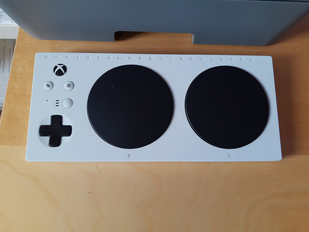

Now it works with pictures.
XAC

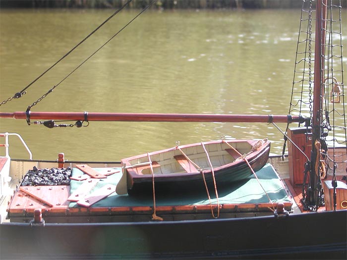

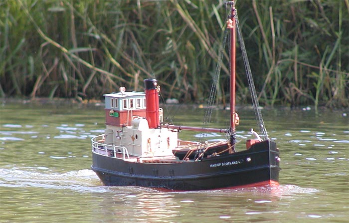

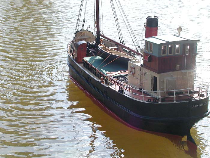

And finally Martins build
RST

I'm always impressed with alternative interfaces for different kinds of needs!  The computer / Arduino type stuff baffles me though.
Sorry for stupid question but for a puffer, presumably forwards, back, left and right for control:. What's the need for PC programming?  In your pic of your x-y mouthpiece, the same control could just be piggybacked onto a regular transmitter with little but DIY wiring for a separate joystick located at your convenience?

GolemXIV
  • Posts: 8
  • Location: Hamburg, Ger
Re: Mountfleet Puffer reworked for handicaped people
« Reply #4 on: July 23, 2021, 05:39:50 pm »
Thx for the answer.
I got half of the stuff allready here thats why i stick to my plan. Rudder, speed, lights and smoke generator are the function. I believe there are easyer ways, but this way i dont have to spend to much money.

It looks a great rendition of a puffer!  I'm slowly building one freelance.  I will copy some of those pics as they show some details I need to scale from.

« Reply #8 on: July 24, 2021, 12:18:22 am »
I can post some more pictures if you like.

« Reply #9 on: July 24, 2021, 04:33:04 pm »
These are from the end of the building prozess. Maybe someone find them usefull.
