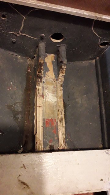

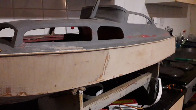

well as the weather wasn't to bad today i managed to get on with stripping the boat back to wood, 40years of paint and varnish and about 8 different colour coats through time, sides are done and have the hull, need more nitro mors and more sanding discs but getting through it slowly
3 hours with a dremel i finally got rid of the glue and silicone that the original motor was set into, just need to finish flattening so i can marry uop the motor and prop shaft

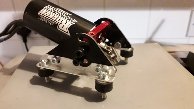

and made some ali angle plate for the motor and anti vibration mounts
