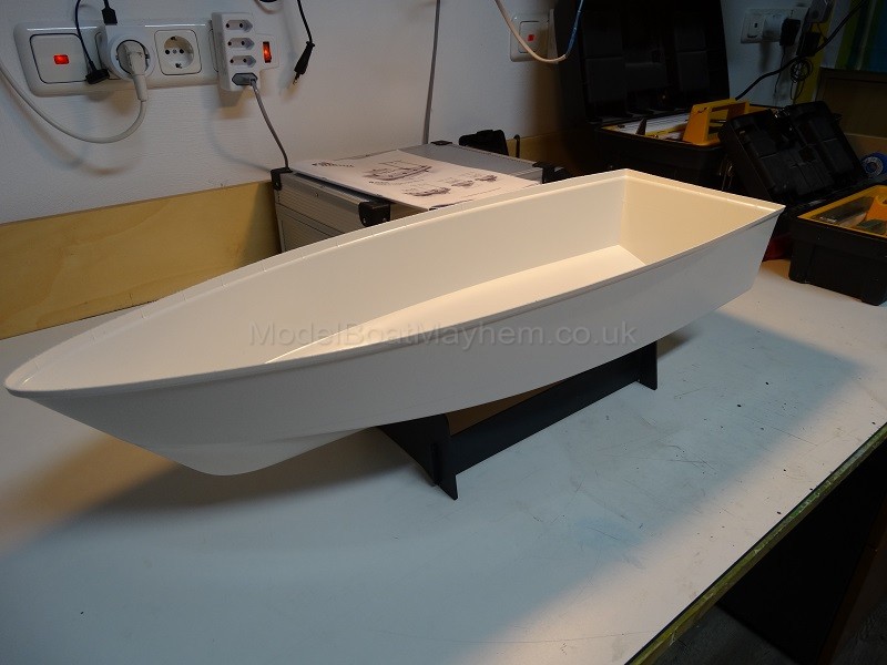

The kit:
Hull:

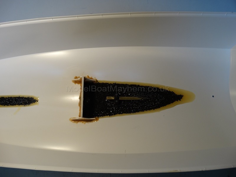

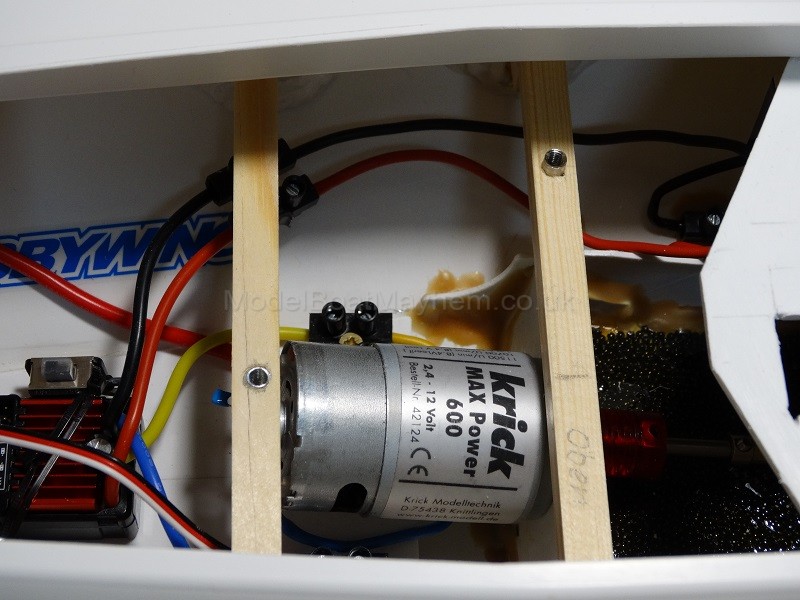

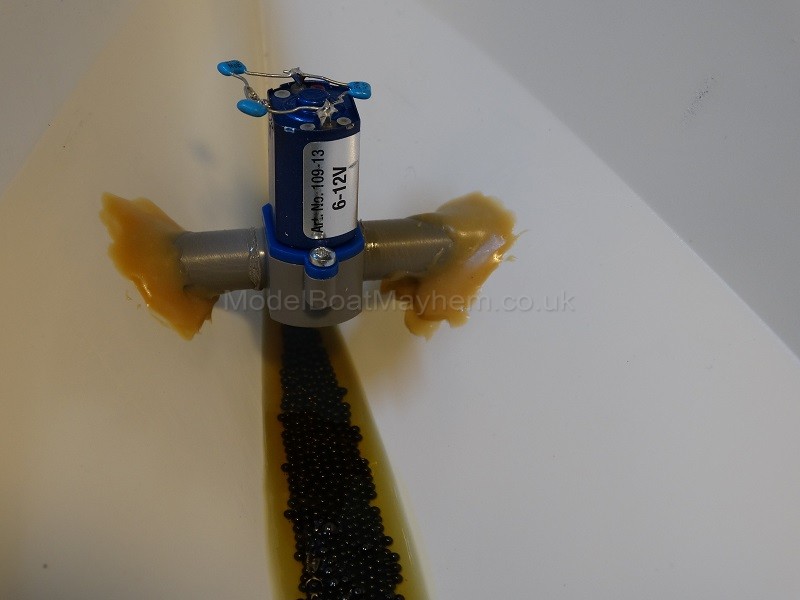

At first the weigths were checked and the initial ballast (Leadballs) were placed in the hull and fixed with epoxy-resin.
Next the ship was equipped with a small bow truster as it is also intended to fetch free floating objects (buoys);
this thruster should help in the effort.

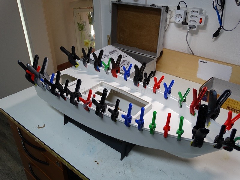

Fixing the deck to the hull is easy, just make sure that you enough clamps:

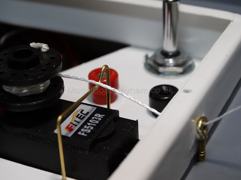

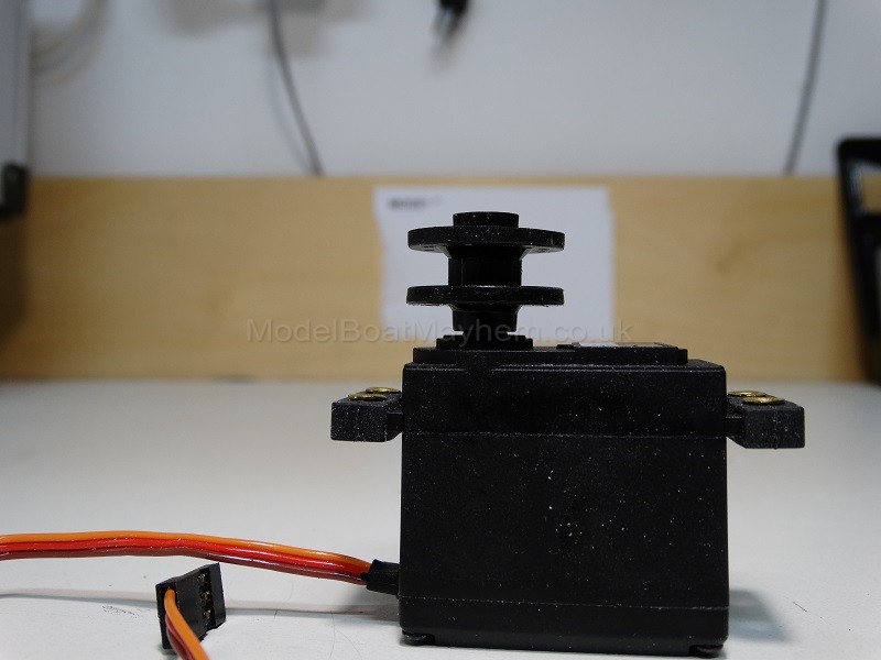

For operating the crane hook up and down, the intended sailing-winch was replaced by a continious turnnig servo; the handling of the hook is now much easier and can be done more precise:

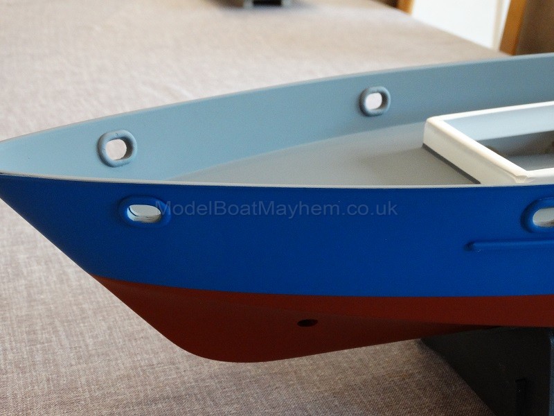

The designer of the model forgot some openings in the bulwark for getting ropes to the bollards. four of them were added to the front section:

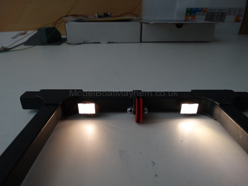

 The crane is now operational including working lights:

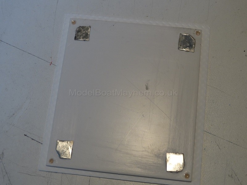

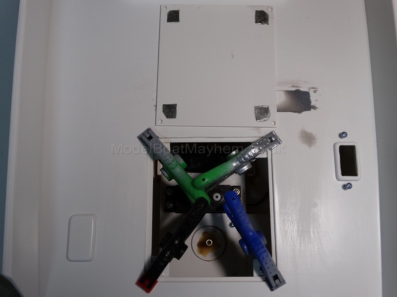

The back access opening was not secured with screws, instead 4 magnets were used:

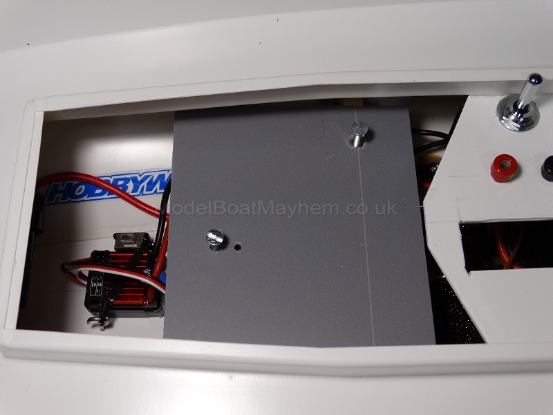

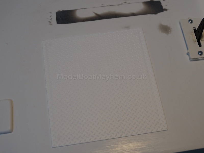

A thin tear plate was glued on the cover for this opening; it is 5 mm bigger on each side as the coverplate, thus hiding the gap between plate and deck:
Two wooden crossbars with threaded inserts were glued to the hull to carry a plate which will hold the receiver and other electronic equipment:

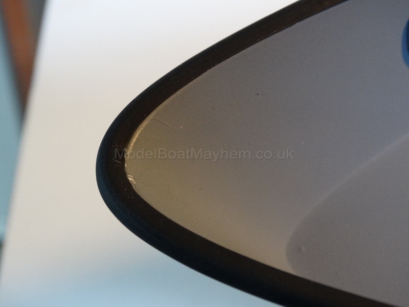

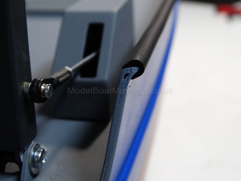

As I had already some light collisions with the doorframe, I decided to add an edge-protection profile (mostly used on glas or metal sheets) to the edge of the sidewall:
The profile was secured each 5cm with a small drop of clue; it was possible to stretch it a little bit around sharp curves as in the bow:

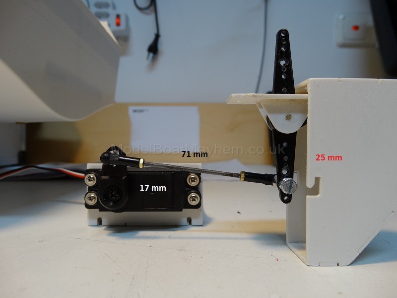

Might I ask if the pushrod that moves the crane jib connected to a standard servo?
It looks as though a lot of effort would be required for a regular servo to move the crane jib, especially as the pushrod ball link is so close to the fulcrum point formed by the crane jib and the deck mounting thus giving only a small mechanical advantage.
Pauli
Speed123
  • Posts: 188
  • Location: Gerderath, Germany
    • HAST Hobbyseiten
Hallo Pauli,
part of the extension set for operating the crane is a strong servo and a lever, which transforms the movement from below deck to on deck:
The movement can be seen on the this small video:
https://youtu.be/yNb8ajcvAdY
The initial tilting of the crane is shown here:
https://youtu.be/qjD1_qyOWjU
The jerky movement was due that the lever was too flexible in twisting.
A reinforcement with some 2-componet-glue stabilized the lever and the jerking got better.

  • Posts: 70
  • Location: West Midlands, UK
Hi Hans,
The photo explains it all!
The long servo arm provides the necessary mechanical advantage in order to move the crane jib arm - quite a simple yet effective mechanism.
Thanks for the photo and links to your videos.

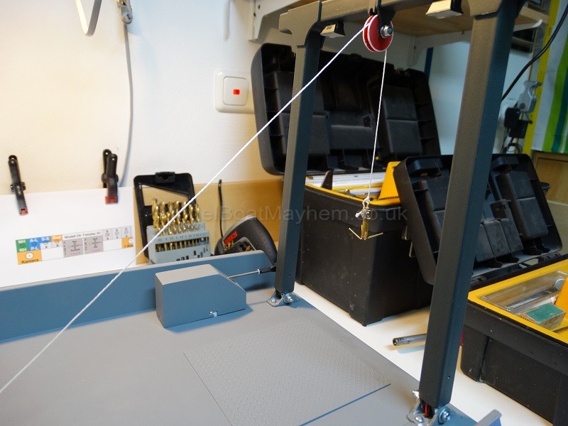

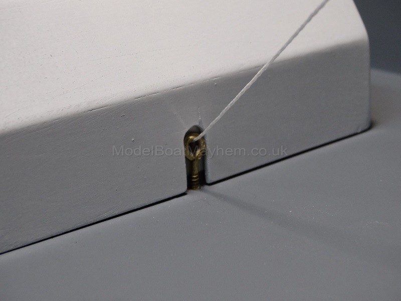

the next picture shows the final guiding of the rope for the crane hook. This way the rope doesnot go through the wheelhouse and make is easier in handling:

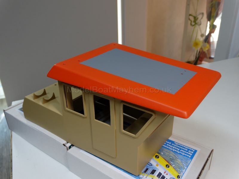

The wheelhouse just gets a litte slot in the bottom:

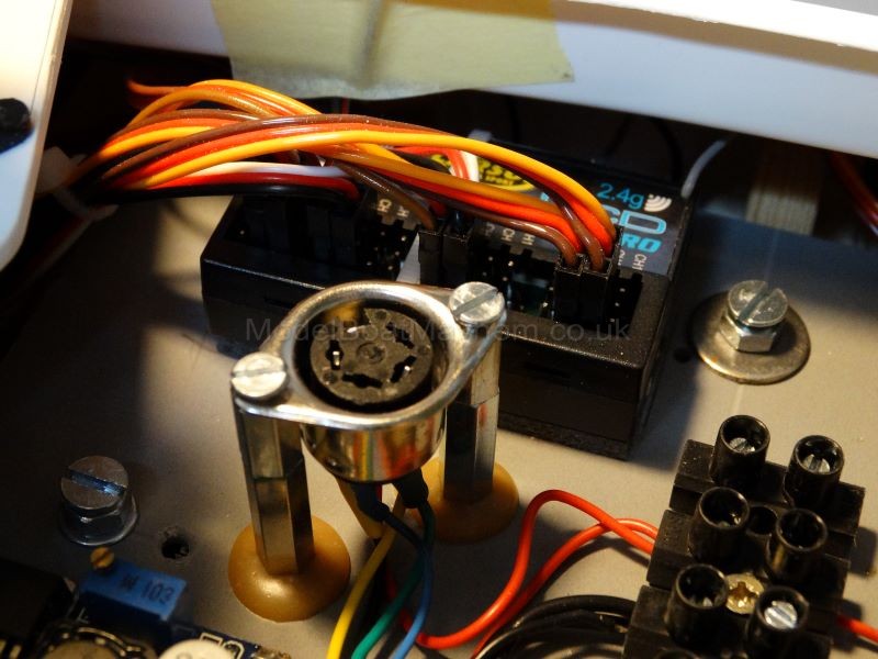

The baseplate for the electronic equipment got a female plug for supplying the wheelhouse:
The painting of the wheelhouse is finished ready for further assembly:

You have made a really neat job of the electrics insulation. Regarding the DIN plug to supply power to the wheelhouse - what electrics do you intend to install there?
Also I have a question regarding the operation of the servo that you are using as a winch. Will the operator have to carefully regulate the reeling in of the rope so that the grappling hook doesn't foul the pulley mounted at the top of the crane boom or will you have some kind of limiting switch to stop the servo when it reaches it's limit?
Looking forward to your next update.  :-))
Pauli

I try to install the "electrics" as clean as possible for it helps during the later trouble shooting
The DIN plug connects 5 wires to the wheelhouse:
+6V via the shielding
 -6V Radar
 -6V Navi-lights
 -6V Working lights
 -6V Search light
 all four are via a remote switch.
The "servo" is continious turning 360+ degrees without limits;
it is operated by one of the sticks thus having full control over the speed of the hook.
This is useful as you have the pull up the hook at the same time the crane is tilting in.

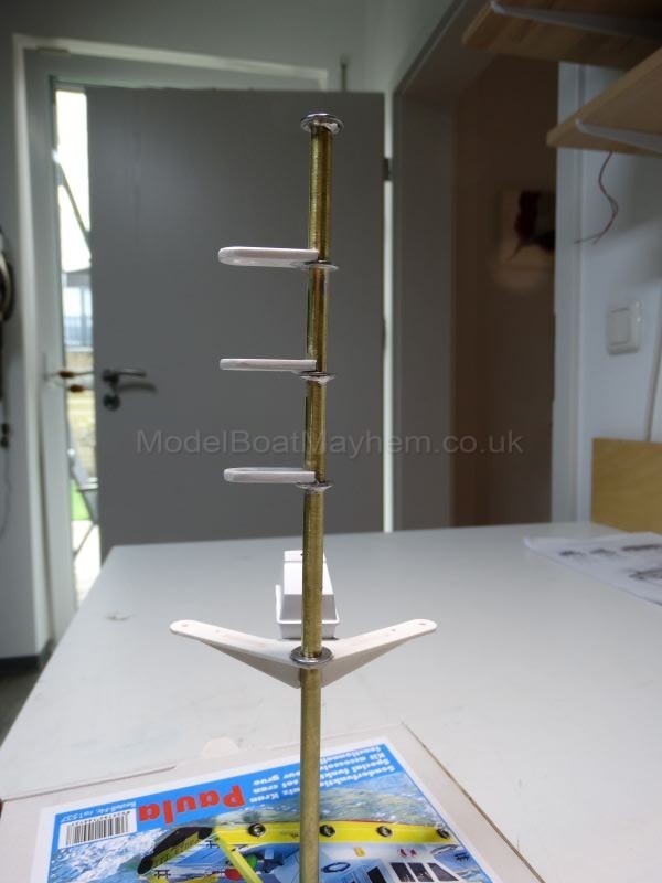

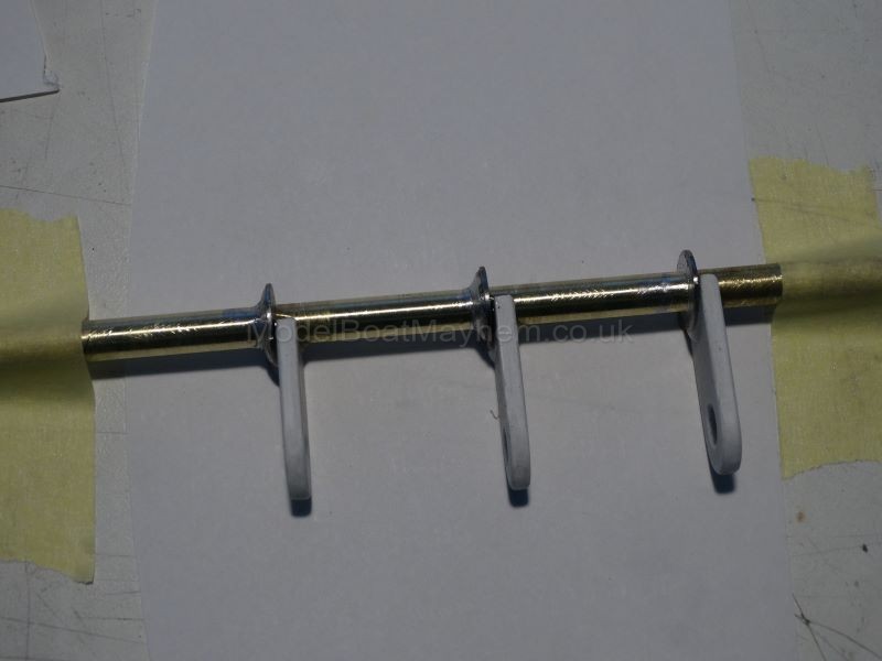

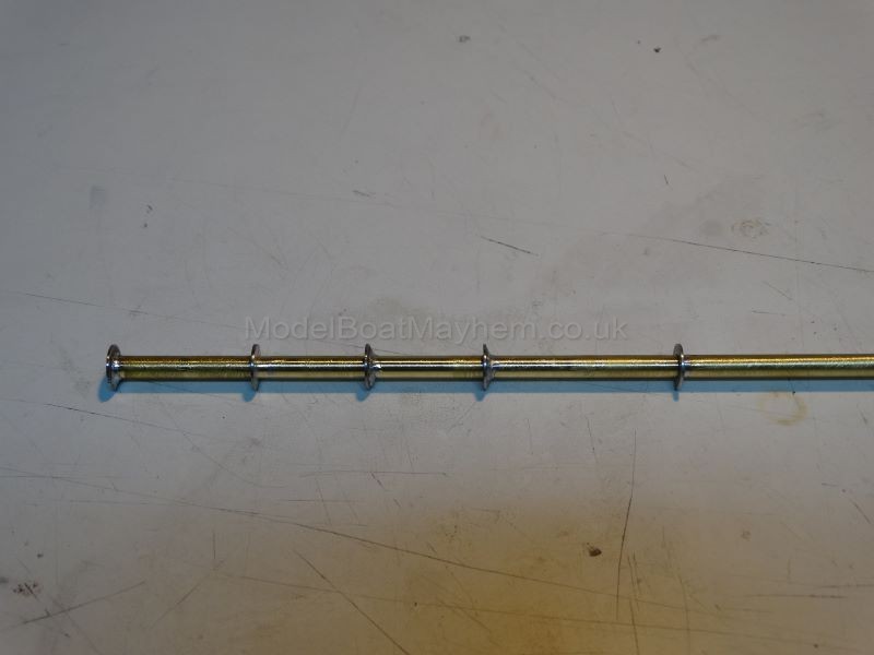

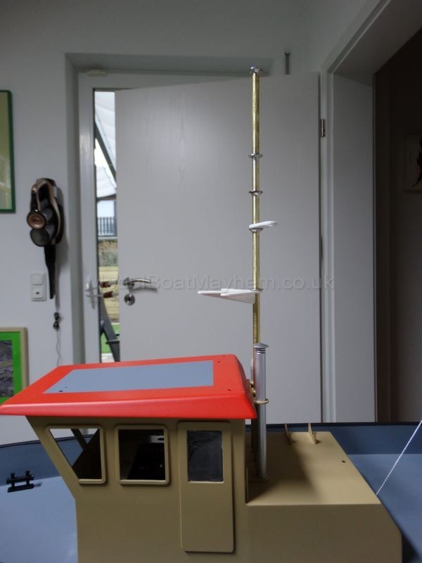

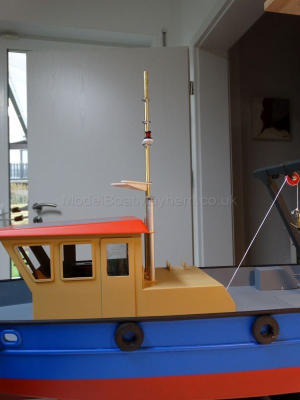

Started with building the mast; there are two topics which needed attention and changes:

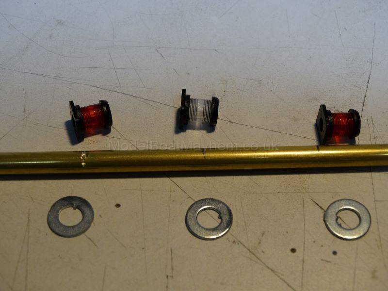

1st: The red/white/red ligths to show restricted maneuverability were not considered in the kit.
As support for later components a washer was soldered to the mast at each relevant position:
2nd: The overall length of the mast is planned at 330mm, which for me is way too long and not proportional to the ship:
So the mast was shortened by 50mm, which makes it look more suitable:

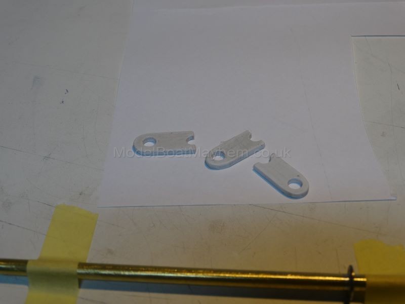

Three small holders to carry the additional lights were cut out of 3mm PS und then glued to the washers on the mast:
After adding the support for the radar the mast assembly looks like this:
So far the current state of the project.

Is it your intention to make the lights work? If so are going to feed the wires through the hollow mast?
Also I noticed that you have mounted the radar pedestal on the mast. Will you include a motor in the pedestal to rotate the radar array?
Great progress  :-))
Pauli
Speed123
  • Posts: 188
    • HAST Hobbyseiten
Hallo Pauli,
the intention is to make all four lights on the mast working by feeding the wires through the hollow tube.
The motor for the radar will be located in the wheel house and will turn the antenna via a small brass wire.
This is the plan. :-)

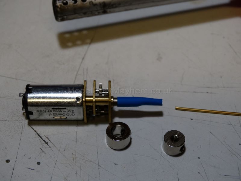

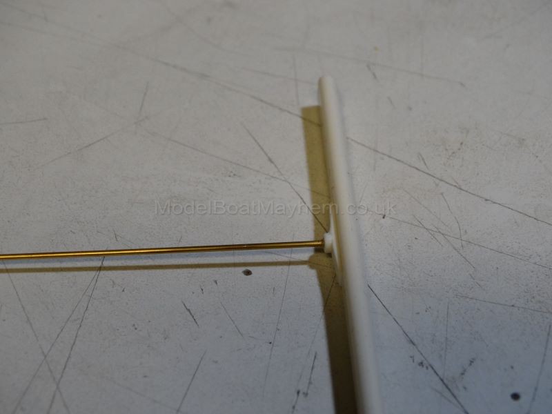

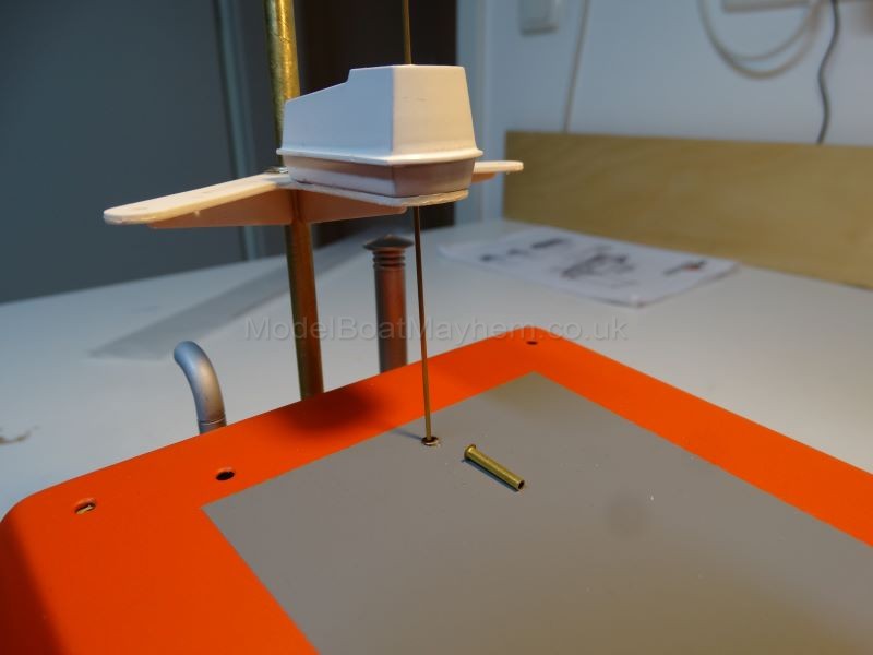

next step in the build is the driven radar antenna. As the box underneath the radar is rather small, I decided to drive the antenna from inside the wheel house.
At first the antenne received a 1mm wire as drive-shaft:
The kit contains some brass bushings, which can be used as bearing for the drive shaft.
One build into the box underneath the antenna:
And the second one is build into the roof of the wheel house:

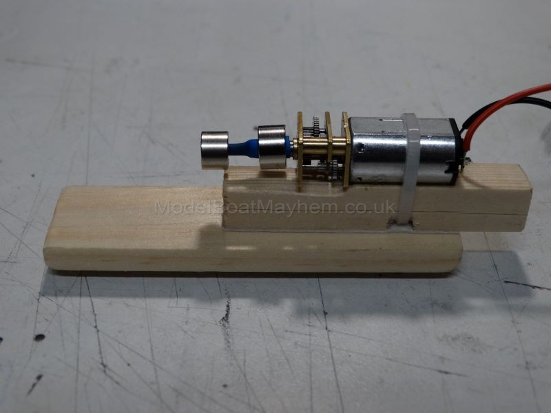

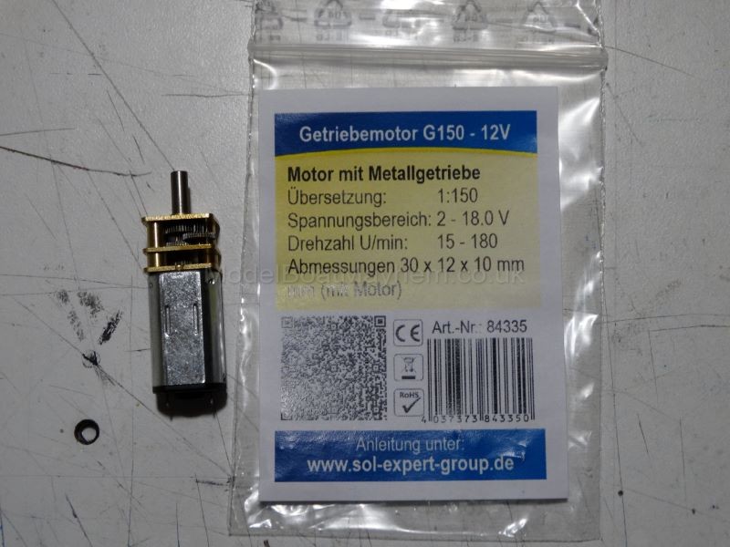

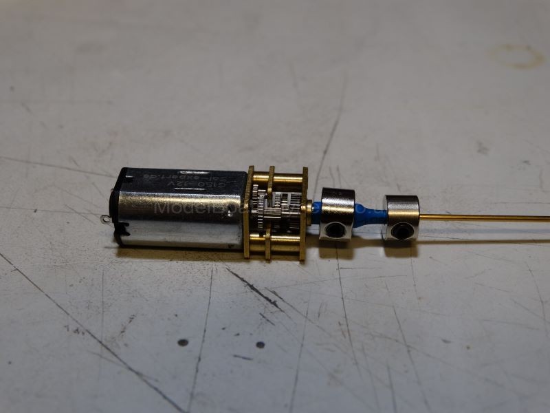

A small motor with gear redction serves as drive:
The coupling between both shafts was done via a shrink hose and two clamping rings:
Once the hose is shrunk to both shafts, the clamping ring are fixed and are transfering the "torque":

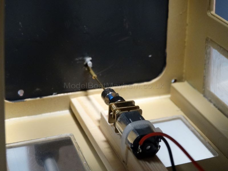

The motor is then mounted to some substructure suitable to be glued to the wall of the wheel house:
After fitting the assembly in heigth until both shafts are inline, it can be fixed and both shaft are clamped:
The motor is operated at 5VDC and the movement looks like this:
https://youtube.com/shorts/a8n2r2g6kqo?feature=share

Hi Hans,
Thanks for updating your build-log.
Very neat installation of the radar drive mechanism and your choice of motor and gearbox results in a very realistic rotational speed of the radar array.
Might I ask why you are powering it from a 5V supply as most batteries are made up from multiples of 1.5V e.g 3.0V / 4.5V / 6.0V etc. ?
Anyway, great progress - looking forward to your next update  :-))
Pauli
Speed123
  • Posts: 188
    • HAST Hobbyseiten
Good morning Pauli,
The ship has source of power; a 6-cell 7,2Volt rechargable NiCd Battery.
I have an adjustable step-down converter set to 5,6 Volts and have everything that is supposed to run
at 6Volts hoocked up to it;
My idea is to run lightbulbs, LEDs, Foghorn and other with this reduced voltage given them a longer life.
I just do not want to exchange a bulb at the mast for example.
As for the radar motor - in order to get e decent RPM -I have reduced the feeding voltage by another 0,6 Volts using a
Zener diode.
Hope this not too confusing.
Best regrads
Hans
