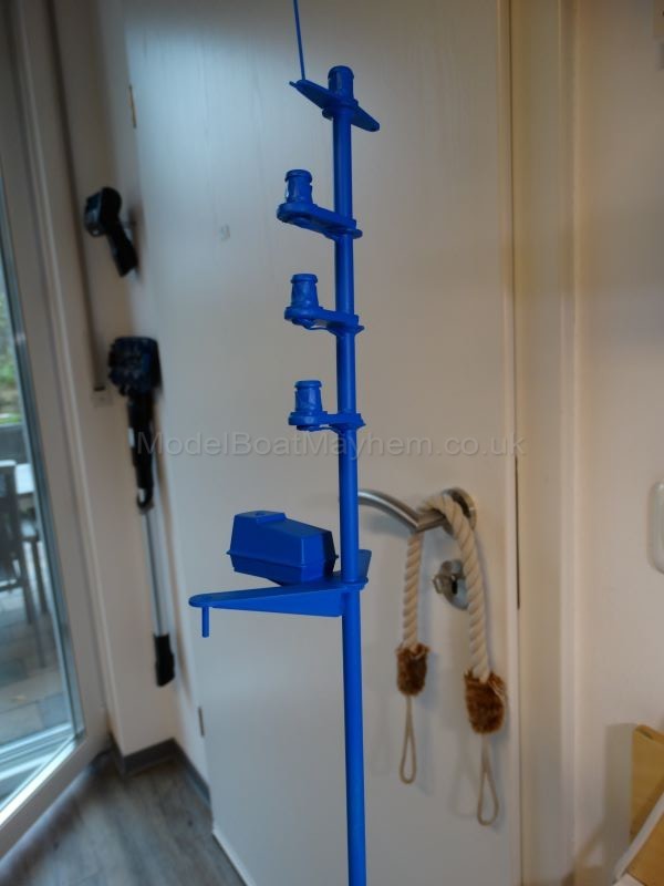

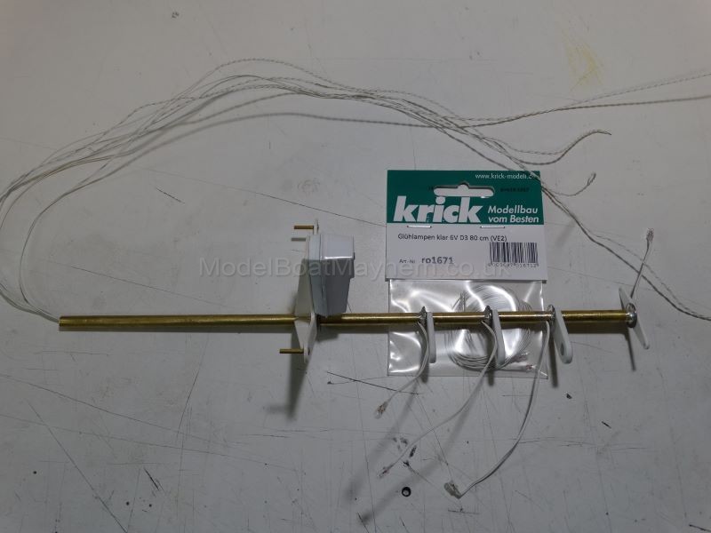

Hello,

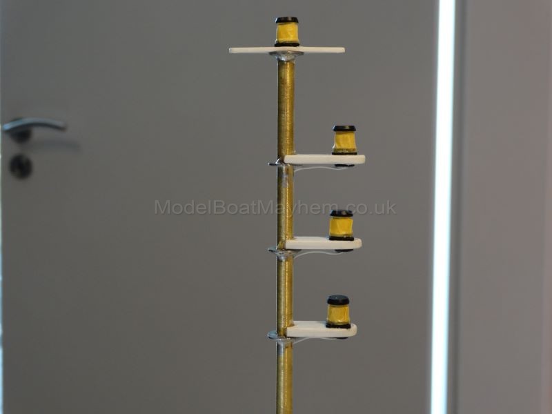

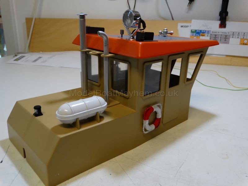

next issue is finishing the mast.
At first the wires for the bulbs needed to be fiddled into the mast (was easier than thought of):
The housing for lights were taped and then glued to the holder.
The wires were fixed underneath the holders:
After spray painting (primer and top coat) the mast is ready for assemby to the wheel house:
Last details were mounted to the wheel house (position- and search-lights, horns, safety equipment):
Once the mast ist set to the wheel house wiring will start.

By the way, that's a nice chrome search light on the cabin roof - was that provided with the kit or did you source it separately?
Pauli
Speed123
  • Posts: 188
  • Location: Gerderath, Germany
    • HAST Hobbyseiten
Hello Pauli,
the search light was part of the kit and has room enough for a decent light.
Best regards
Hans

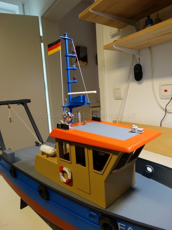

Hello,

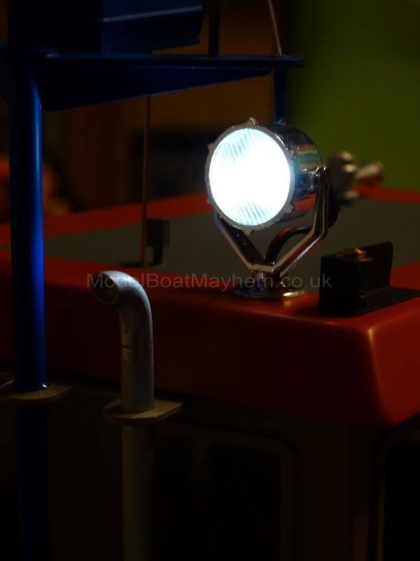

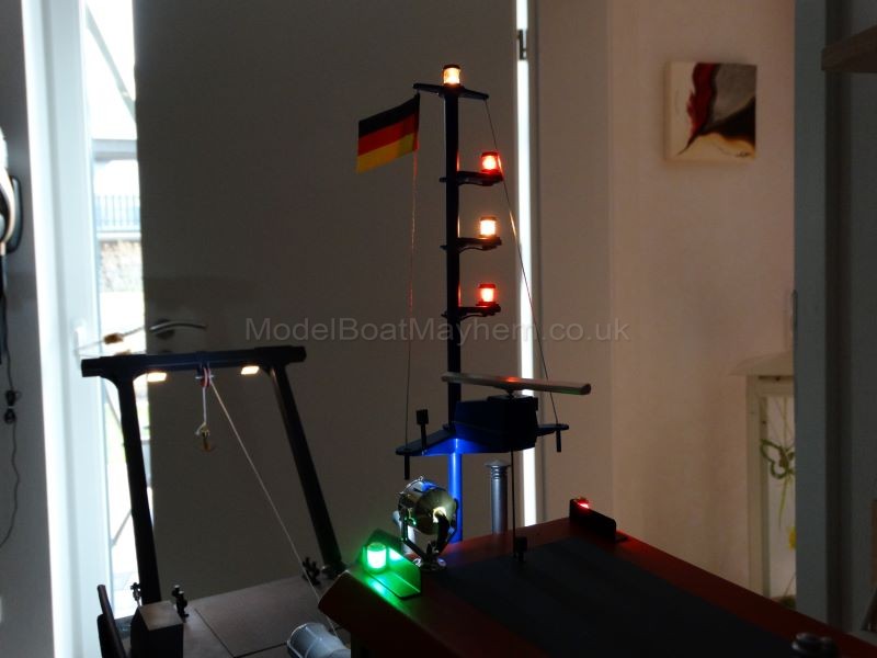

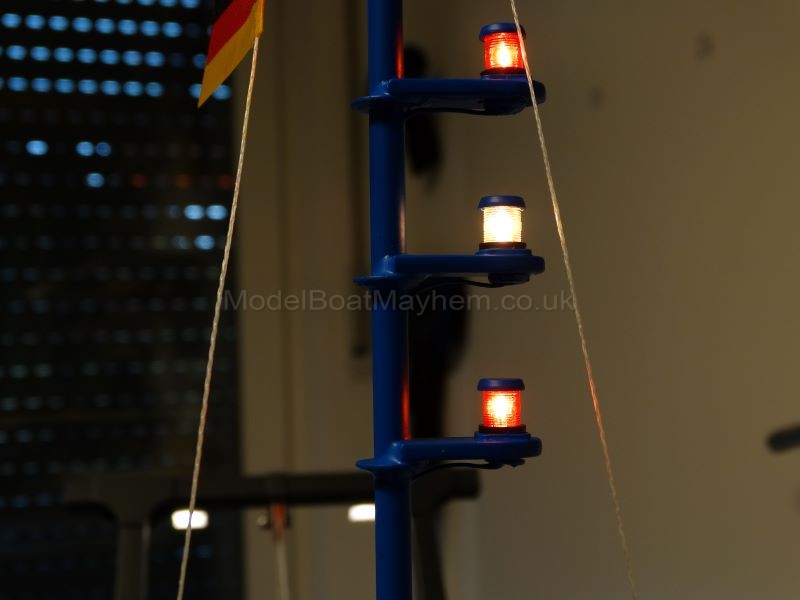

Yesterday the mast was mounted and fixed:
All lights were wired and tested:
The search light came out strong enough to act as such:
So far the installed illumination:
two working lights at the crane
navi lights (stb, port, top und rear)
three signal lights
one search light
The working deck in the rear has not enough illumination; two working lights will added.

Do all of your lights use incandescent "grain of wheat" bulbs or have you used LED's in any of them?
Also are they all powered by one switched supply or are some switched individually?
Thanks for the update - looking forward to the next instalment of your build.
Pauli
Speed123
  • Posts: 188
    • HAST Hobbyseiten
Hallo Pauli,
Stb, port, and search light are LED, the other are lightbulbs,
Three "groups" to switch:
a) Search light
b) Navigation lights
c) Signal- and working lights
Best Regards
Hans

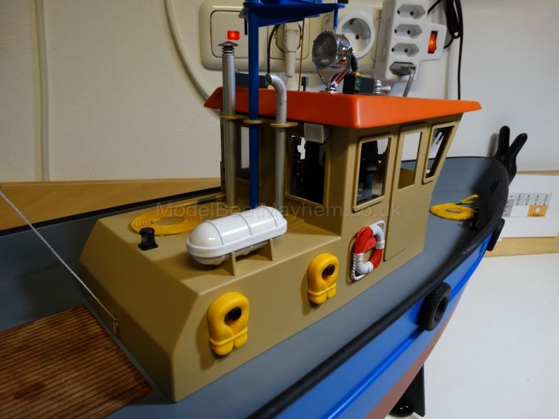

Little progress to announce; some details were added to the ship.

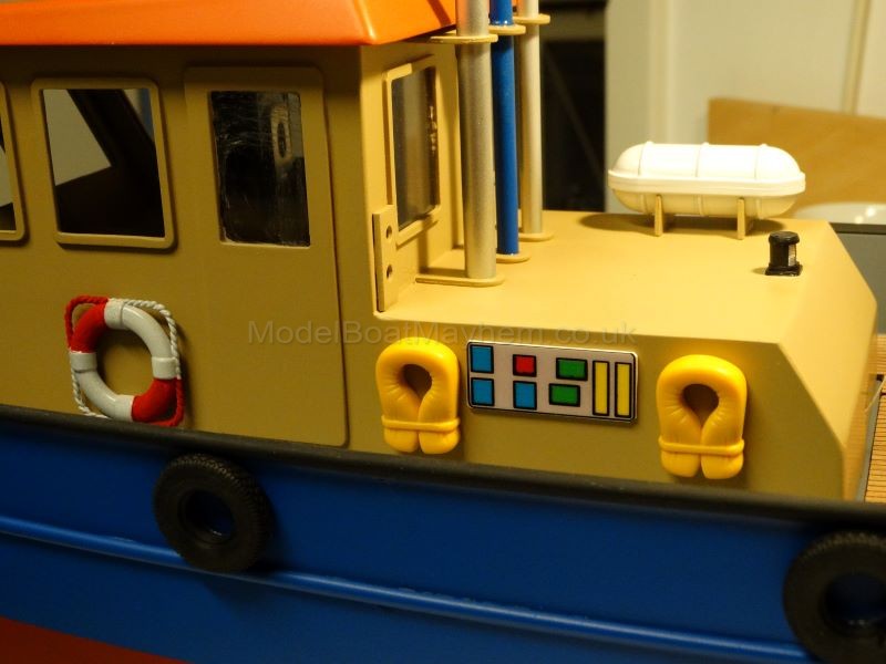

Lifebuoys and life jackets were installed:

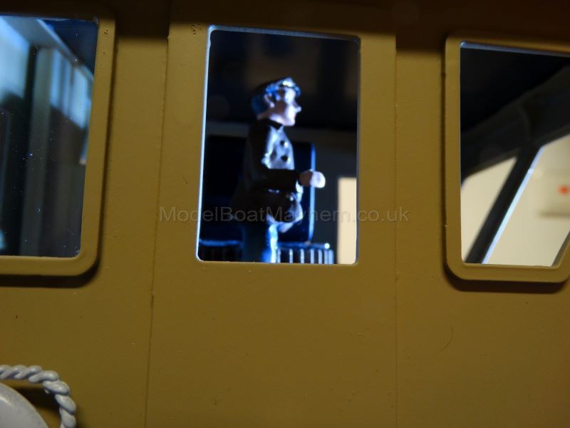

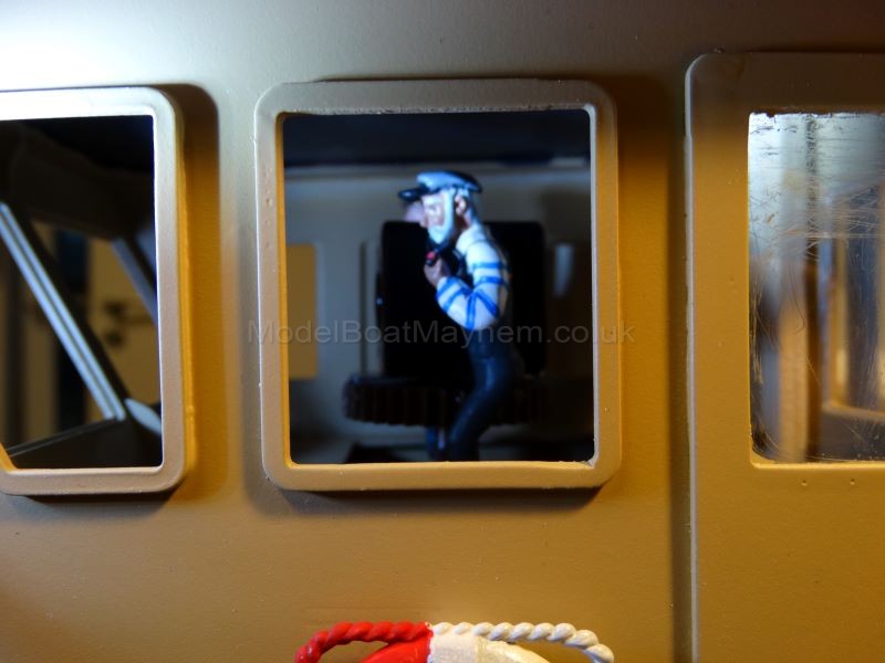

Captain and helmsman arrived in the wheel house:
Little Hein still has no work and is waiting....

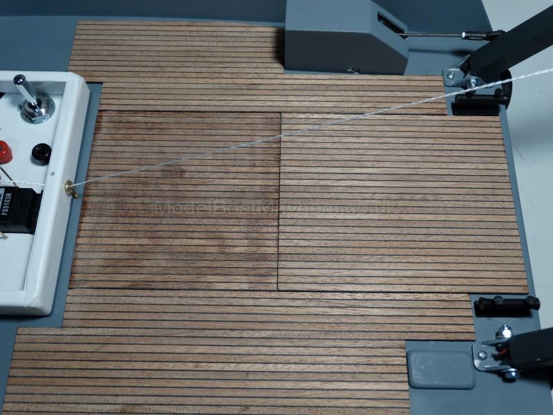

The working area will now get a wooden surface. The cutting of the sections is in progress:

Your wooden decking looks very realistic - was it provided with the kit or have you sourced it separately?
Pauli
  • Posts: 24,027
Crew seem happy enough!    :-))
Speed123
  • Posts: 188
    • HAST Hobbyseiten
Hallo Pauli,
the wodden decking was not part of the kit; the idea just came 2 weeks ago and I had to buy it > at www.Krickshop.de and search for "boatdecks".
Best Regards
Hans

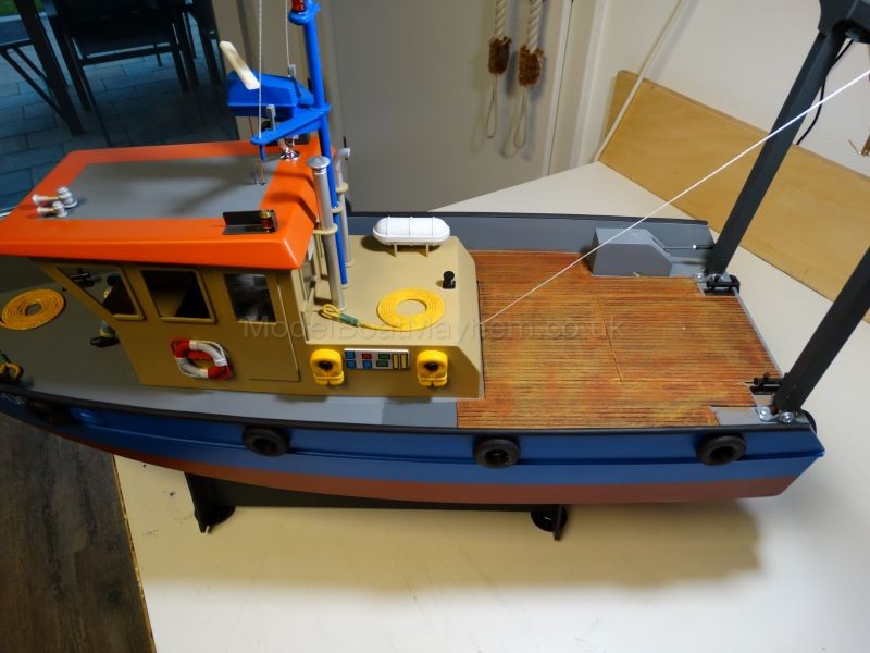

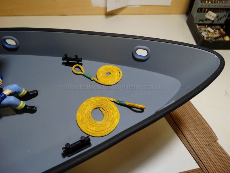

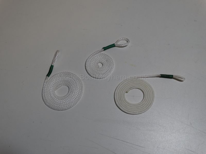

Little progress last week;
Made a few ropes:
and placed them after painting on the deck:
The holders for the lifevests and two flood-lights were added on the wheel-house:
Best Regards
Hans
Whoever finds spelling errors can keep them.
My YouTube Channel
My Homepage

The ropes are a nice touch - did you dye them?
By the way, I was wondering how the wheelhouse is attached to the deck - is it just a push fit over the raised coaming around the main access hatch?
Kind regards,
Pauli
Speed123
  • Posts: 188
    • HAST Hobbyseiten
Hi Pauli,
the ropes were just brushed with paint.
The wheel-house fits very good (tight fit) to the coaming and does not need any additional holders.
Best Regards
Hans

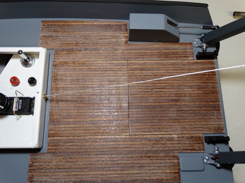

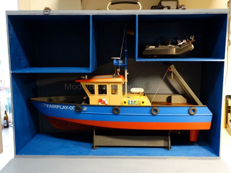

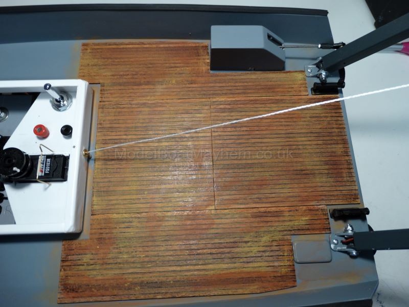

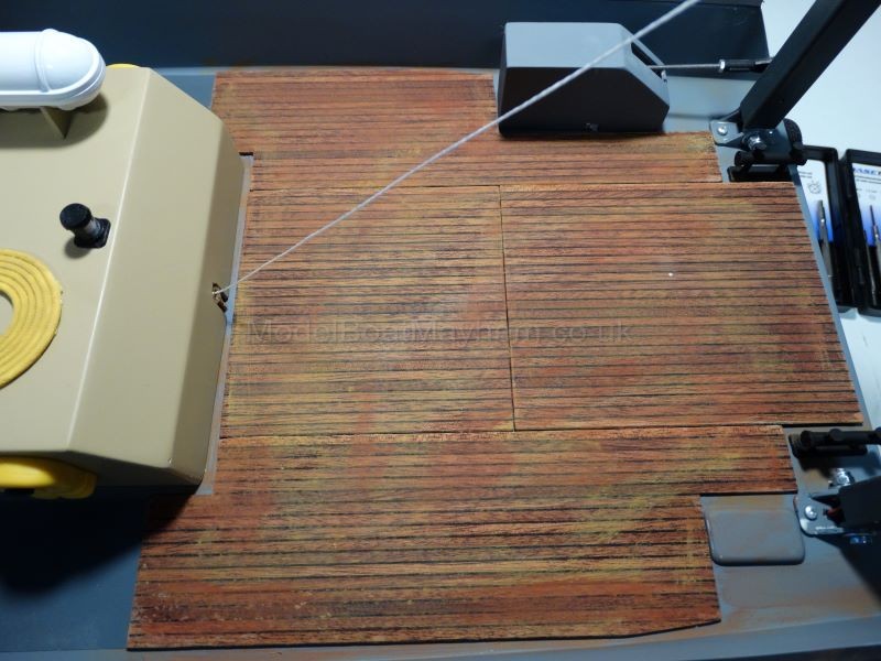

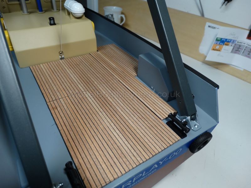

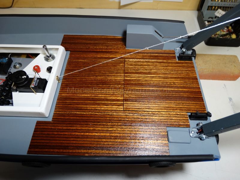

in this week the wooden working deck was finished.
it consists of four sections cut out from a Boatdeck-panel sold by KRICK:
In the next step the deck was drained with special paint for wodden boats and after a few days of drying ist was ground.:
next step was weathering with some suitable colors and sealling with a coat of flat clear:
The overview looks like this:
Also finished is the transport/storage box for the model:
Next is the first real test in the water > waiting for some hours with decent sunlight somewhat higher temperatures.
Best Regards

Hi, the aft deck looks much better than supplied with the "humps" to fit the buoys.  Is that an F14/16 transmitter tucked up in the last picture?

Thank you for updating your build log - the weathered decking looks very realistic  :-))
Do you intend to mount the Romarin / Krick buoys on the deck or are you going to use different buoys or perhaps you have another use for the crane mechanism?
Kind regards
Pauli
