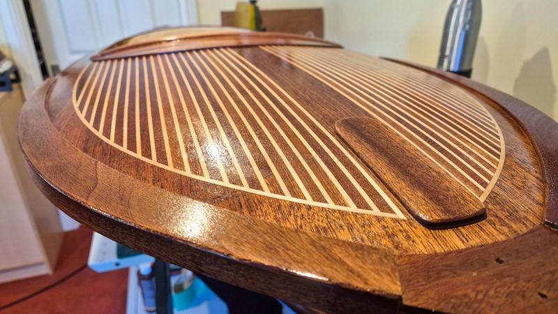

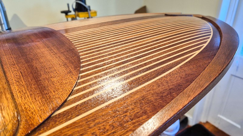

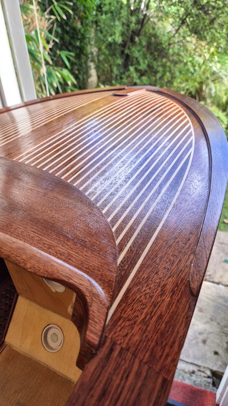

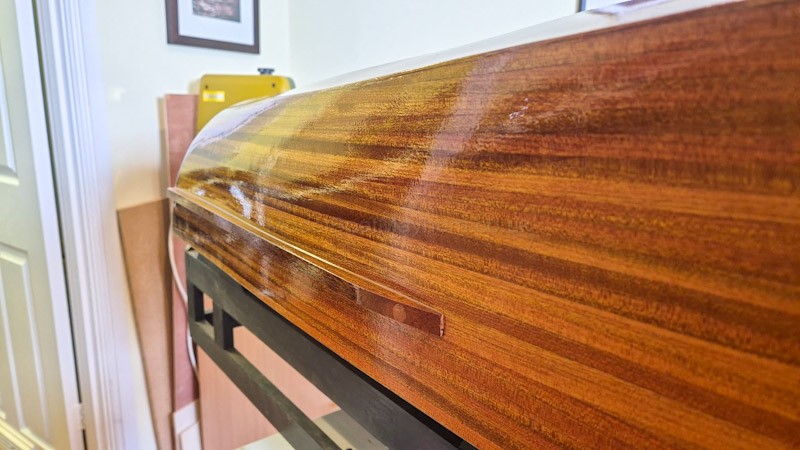

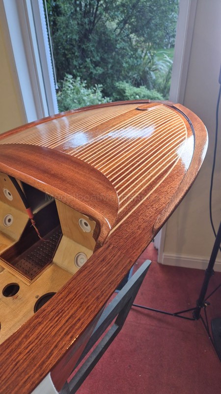

Short update.  Here are a couple of pics of the third coat of thinned epifanes:
I applied fourth coat yesterday afternoon, still building up some depth with just a rub over with scotchbrite between coats, so far so good.

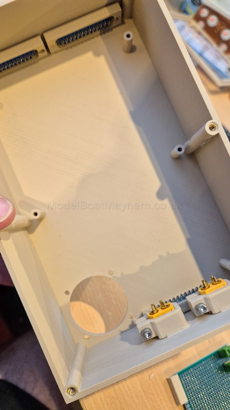

Also been working on replacing the two electronics boxes.  3D printed this time so I can build in component supports, connection ports, cable routing and using better (more robust) connectors.
Pics to follow.

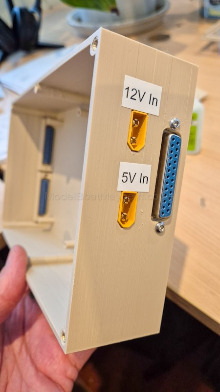

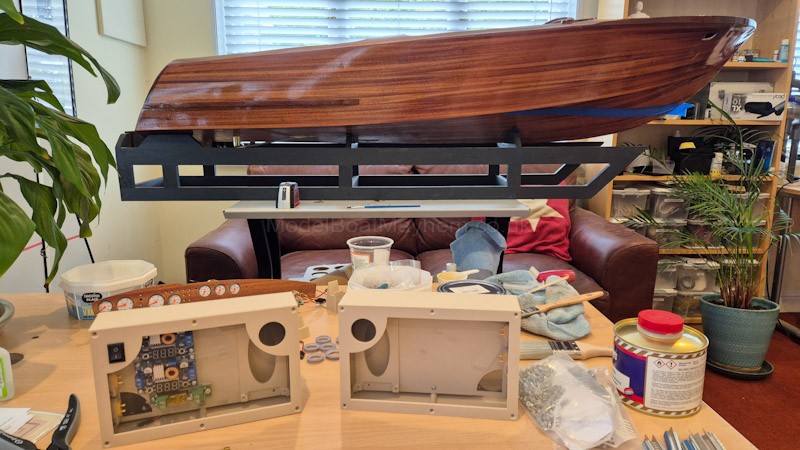

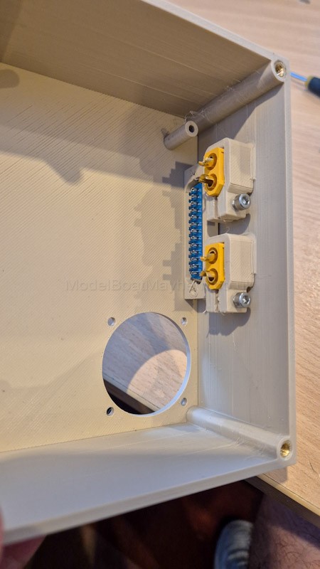

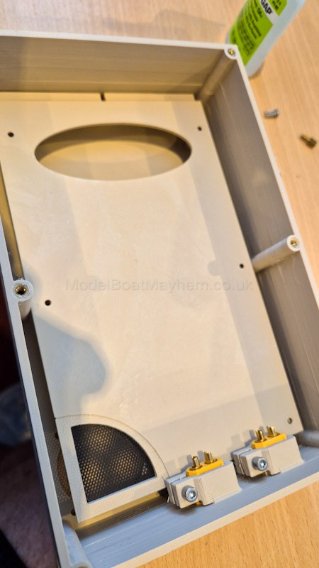

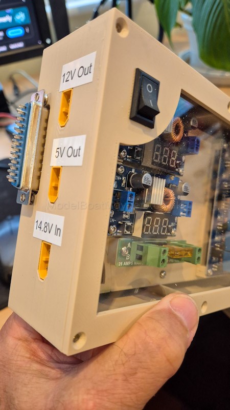

Some pics of the new electronics cases, they sit port and starboard of the LiPos and are powered from a 4S LiPo, then voltage is dropped to 12v and 5v in port case and made available to modules in both cases:
And a raised floor to allow the cable routing underneath the modules:
Both boxes, and a gratuitous picture of the shiny mahogany after fourth coat...!
