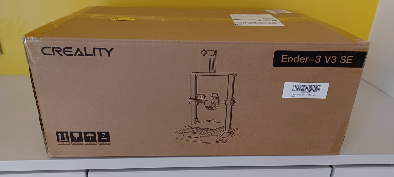

Does Creality will have their own slicer ?
BTW, this arrived today! - Ender 3 v3 se
 Thinking about it, maybe I should have ordered a couple of rolls of filament!
NB: Good / best ways to store filament?
