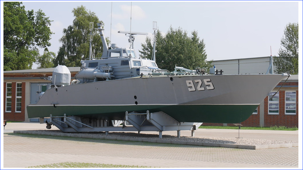

Hello everyone, I begin a new project a torpedo boat from VOLKSMARINE (DDR) during Cold War (5 crewmen). I bought the hull and the deck from a German craftsman. the hull is made of fiber and is 1.26 m long (126 cm).  but I hace a question about the diameter of the shaft. Can you tell me what the impact is of an M4, M5, or M6 diameter? So far I have always used M4 but I wonder if with the length of the shaft there is no more risk of vibration with M4? That’s why I wonder if M5 is not a good idea.For the moment,  I do not yet know which engine will be installed but without being an off-shore it's a very fast boat. Thank you for your help.

It sure does have 'great lines!
  • Posts: 9,555
Re: torpedo boat VOLKSMARINE
« Reply #2 on: July 10, 2022, 04:13:16 am »
Very sharp O0 ...does it throw or launch the torpedos from over the stern?.....

Is the stern weapon a twin 14.5mm or ZU23-2 cannon?
yes, torpedos were fired from the back of the boat and goes forward. I suppose, the boat must turn quickly after firing torpedoes !!
yes it is
