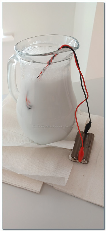

Well, nearly got it finished for Wicksteed ... but, in the end, the fates conspired against me ....
But this happened:

« Reply #129 on: May 26, 2023, 08:47:38 pm »
You will have to explain that.

« Reply #131 on: May 27, 2023, 06:11:17 am »
But this happened:
Is that your version of  running in the brushes?!

« Reply #132 on: May 27, 2023, 10:21:10 am »
ChrisF, in a car it used to be called 'running in', surprising how much carbon can be 'Discarded' from the brushes converting them from flat ended to concave to fit the 'Comm'.

Re: Club 500 Build, 2023
« Reply #133 on: May 27, 2023, 10:43:09 am »
Is this for real? I thought water and electricity shouldn’t mix!  :o
« Reply #135 on: May 27, 2023, 11:49:09 am »
At low voltages you can get away with it. Water actually isn't a very good conductor but the impurities in it can be. This is why saltwater is a much better conductor than fresh water.
For high current use, like a Club 500, we used to run the brushed motor in under water and with 2.4v for around 20 minutes. Not sure how much good it did but it was a routine that we all followed and it certainly made nice black water.
It looks like Martin has used washing up liquid, or something similar. We didn't do that!
« Reply #136 on: May 27, 2023, 11:50:45 am »
You learn something new every day!
Stu - with some models they actually have the motors with a prop attached running in the water.
« Reply #138 on: May 27, 2023, 04:24:41 pm »
Yes - but the motors are inside the boat  {-)
  Er, nope.
« Reply #139 on: May 27, 2023, 04:29:18 pm »
Not uncommon to have brushless hanging out the bottom of the boat for fresh water use. Corrosion of the bearings is the only thing to deal with (blow out & dry + oil after use). Brushed motor immersed in water is less common other than small coreless motors in micro models.
