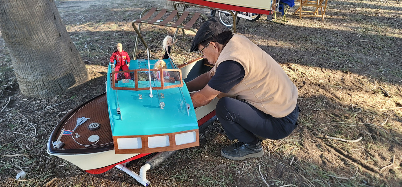

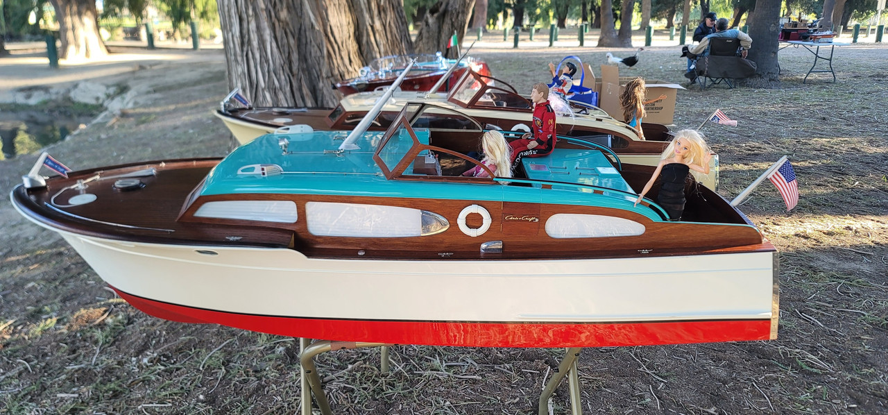

  • Posts: 24,041
Re: Lindberg 1/20 Chris craft Constellation build
« Reply #69 on: November 16, 2023, 04:34:33 pm »
Found this Facebook....  :o
Backerther
  • Posts: 1,353
  • Location: Japan
« Reply #70 on: November 17, 2023, 01:47:01 am »
Thanks for nice pics, Martin !!  :-))
Judging from the figures aboard the boat and a 1/1 living figure, theirs look much much larger than mine...around 1/10 or more?.. O0 {-)
By the way, mine is nearly complete. The rest I should accomplish successfully is a long-waited maiden voyage except which this is not to be called a "RC boat" by my standard, but it should be merely called an easy "RC-able pla-model boat" to build. O0 {-) %%
