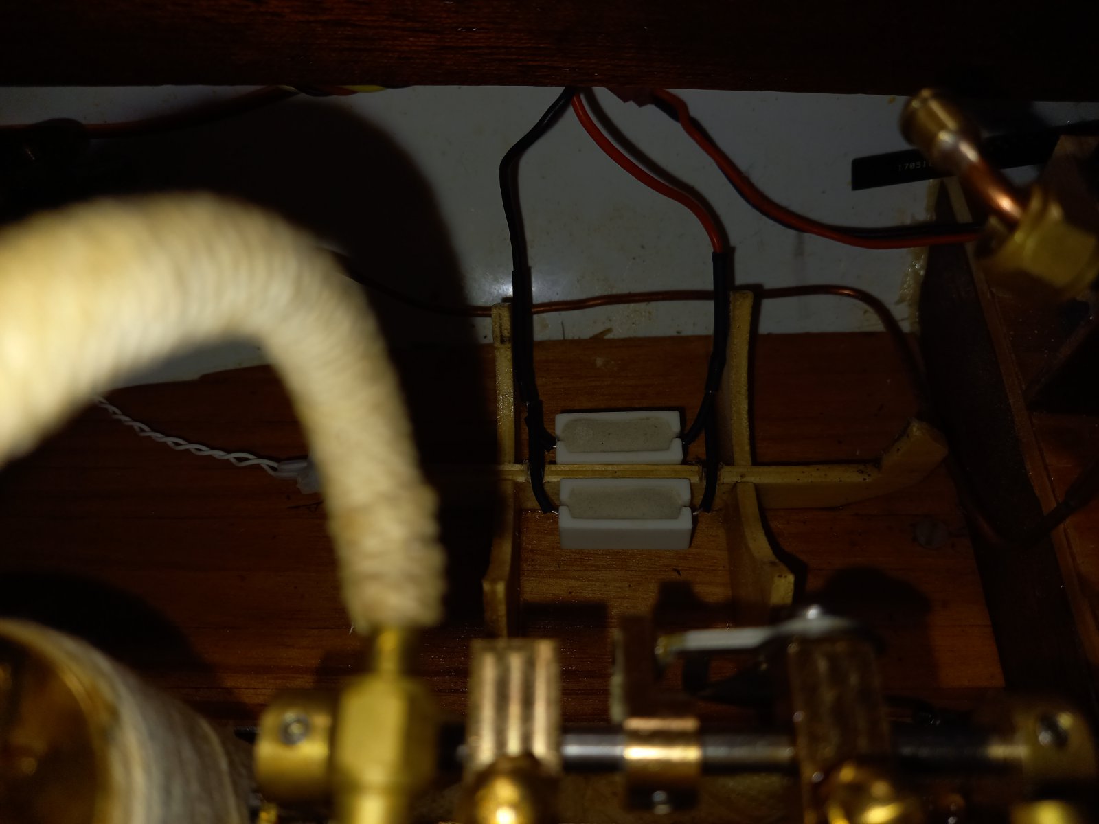

Right now, I am thinking that probably the easiest will be to Epoxy a 5W resistor to the tank, and heat the tank electrically (5W is approximately the heat needed to evaporate gas at the rate of consumption). Not sure if or how I will solve that, but at least it will give me the possibility to somehow "control" that heating via telemetry. I still have one unused temperature channel that I can use to switch that heating based on the fuel line temperature.
But I don't particularly like that "solution" when there is literally around 200W of unused waste heat availlable.

I found an old HobbyKing combo of regulator, switch and voltage display all in one, and decided to install a 2S 2200 mAh LiPo. That way I have a constant voltage for the feedpump.
with the NiMH there is a voltage drop of about 15% during discharge, meaning the feedpump will run slower at the end of a battery charge.
And since that LiPo contains 16 Wh as opposed to the NiMH only 9,5, suddenly there is a bit of capacity to spare to add electric heating to the fuel tank.
5W should do it.
So here's the battery

and I integrated a temperature sensor (for start/stop of the fuel cell heating) in the cradle of the fuel tank
https://www.modelbouwforum.nl/attachments/20231019_230659-1-jpg.557390/
The switch for that, the sensors, connectors etc, I still had lying around, all I need is one or two resistors that I can epoxy to the fuel cell.

Meanwhile the switch and telemetry-function to activate that switch have been insalled/progged, waiting is for a few "cement resistors" to heat the gastank.
Curious what it will bring...
Well... resistors have arrived, and installing them took all of about 10~15 minutes:
https://www.modelbouwforum.nl/attachments/20231021_153633-1-jpg.557527/
I still need to finetune the setpoint, protect the temperature sensor a bit better against external influences, but it works fine.
As long as I set up the control such, that the gas tank maintains about 13 degrees Celsius, gas pressure remains high enough for the burner to have some headroom maintaining steam pressure at full ahead until the last drop of gas.
Works excellent, heating switches on and off on demand, the load on the LiPo is not at all noticable in the onboard voltage, and I think there is about 2,5 hours of safe steaming in the batterypack.
I'm happy...
I'm happy...
It is easy to say "yeah, it works"... but HOW well does it work?
In the end, I did three tests of each approximately 50 minutes, taking notes every 3 minutes and changing speed every 3 minutes at the same time.
The notes were speed, gastank temperature via telemetry, and gastank temperature via IR thermometer.
First test was without heating installed. I alternated between dead slow, half and 3/4 speed (and I take care that those speeds every time use identical throttle valve positions of course). In the middle of the test, one single run full speed (3 minutes) was done. During this full speed run, the burner near immediately went to 100% and thus boiler pressure dropped below controlled range. Fuel consumption over 50 minutes was 42 gram (fairly normal), and the lowest temperature  of the gastank was about 5,5 deg C (ambient at the time was 15 degC). After the full speed run halfway through the test, the burner barely managed to keep up with 3/4 speed, but the gas temperature slowly crept back up to about 7 degrees C. Despite that, performance of the burner system noticably deteriorated (identical engine speed required progressively increasing burner outputs).
This first test showed poor correlation between telemetry read-out and IR measurement, Most likely because the waste condensate receptacle is near to the temperature probe affecting this read-out. So I placed an insulating cover made out of Balsa over the probe.
2nd and 3rd test were done the same way, BUT only alternating between half and 3/4 (no more dead slow periods) to keep up the fuel demand, and full speed runs at 15 minutes, 30 minutes and 45 minutes approximately.
Because of the insulating cap over the probe, correlation between telemetry and IR measurement was improved to the point of "usable" but still not great. Heating switched on and off during the first part of both tests, and basically remained on after approximately halfway, so there IS some form of control, but it's a bit ambiguous and I could not really see a firm correlation between boiler load and heat demand.
The setpoint of the heating was chosen such that it switched on around approx 13 degrees actual (IR) tank temperature.
Results were positive: Both tests the burner remained below 100% output even during the last full speed run (albeit barely) and in fact, during the 2nd test the burner ran out of gas within seconds after the last full speed run. Just poof, empty, sudden flame-out, no gradually dying fire: I reduced speed to half, burner responded by reducing fire, and maybe 30 seconds later the flame extinguished without first growing smaller. Just like that. Rather surprising actually, hadn't seen that before.
Both tests the IR measured temperatures by and large remained around 12~12 degrees, with outlier observations of around 9 degrees.

Destilled water contains nothing.
But BECAUSE I use destilled water, I don't want to waste it, so I leave the water in the boiler between regular use, as the water quality remains within acceptable limits for at least 6 or 7 hours of steaming. I replace every 4 hours or so, to stay on the safe side.
As it is, I still have zero scale in my boiler, as far as I can see.
A destiller can be bought for as little as 75 Euro new (if you pay attention and shop around). I run my destiller in the weekend, when electricity is cheaper, and especially in winter the water then is for free because that thing produces a fair bit of heat, enough to make the central heating switch off, so I am not burning any gas to heat my home...
I don't use (even don't HAVE) a whistle, it's a waste of steam that I rather use to push my boat 5 cm through the water :D :D :D  (just kidding... Being used to ships horns, I don't like the shrill high pitched sound of steam whistles).
I normally leave the gas in the tank, but not if I have to leave my home for 2 months. You never know what will happen, I prefer to have my gas stored in approved containers when I'm not home.
