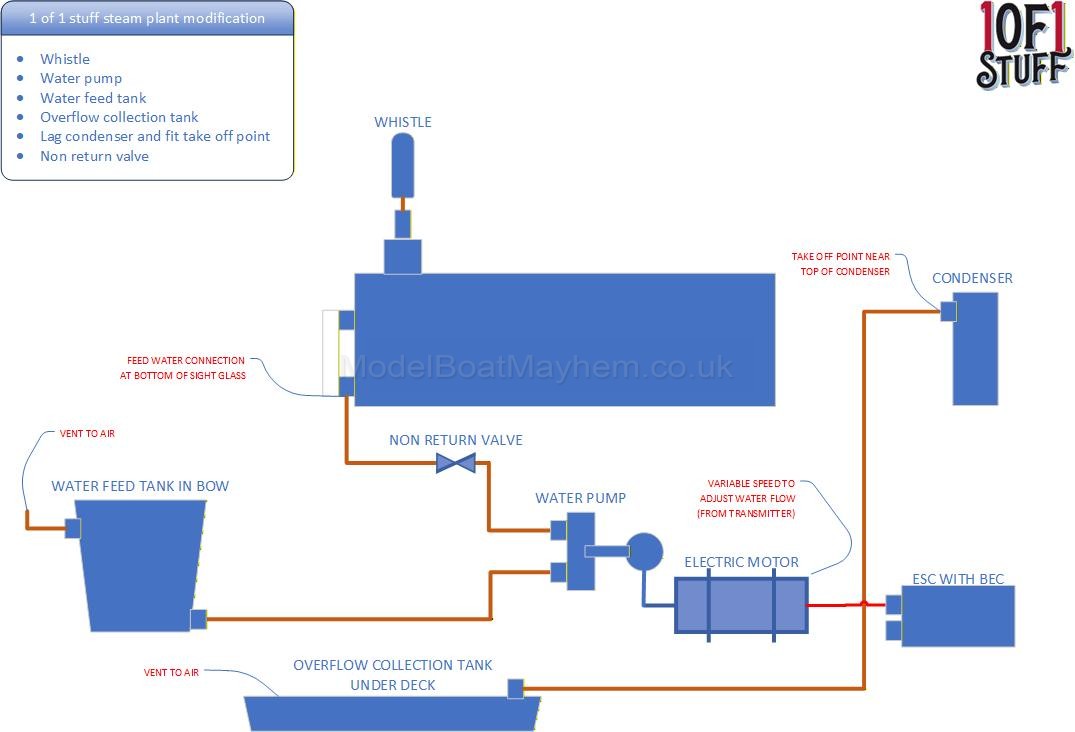

TomF
  • Posts: 72
  • Location: Basingstoke
    • 1 of 1 stuff
Thanks again Brutus. Here is a diagram of the updates I propose doing.
Steam-plant-modifications.jpg" border="0
Motorcycle, mechanical, models and electronic projects.
1 of 1 stuff
https://1of1stuff.com
1967Brutus
  • Posts: 550
Looks perfectly fine to me, APART from the condenser drain: that one MUCH better comes from the bottom of the condenser vessel. The more space availlable in that condenser, the better its oil-separating properties.
If you make that line 1 mm inner diameter, that will act like a throttle, minimizing the loss of steam via that point (the steam will heat up the collecting tank, and wile the tank probably won't care, it might cause issues with other components in the vincinity such as receivers, servos, batteries and what not).
Gotta say, I like your style of pre-planning... I am too chaotic in my head to do that but it could have made Ravika Putri a lot tidier if I had...
rhavrane
  • Posts: 1,039
  • Steam passionate collector
Bonjour Tom,
What you call "non return" valve is what I call "Check valve"  :-))
Never mind, your plan has however a possible limit, the size of your water feed tank (this is my problem with my boats which have one, example : https://youtu.be/oLnyl0zLZOE).
I have noticed that dust either floats or sinks, so when I take the water at the bilge, I find no dust in my little water filter. And I use RC car filters, example : https://youtu.be/UKRDUUG4dxI
Raphaël
