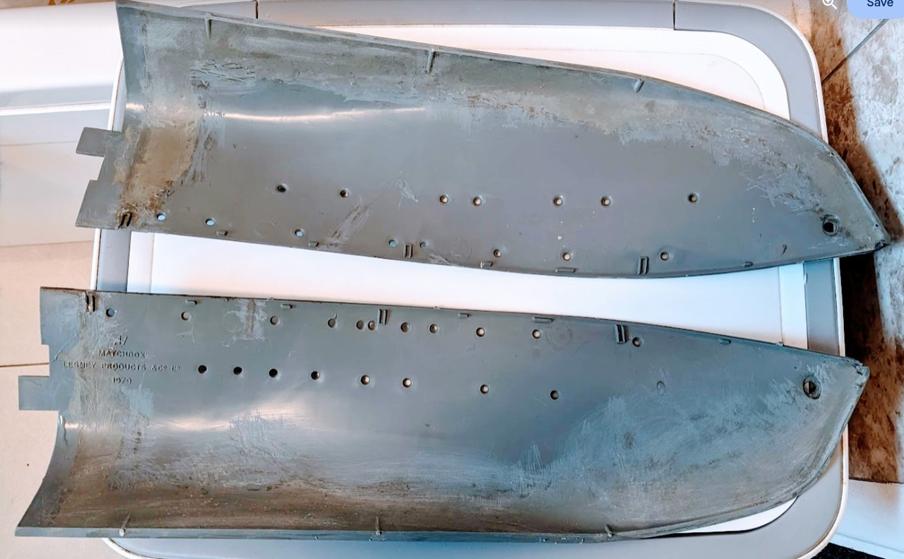

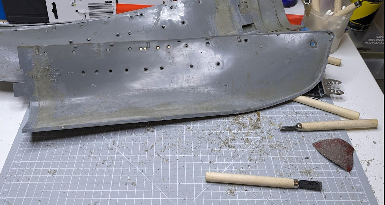

Started scraping the old glue off this week.... what a tedious job that is!!!
Here we go again .... Recommendations for Matchbox Corvette hull joining glue / adhesive / epoxy?

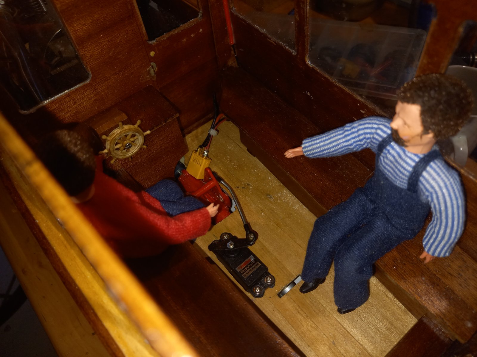

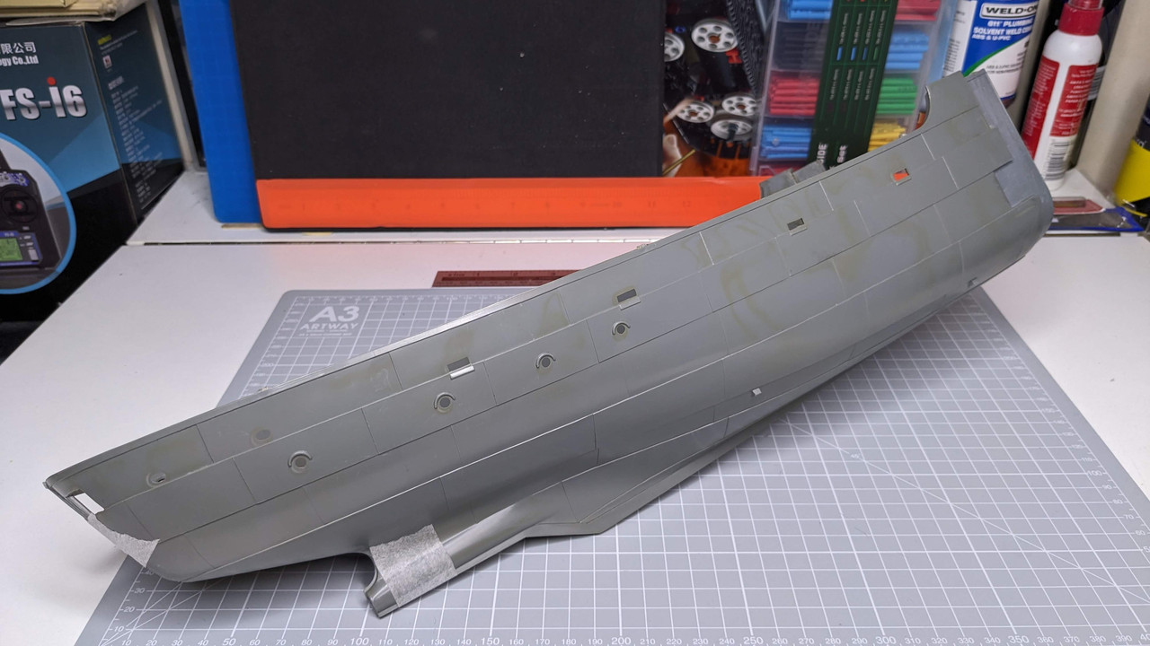

Heres mine, a picture of that 'soft' area just above the prop shaft (the rudder is plasticard stuck to a brass off the shelf)
You cannot see the joint as in the past I seemed to have painted the inside.

Cleaning up these hull segments is a slow, messy & tedious job .... No surprise there then!

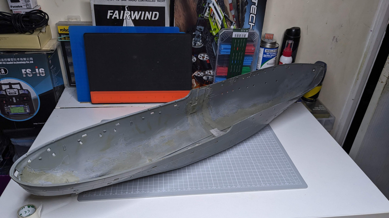

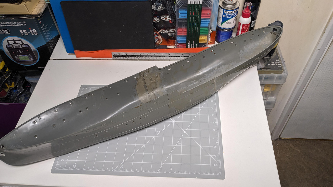

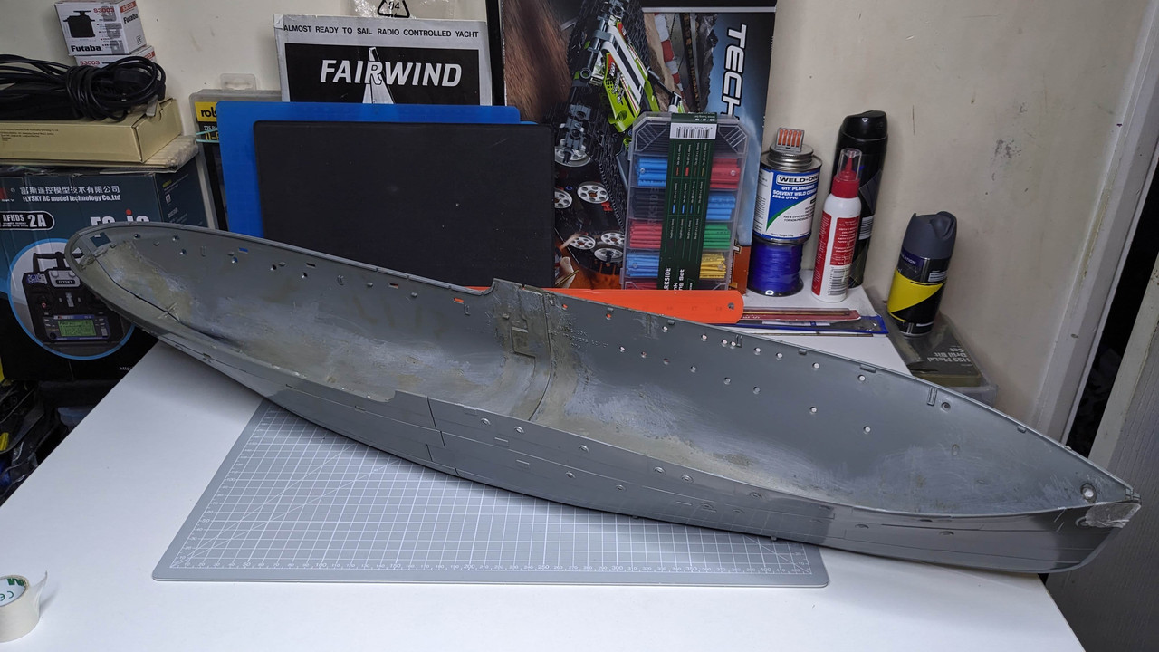

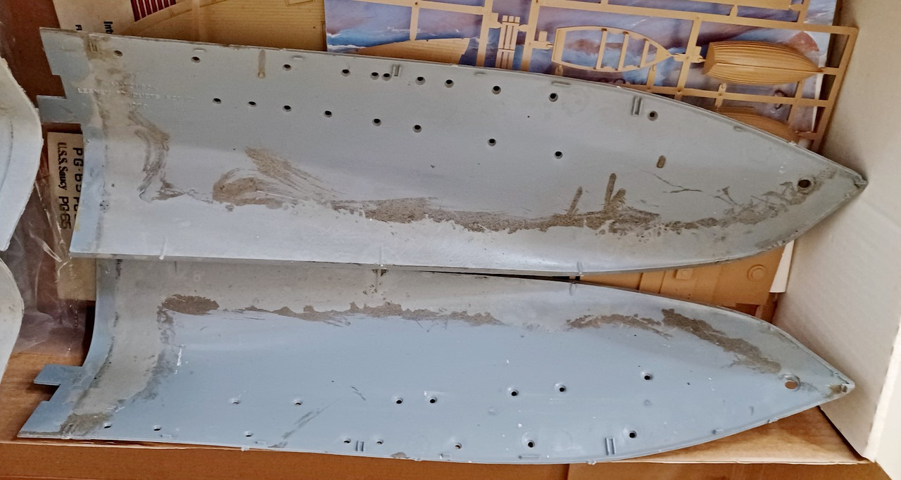

 Got quite a few hours in today, clean up nearly complete!
 A few areas still to do, like the glue edges. I want all the Matt flat, to give the poly cement the best possible chance to grab.
 I think I can see why the kit was completed, the "glue" used, must have stated to come apart very early on as some just peeled
 right off with very little effort. Also some sprue edges were not trimmed at all, the glue surfaces not 'keyed' at all & looks like
 glass fibre reinforcement matting didn't take at all, leaving this mess to clean up, leaving him pondering what to do next
 and how to clean up the mess .... or leave it to another time ..... or someone else to clean up!
