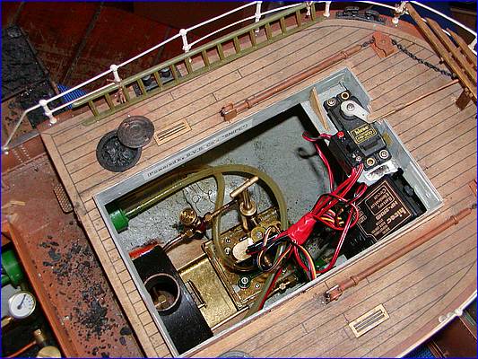

Here are some pics from Mayhem...

Where can I find out more about this Minivap that Martin has in his Puffer?

I'd like to know how that boiler is supposed to come out!

« Reply #19 on: November 25, 2007, 10:08:14 am »
It was the pump and the fact he had lifted everything up to run the shaft UNDER the boiler and engine and it was no where near the waterline and had not fallen over.   (yet)
