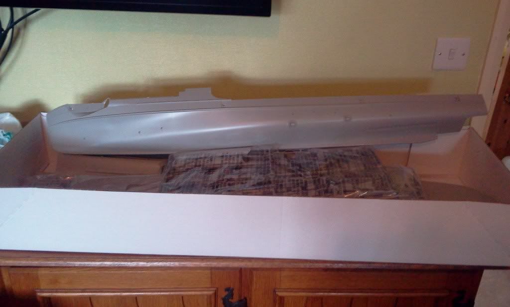

right wereto start,ok this daft idea came after seeing a partially built one on ebay,i made a bid on it highest bidder but did not reach the lads reserve, tried contacting him but i never got a reply  >:-o, so after watching for a week i had it in my head i was gonna build one of these one way or another, so scouring the web i found them varying from 90 quid to 125 quid, after five fruitless further days trying to contact the shop selling atthe cheapest i gave up, then i found a company called relish models( hope names ok mods )  they had an online helpline, so working off the maxim them that dont ask dont get i asked if they would price match, apparently normally not but what did i want, well it was this kit and the eduard full etch set, i told him i wanted to pay 100 for the kit inc postage, he agreed  :-)) then i asked forthe `big ed` etch kit, total came to £131.49,pays with my debit card and then wonders if i have done the right thing  {-), i knew the etch was out of stockbut tit would arrive the next week, so forwarda week and theres a knock onthe door, courier with a small coffin  %%, pics below, thats a 52inch plasma on the wall
kits photo etch
add to it this lot from eduard
