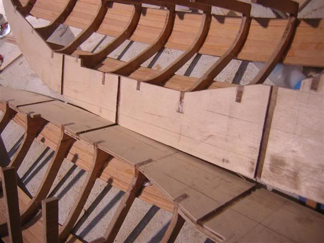

Another point about correctly tapered planks the novice model planker does not appreciate, is that by tapering the planks correctly towards the bow and stern the plank cross sectional area is proportionally reduced and so aides in bending the planks around the frames where it is most needed.
Great job Labougie - very tidy indeed, but you need to concider how you are going to marry the top side planking in the rabbet at the bow with the bottom planking that has no rabbet.
May I suggest you bring the topside rabbet out a little and sweep it down to just back from the nib ends of the bottom planking. This allows you to sand away the step you will get on the bottom planking as it matches the rabbeted planking which will be deeper set in the stem. This way you will be able blend things with the planks in the rabbet and present a smooth even face at the transition.
labougie
Re: Colin Archer
« Reply #26 on: October 23, 2009, 05:33:16 pm »
Tiger - the planking is actually 3/32" which is 2.38mm.  I originally bought a couple of 1/8" planks and it was obvious just by offering then up to the ribs that they were going to be much more difficult to fit. I'll use them for the rubbing strake.
Decoy - the rebate was suggested by Tiger and with hindsight it's essential for strength and aesthetically much more pleasant.  There is already a fairly decent fillet of epoxy behind the rebated joints and the plan is (once all the planking is done) to cut the internal keel down to a bare minimum so that I can get good access to all the inside planking, give it a really good roughing-up and run additional fillets of epoxy into all the rib/plank joints as well as the rebated ones before covering the inside with glass tissue and polyester resin.
"No Pins" was a policy decision - given that I'm going to clear finish the whole thing, I wanted to keep the planking as clean as possible so I'm just using 1/ plenty of mini-G-cramps 2/ the wedging jig pictured further up this post and 3/ lots of time.  I'm usually managing to glue up stations 4-7 at the same time, then working outwards one or two ribs at a time. It's slow, but I'm fortunate enough to have the time.  I just now put three shaped planks on 4-7 at the same time because they fitted so well and it was a mistake - I'm going to have to invent some new clamping solutions to get the first and second of those planks down on to the outer ribs while the other planks are in the way!
The planking is spruce, bought in sheets from the local model shop then cut down and cleaned up as shown further up the post.
The latest plot is to forget about the Billings bulwark rail and extend the planking up above deck level by 20mm or so to make proper bulwarks (c/w scuppers) supported by fairly chunky spruce staunchions glued to and aligned with the ribs - the deck would simply be notched out where the staunchions come through.  I'd plane the top parallel with the deck line and cap it with teak.  This would also mean extending the stem and stern posts upwards (in spruce).  There will be 1/ a spruce plank running flat along the full length of the bottom of the keel which will rise up the stem post and 2/ a spruce plank running along the side of the stem post from the point where the rebating stops up to the top of the post, so any extension will have good support.
As everyone will have gathered by now, this isn't a scale model, it's a one-off - I'm just putting in bits that appeal to me.  The deck hatches are (on current thinking) going to be teak-edged cut-outs from the swept deck, flush fitted (I've discovered a source of M1.6 stainless hex key-headed set screws - should do nicely).
I've also been thinking about the rudder.  I've ditched the idea of a motor, so the prop cut-out will be going and I'm wondering if (given that the leading edge of the rudder will be curved) it would make sense to put a similar (opposite) curve into the stern post so that they fit together nicely?  The pintles would be recessed into the rudder.  Hmm.
Greggy posted re shaped planks while I was writing this and yes, there needs to be a fairly serious twist in the planking particularly at the bow and the fact that the planks are thinned out at this point makes life much easier.  I've described above the way the step is going to be handled - by means of a spruce plank on the side of the stem post.  It'll make the stem post thicker, but I wasn't going to leave any bare plywood exposed anyhow!
Thanks for the compliments, guys.
