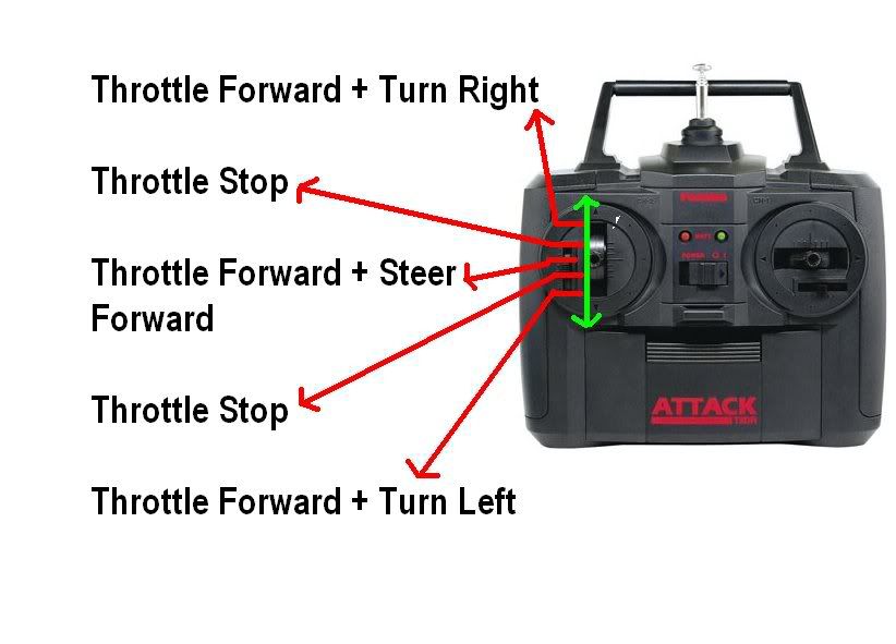

If converting a cheap RTR boat like or
Reduce Costs by:
1. Homemade Mechanical Speed Control
2. Use stock servo
Their rudder servo turns like this:
Left: +5 Volts
Forward: Zero Volts (a spring pulls rudder back on power off)
Right: Negative -5 Volts (reversed polarity)
Now all you need is a servo that does above and acts as a mechanical speed control at same time.
This is all you need to convert a boat. No expensive speed control or $10 servo. No fiddling with servo mount or linkage. Using stock is simple and cheap.
Read:
Throttle Forward + Turn Right
Throttle Stop
Throttle Forward + Steer Forward
Throttle Stop
Throttle Forward + Turn Left
This seems to totally miss the point of converting - that is to get fully proportional control of speed and direction while being able to use it at the same time as somebody else in the same general band.
Mechanical speed controls need a servo to work them, add the cost of that servo and the ESC suddenly becomes an attractive proposition.
Cant see it.
The boat will go forward one speed, stop, reverse one speed.
Whats been achieved.
Mine running on a 6v battery absolutely flies at full speed.
Who wants a tug that leaves a rooster tail from the word go.
Anyway the rudder mechanism is out of the ark. :-\
Dear Malcolmfrary,
Point is to take one servo + 100% homemade materials and make into one mechanical unit that 1) controls the stock rudder servo AND 2) switches between Forward/Stop throttle. This means you save money on an ESC and use stock rudder set up. You still need a servo for my mechanical mechanism.
Cant see it.
Dear DickyD,
The boat will go Forward one speed, Left and Right while going forward, and Stop. NO reverse.
You put a volume knob resistor in between battery and motor and adjust voltage to scale speed. You just take any volume knob from a cd player, vhs player, stereo, etc and use it. That's something you probably have at home or can find on outside on trash day.
Re: Seaport Tug Conversion (Boston, MA)
« Reply #10 on: September 25, 2008, 09:50:21 am »
Dear DickyD,
No reverse either, so where is the improvement ?
Its not April fools day is it. :-\
« Reply #11 on: September 25, 2008, 10:51:10 am »
Sorry Weeds, but you do have quite a bit to learn about electricity, the parts that control it, and what happens when you exceed the power ratings.  A "volume knob resistor" has a totally inappropriate value of resistance for directly controlling a motor, and a totally inadequate power rating.  The model boating description would be "One time smoke generator".
No reverse.  Reverse on a boat is your brakes.  It is also how you back away from trouble.  If all that is wanted is the same, or less, control than that supplied by the original, you have a good plan.  Normally the idea of converting an RTR is to UPgrade the controls to be equivalent to a normal model.
Either very early, or very late.
