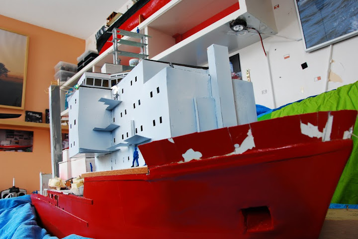

Update:
Due to a lack of time I failed to post some overall views from just after my last update, so here they are.
2 ships passing on the river.
Difference in size is pretty big...

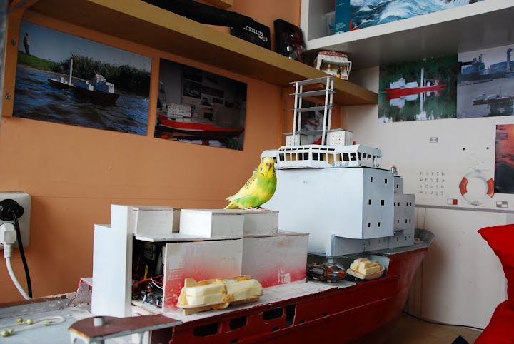

Update:
Took Tweety with me upstairs as prove that she is still alive.
As it is snowing outside there is quite some contrast in the photo.
Tweety seems to like being aboard Well Enhancer again.
"I'm the queen of cuteness, and I know it..."

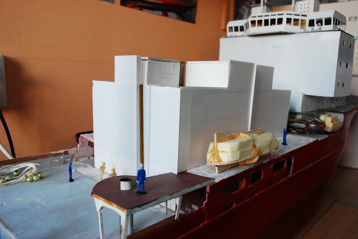

Starts to look more and more like the wheelhouse of a workship.
All hands busy, as it should be aboard a workship.
Here the sheer size of this model is displayed very well.

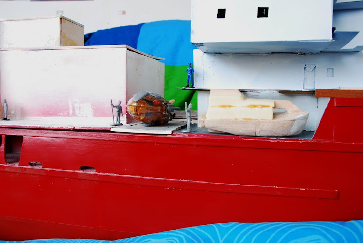

Platform at the rear deck wasn't standing horizontal, so I added a few plates to the bottom of the legs to make it stand horiznotal.
The other leg.
Dive-area has now been fully plated with plastic plates.
This side was much harder to reach, but I could had turned her around, though a model this size isn't easily turned around...
Some filling and sanding, and then she'll be good to go!
Greetings Josse

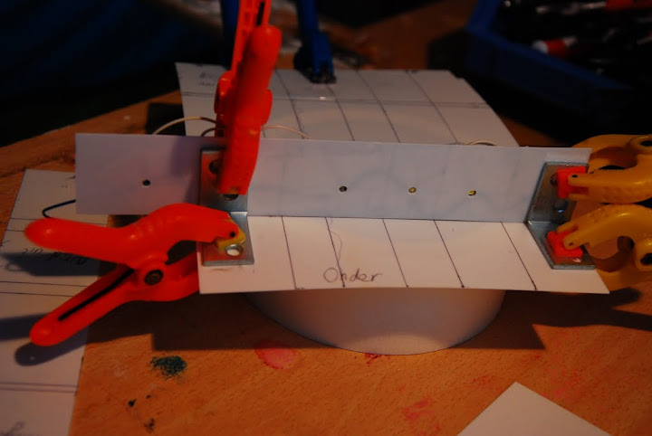

The rear part has been adjusted to make room for a wooden plate glued underneath the deck, which was added to keep the deck in shape.
Added the first floor and also the first wall to add some strength.
Here's some proof of the general arrangement not being accurate enough to build an escape hatch, as this hatch is clearly way too high...
Dry fit of the new deck.
Mechanic reports to the captain that no-one will be able to get inside through this escape hatch, as it is a bit too high.
Fortunately it's made left overs...
Now a quiz:
I did something wrong when I added the plastic plates to the dive-area, but what?
Greetings Josse

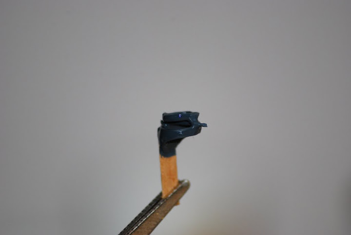

Also started making the first bearing repeaters which will be added to the panel in the wheelhouse which I made earlier.
The result wasn't what I hoped it to be, but the coin shows how small this thing is.

Build a new boat, so I wanted to have it properly visible, but as it's placed at the other side of the ship the only way to do that was to put her in the water.
As the ship is now at sea there's no need to wonder around with ropes, so the crewmembers that have the duty to work with the mooring ropes are now indoors reading a book or something, lazy sailors...
Now on to some attachments, and then the crane is ready for duty...
Not quite a small crane.
Painted the main mast.
Nice view over the still pretty empty rear deck.
And the painted mast.

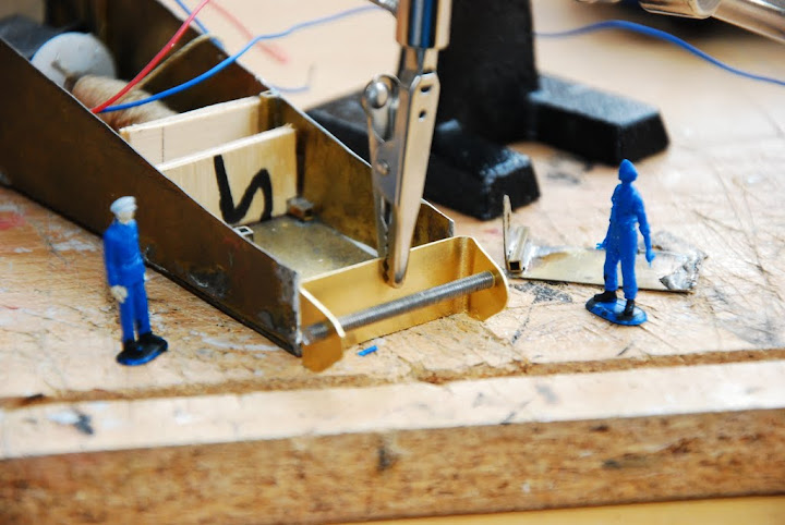

Spring put into the tube, ready for assembling the other parts.
In order to make the cylinder slide in and out I attached the outer tube to the guide-bar that guides the rope, and will in time act a first part of a reduction system for the rope to give the servo it's needed strength.
Lay-out of the inside of the crane house, without the winch.
The attachment bracket's have been trying to break free several times, so now I made a new 1 out of 1 piece so it would have much more soldering surface, making a stronger joint.
Attachment that will come atop of the crane house under construction.
Attached the bracket.

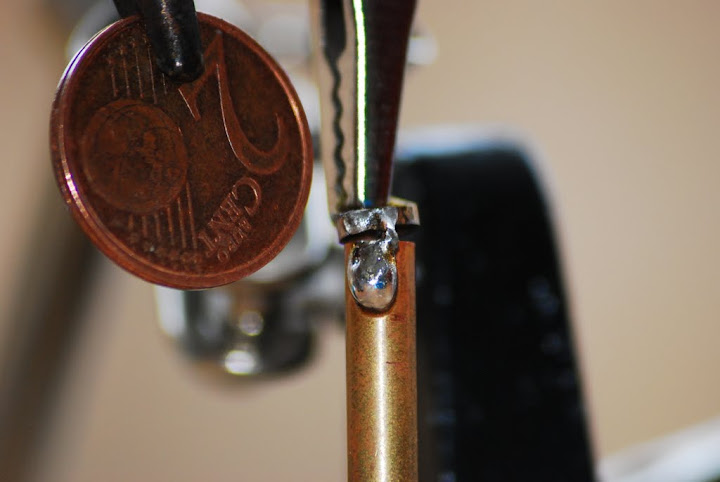

Folding the plate made it hard to properly solder the parts together.
Angle is too low now, but I will add a support that will make sure that the spring gets high enough to increase the highest angle.
An impression of what it will look like.
