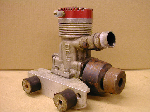

« on: June 14, 2009, 12:23:14 am »
Sometime in the early seventies I bought an OPS 60 WCRCB engine from HJ Nichols in London. For the time this was one chunky, extremely well made and outstanding engine with a performance to match. A significant improvement over the Merco 61 then in use!
Unfortunately I lost the pipe overboard due to minimalist fixing and with my work taking me overseas shortly after, to my eternal regret, I sold the engine and boat on.
Fast track some thirty odd years and as mentioned on the ‘1/8 scale Huntsman’ thread another version of this engine came my way and is currently fitted to a secondary project of which perhaps more later. This version has an air-cooled head (came with a ‘Kool Klamp’ fitted). When received it was in a bit of a sorry state so it was stripped down, cleaned and rebuilt. Stripping revealed a bent con-rod and though it was difficult to remove this as per normal methods, no further damage occured and remarkably very little wear was evident. After straightening the rod however, the engine assembled well and is now in fine, though as yet un-run, order.
Recently I purchased ‘unseen’ another example. I bought it, well aware that it was ‘seized’ following a dunking in salt water but thought it might be useful for spares. It’s condition when it arrived a couple of days ago matched expectation but upon careful examination it looked as if this too could be rebuilt.
I thought it might be of interest to see what transpires.
Looking at it, one ‘positive’ is that it had seized with the piston well up in the bore so theoretically the top end of the liner may possibly be unscathed but first those screws  would have to come out. As expected, not many would but the exhaust came off easily enough - good start - followed by the back plate but nothing else would so much as shift so it’s into a container of Plus Gas to leave for a good soak for a day or so. (I never realised until quite recently that this penetrating fluid was still available)
Hopefully the fluid and maybe a bit of heat in the right areas may just get to grips with the rest.
Hoping this may prove of interest to someone

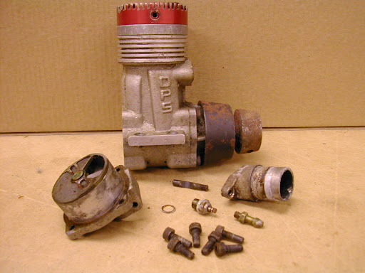

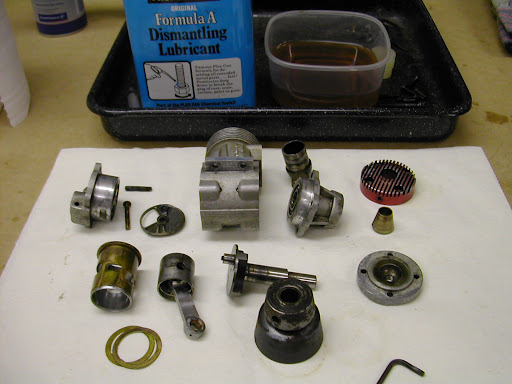

Interesting memories Bogs, I don’t recall problems with the carb on the 60 but then it wasn’t raced, well that is, pushed to the limit, and it was always hand started with a cord!! I think I also ran it on straight mix i.e. no nitro which if memory serves correct was how the OPS of the time was set up. Ah! too long ago to think about eh? ok2
That ‘thin’ pipe I do remember and seeing it disappear – for the second time – (didn’t learn much there the first time) was a gut wrencher. The first was very close to the bank and was retrieved but no such luck the next time. One thing’s for sure they will be held much more secure this time round!! %)
Well despite it’s appearance and condition and after a few anxious, ‘nipped up’ moments I’m pleased to say that the engine is now stripped to it’s major parts.
Three of the head bolts lived up to expectation, the first undoing with that ‘crack’ of a well torqued caphead. The force required on the others was immense but the normal worry that the socket would open or the key would ring was not founded. It was only after I picked up the hex key to take off the front housing that I noticed the inbuilt corkscrew!!  :D :D (Sorry just couldn't resist these!!)
With the head off, the next concern -  the flywheel – proved unfounded. It fell off with a single tap with a plastic faced hammer. The real sting in the tail though was the liner - an absolute sod but lots of heat, some ice cold water poured in the liner at the moment of truth courtesy of SWMBO and out she popped unscathed.
The piston was extremely tight in the top half of the liner (interference fit 10mm from the top!!) and it turns out this was due to a virtually invisible ‘salt(?)induced glaze’, the bottom half of the piston some 2 thou bigger than the top half. Thoughts of how to true the piston diminished after dunking the piston in cellulose thinner revealed the glass hard glaze as a white deposit. A very careful scraping with a scalpel showed the deposit had broken down in the thinners and it just flaked off. A very light touch with a piece of 1200 wet and dry with lots of lube and the piston dropped back in the liner running smooth and just nipping at the top as it should. So far so good.
The main bearing had totally seized and the crankshaft shows sign of running in the bearing. The bearings were much easier to remove than expected and some replacements are on order at a local supplier.
Since this pic the gudgeon pin has been removed as the con-rod needs rebushing at the bottom end, the little end showing no sign of wear.
Does anyone know of a source of the circular wire retaining clips that retain the pin or are these specific to OPS engines.?
Well that’s it, stage one over much more quickly than anticipated. The rebuild will be much more sedate as I would like to bring it back to as new a looking condition as possible – I’m promised the use of a bead blaster to clean up the castings but that won’t be until next week.

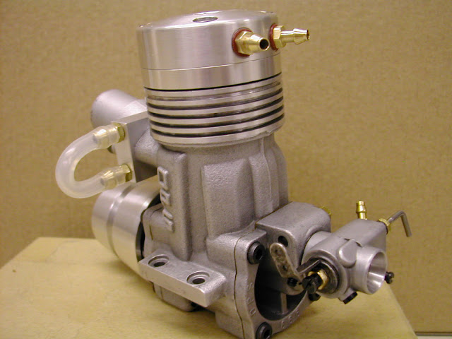

Re: OPS 60 engine
« Reply #4 on: June 17, 2009, 05:00:55 pm »
Hi Ramon,
I am pretty certain that's not a OPS .60. It appears to me, to be either a .67 or a .80.
The good news is they still make both (unlike the .60s) - although they fairly recently stopped making the disk rotor / bushed rod versions.
All of the "current" .67 and .80 engines have steel / needle roller rods, and drum valve induction.
Visually, it is hard to tell the difference between the .67 and the .80. I think they both have 23mm stroke. The .67 has ~24.6mm bore. The .80 has 27mm bore.
It would also seem that the "new" "bimetal" OPS .90 is a development of this same engine. Same crankcase, but anodised black, and featuring the same 23mm stroke. Advances in the last 20+ years, seem to include (but are not necessarily limited to): Fancy anodising of crankcase, flywheel, and head. Billet front bearing housing and drum rotor housing (a genuine improvement - though Aeromarine used to offer similar aftermarket parts). Ability to overbore the liner again (.65 -> .67 -> .80 -> .90). Some balancing and porting work.
Mantua Model are the UK distributor for OPS engines, and may be able to help with parts. Clips for a Picco .67 should fit if you can get them. I think CMB .67 wrist pin size is either the same, or very close, so CMB .67 circlips would probably work ok (and should be easiest to get).
Some info on the new OPS .90 is here: http://ne-stuff.blogspot.com/2009/03/new-ops-90.html
Ian
andyn
Re: OPS 60 engine
« Reply #5 on: June 17, 2009, 05:19:16 pm »
Ian is right, this is the OPS .67
It is drum valved, but does have a double bushed con rod. Note the new milled backplate.

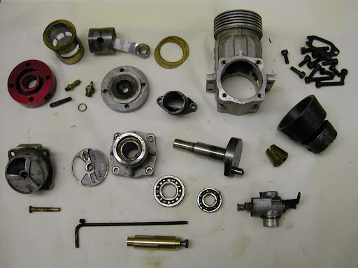

Ramon
Re: OPS 60 engine
« Reply #18 on: August 21, 2009, 11:17:04 pm »
Hi there again
Well at last it's back together and hopefully ready to run %).
When I first took this out of it's package my initial thoughts were that it was beyond all hope {:-{. However I really am surprised at the outcome but obviously extremely pleased.
Having said that it didn't actually take a vast amount of work though the 'set ups' needed care.
When the new bearings arrived they just 'fell' in so the housings were bored oversize, sleeved and rebored. This and the big end which had to be bored out and rebushed was the only essential machining, the other - a new 'button' and the watercooled head were done purely for aesthetic reasons. The internal water way is split ie in one side - runs around the front - out again the other. It was decided not to cut the fins (at this stage) - if it proves neccesary the finning can be done at a later date.
The carb is from a Super Tigre 60 the intake bored to 9.5 dia (about the max that could be safely removed) and a couple of extra grub screws put in the housing to hopefully offset any tendancy to shake loose. If anyone has an original carb and could measure the bore diameter it would be nice to know what it should be.
Compression wise - well despite the scraping off of the salt deposits it seems 'reasonable' - not totally brilliant but certainly better than had been expected and those wire spring clips? £1.38 for two at Mantua models - OPS agents! well where else?  :embarrassed:
Anyway - a few pics -
Parts ready for re-assembly - yes it will get a new shiny glo plug
Backplate lapped - those 'micro scratches' came off the first fitting of the disc -aaagh!
Ready to run?
What's it going in? well at this stage it's destined to go in the hydro once that is up and running and basically trimmed but that's a while off yet.
My thanks to all who responded to this post. I would just like to say that I'm not unaware that for many to do similar may be impossible due to lack of kit or knowledge of machining. In all probability this may be of minimal interest however I hope it will be of use or interest to some one - the information, knowledge and online friendship it has garnered for me has been truly enlightening.
Regards to you all - Ramon.

The bearing housings were a weak point in all the old OPS engines. Some (probably RPM) used to make aftermarket bearing housings from billet. I think OPS themselves use billet now.
Is the fit of the middle section of the crankshaft in the housing ok ?
Ian
Ramon
Re: OPS 60 engine
« Reply #22 on: August 24, 2009, 10:34:13 pm »
Hi Ian, thanks again. looks like the 9.5mm will be a good starting point. Don't know how the ST carb will perform but they used to do quite well on STG21/46s Can only wait and see.
Interesting to hear the fact that the front bearing housing did not live up to expectation enough to warrant someone producing an aftermarket part.
On this one the mid section appeared 'half' ok - the main bearing end was a good running fit on the shaft and not affected by the immersion - I guess due to a good layer of castor. At slightly less than half the length the outer part toward the front bearing was slightly larger and though somewhat corroded 'appeared' unmachined.  I used the good part to mount the housing on a mandrel then bored the front bearing recess and trued up this corroded bit to the recess with a very light cut. This was mounted on another mandrel to bore the main housing. It all aligned okay without binding and I would imagine the length of the running fit more than long enough to maintain crankcase pressure. Failing that it looks like a new front housing could be on the cards.
Regards for now - Ramon
