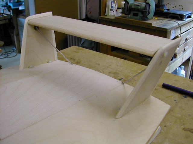

Fins and wing are now complete and fitted.  The fins were built up using 1/32 ply skins over a bass wood frame then edged with reasonably hard balsa.
Getting the holes through for the wing pivot posed a problem but some jury rigging ended up solving the problem
I've just realised haven't took any pics of the finished assembly so perhaps a couple more later.

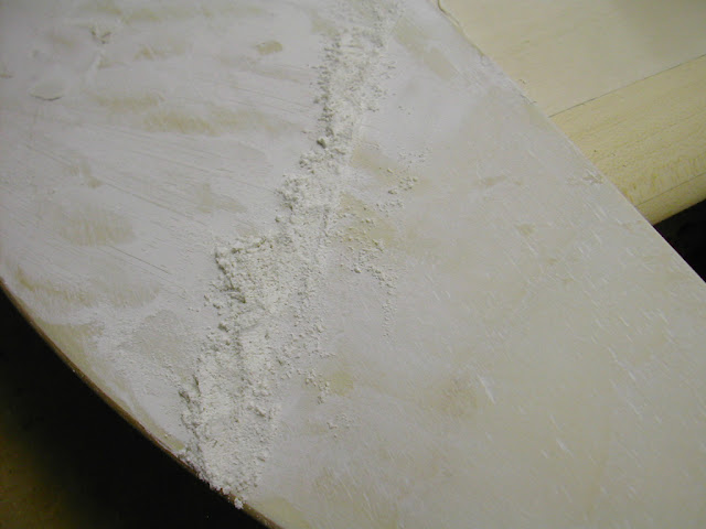

Had another think about those bad 'plucks' in the top skin. Tried a bit of P38 but this goes off so fast only very small amounts can be mixed - yes minimal hardener is being used. Anyway thought I might try 'Poly Filla'. Mixed some up with PVA glue and water and scraped it in. Seems to have worked, though the surface needs a light coat of sealer as soon as the excess has been sanded. I used very thin sanding sealer which should still allow the epoxy to penetrate. The nice thing was the ease of sanding.

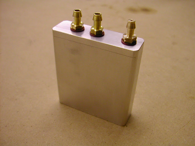

Following on from float chambers I'm afraid I don't have room for a float chamber - definitely don't - (unless I kick the radio out that is which means too much pulling about at this stage. Of course if there isn't enough capacity for a reasonable run that may have to happen at a later date!) I have bought a couple off ebay so now have a good idea what they look like and how they function but there's ''no room at the inn' on this build at present.
that, unlike the float chamber, it will mean the fuel is under pressure 'at the venturi' but it should act as a kind of 'compensator' and keep the head of fuel fairly consistent. I'm thinking that by venting it when filling then closing the vent it will continue to fill as the fuel is drawn off. The slight vacuum in the head of the tank may help keep the head of fuel above the level of the fill pipe and if it works as I think it might then when the engine is throttled back and the pressure reduced then it may act with a semi uniflow action. Another suck it and see event - any opinions?
Forgive the sketch - done in best pre CAD fashion I'm afraid!
Feed in from the tank on the left, fuel pick up in centre, vent on the right. The cup is the sump (to be glued in with JB Weld).
Ready to fit
I have also made a similar but much small chamber to act as a back pressure overflow from the exhaust to fit 'tween exhaust pressure outlet and vent on first tank.
Couple of pics of the wing and fins.
The whole unit is held on with 4mm nylon bolts in aid of 'breakoffability' (bet Windows hasn't got that one!). The wing pivots on them too - just need to work out a method of adjusting the wing incidence that will hold it rigidly but can break apart as well. The struts are made from 2.5 ally welding rod, the ends squashed in a vice and drilled. I don't expect these to survive a tumble but they are man enough to keep the whole thing rigid.
