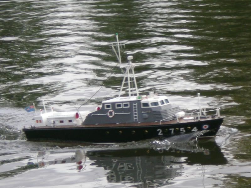

« Reply #35 on: September 15, 2009, 05:43:59 pm »
Thanks for that Mark.

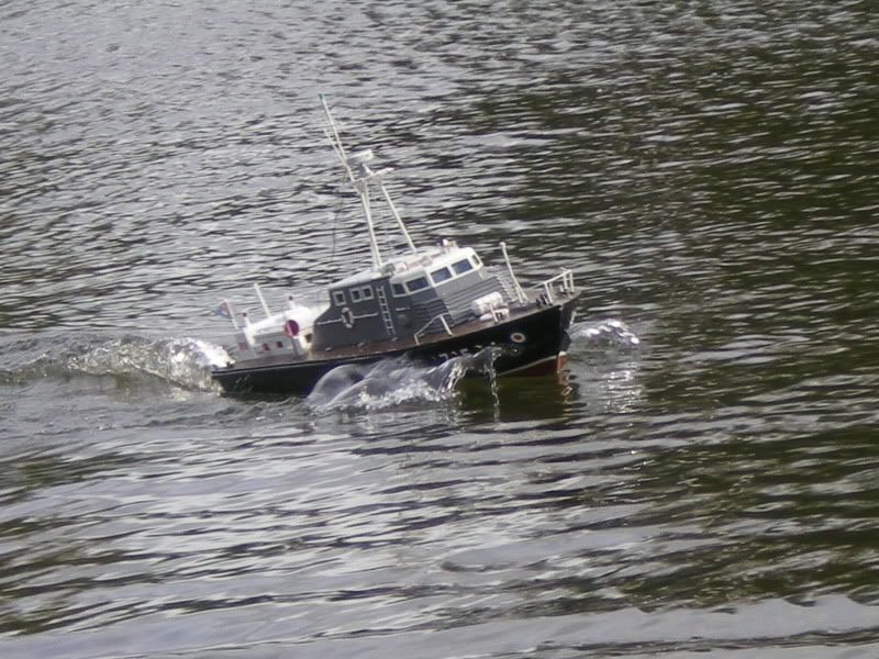

 I re-set the chines at the bow,and added a piece of right angled brass on the leading edge of the bow,to help cut her way through the water at low speeds. I'm just back from the park,(but I forgot to take my camera with me),after testing out the mods. What a difference it's made,getting the chines angled properly,they really do throw the water well clear of the hull. The brass strip has made a difference too, allowing the boat to carve through the water,rather that building up a large bow wave. I had to change my steering servo though,as my Kyosho KT-14 transmitter wouldn't control the existing steering servo. I've now got an ACE 1015 servo on steering duty,(far more torque than is needed),but I need to be careful not to turn too tightly with it,because it has a very fast transit time. I've changed the prop to a 40mm 2-blade one,and with the GP 4300MAh packs,I'm getting almost 45 minutes run time from the one pack. Not much in the way of deck furniture to add now,just the large airvents and a dinghy now,and the cockpit to finish off. Some pics.
Please excuse the Araldite everywhere,but once the hull's been repainted,it won't be so obvious.

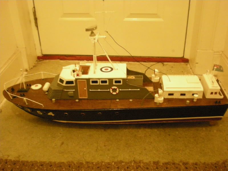

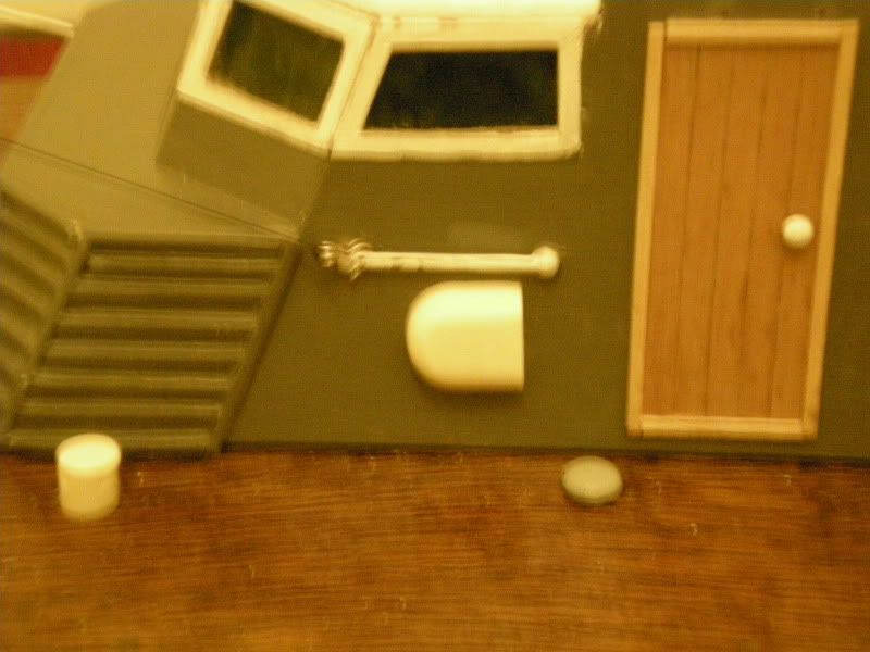

« Reply #43 on: September 26, 2009, 10:48:52 am »

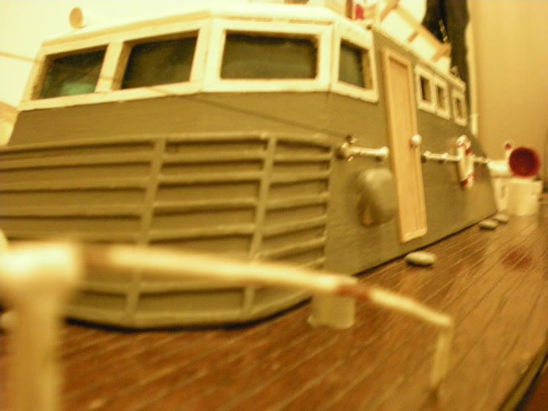

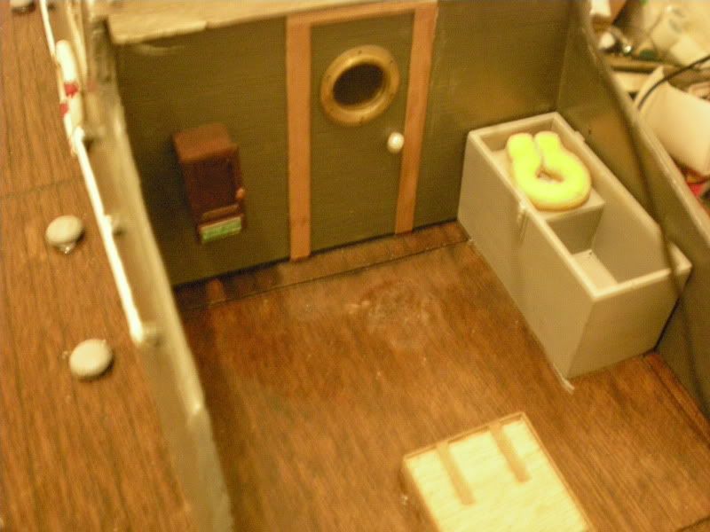

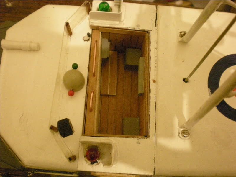

Got my Macsmodels castings through today,and all I can say,is that they're superb.I'm going to have to reinforce the boat davits though,as I think that they could easily snap during transportation.I think that i may need to sandwich the core between two plates of brass,as their position on the hull is very exposed.,and I don't want them damaged.
 Some pics of the new parts in position,(only temporary,as I still have to paint them).
Sorry for the shaky hands syndrome there.
I'm just waiting for the parts from G.Turner now,and she's more or less complete.I've still to build the companionway hatch though, before anyone says anything.

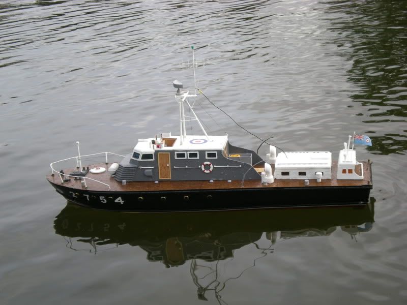

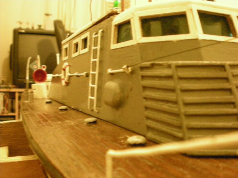

« Reply #44 on: September 27, 2009, 11:57:59 pm »

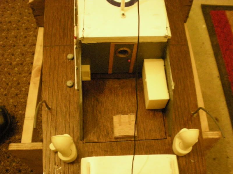

How it's looking now.
Still to fill and smooth off the engineroom front face,but I've run out of filler.
Dreadstar
Re: Dread's Vosper RTTL
« Reply #45 on: September 28, 2009, 10:08:55 am »

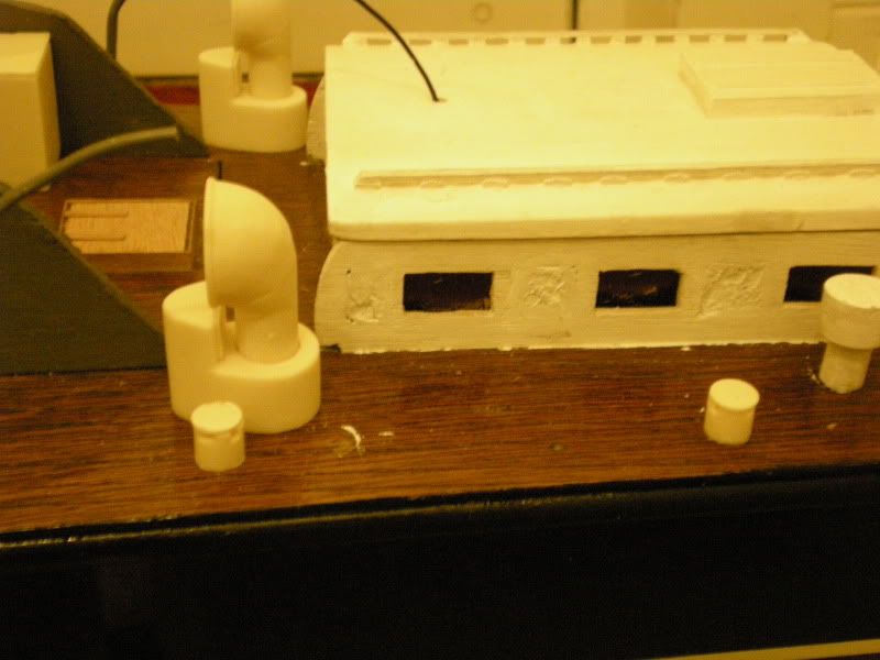

Better view.
